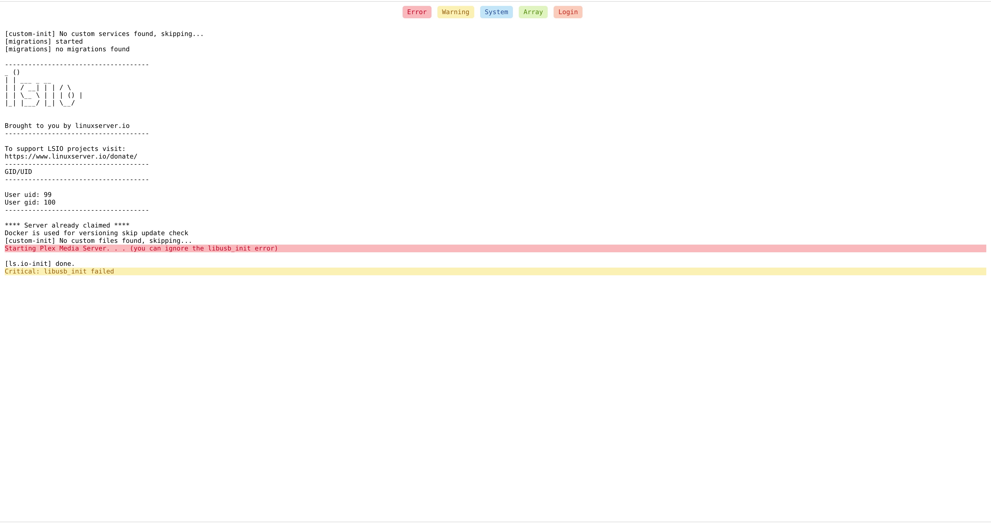

My PlexMediaServer seems to have developed a fault.
I haven't used it for about 5 months and I am getting the attached message whenever I try to open my media on it.  I am running v6.9.2 of UnRaid.  Any ideas?
Thanks
Thanks
It literally says in the log just below it that you don't have to worry about the error given. 🤣

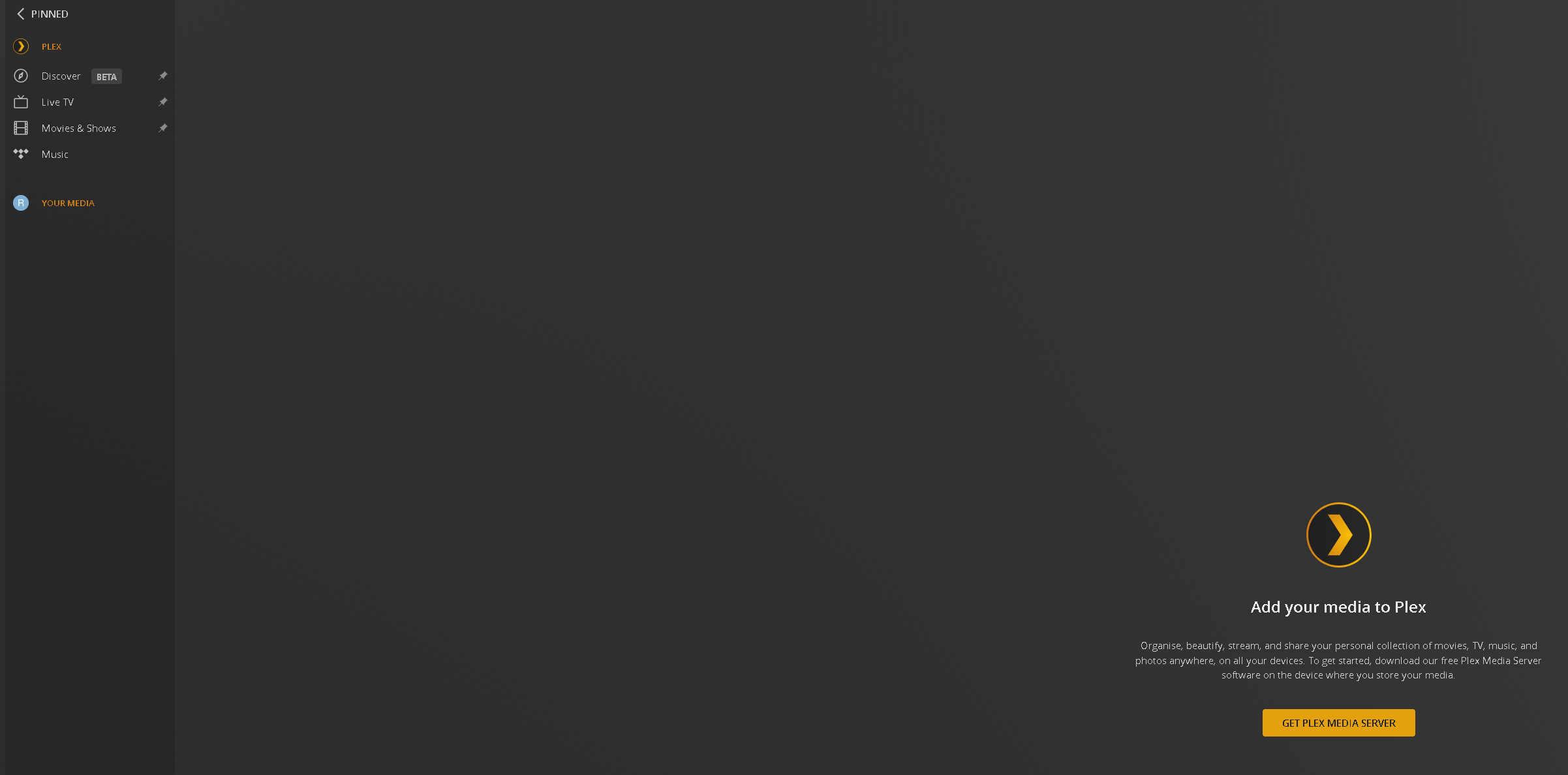

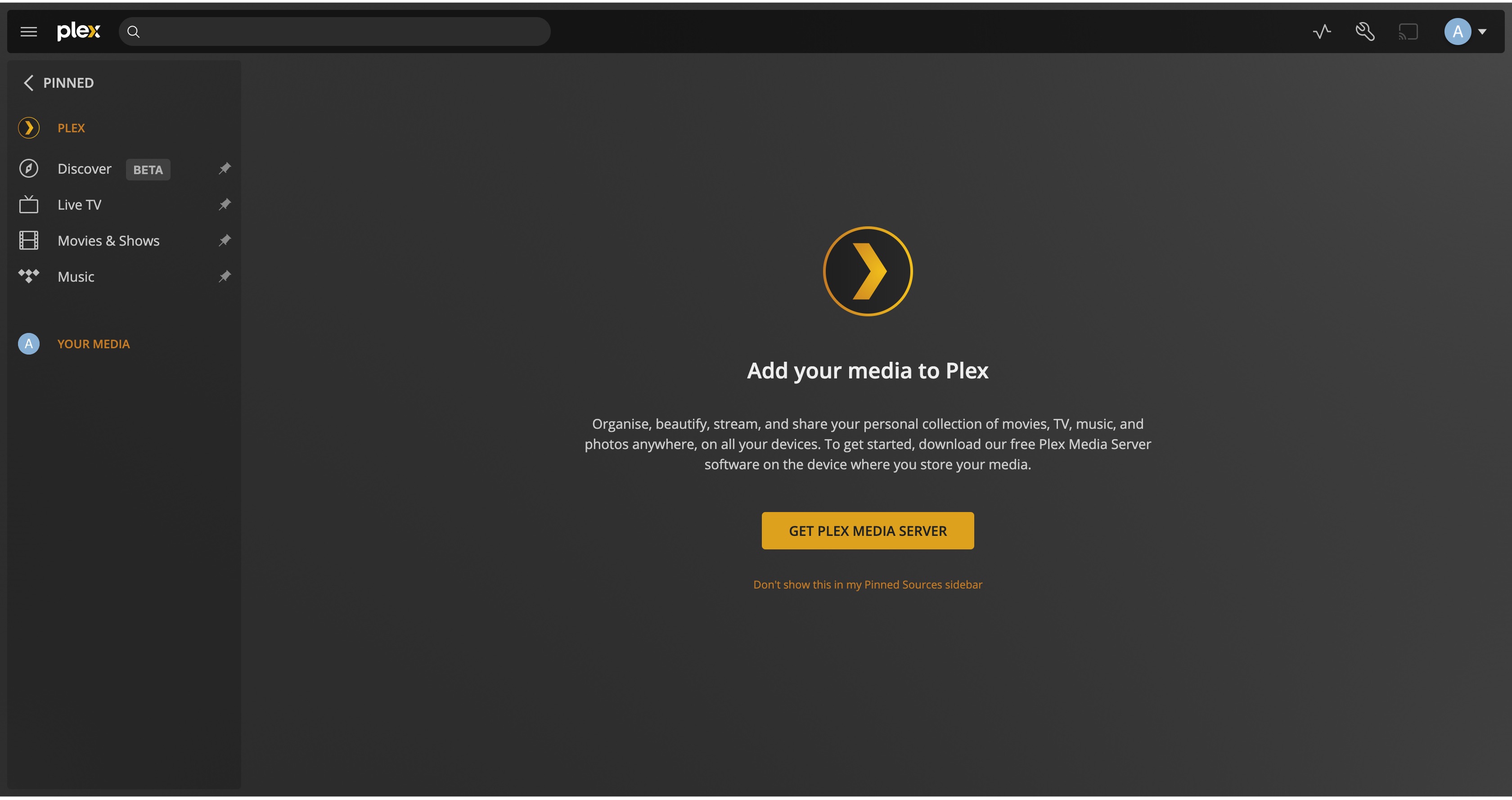

PROBLEM!!!
My main user admin account is unable to access my media,  my users can but my main admin account cant.

Thanks for your help on this.  It appeared to be the PLEX_CLAIM change which had tripped me up plus something(s) else.  Despite being fully updated it simply wouldn’t work, so I deleted all but the appdata, including the template and started again.  Now it works fine.
EDITED
Ok i had multiple issues sorting this, most relating to firewall rules causing confusion.  I also went on a circle edditing prefrences.xml, which i had to use krusader to change permissions so i could edit in windows.  I dont think this was needed so just use the below instructions.
Log into Plex.tv. Then go to https://www.plex.tv/claim/. You get a code that is valid for 4 minutes, if you need more time than 4 minutes, just reload the page and use the new code. Leave this window open.
Enter the following within unraid terminal (click icon on the main page)
curl -X POST 'http://127.0.0.1:32400/myplex/claim?token=CLAIM_CODE_HERE'

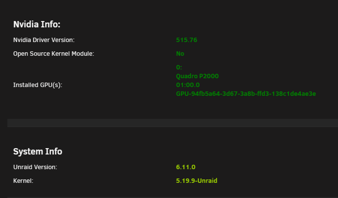

reverted to <tryin to find latest working rls>, "latest" version again does not transcode...
edit: coulnt find a plex version working, maybe nvidia update? I also updated unraid (rebooted), but unraid didnt changed anything too obv about transcode...
its crazy i dont know what the problem is
i had working
Now the only combo working i found is
Unraid 6.11.5
Plex 1.27.1.5891-c29537f86
Nvidia 515.76
anyone any idea?
Only thing changed is unraid? Am i the only one with problems?
