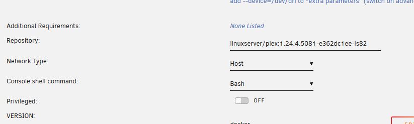

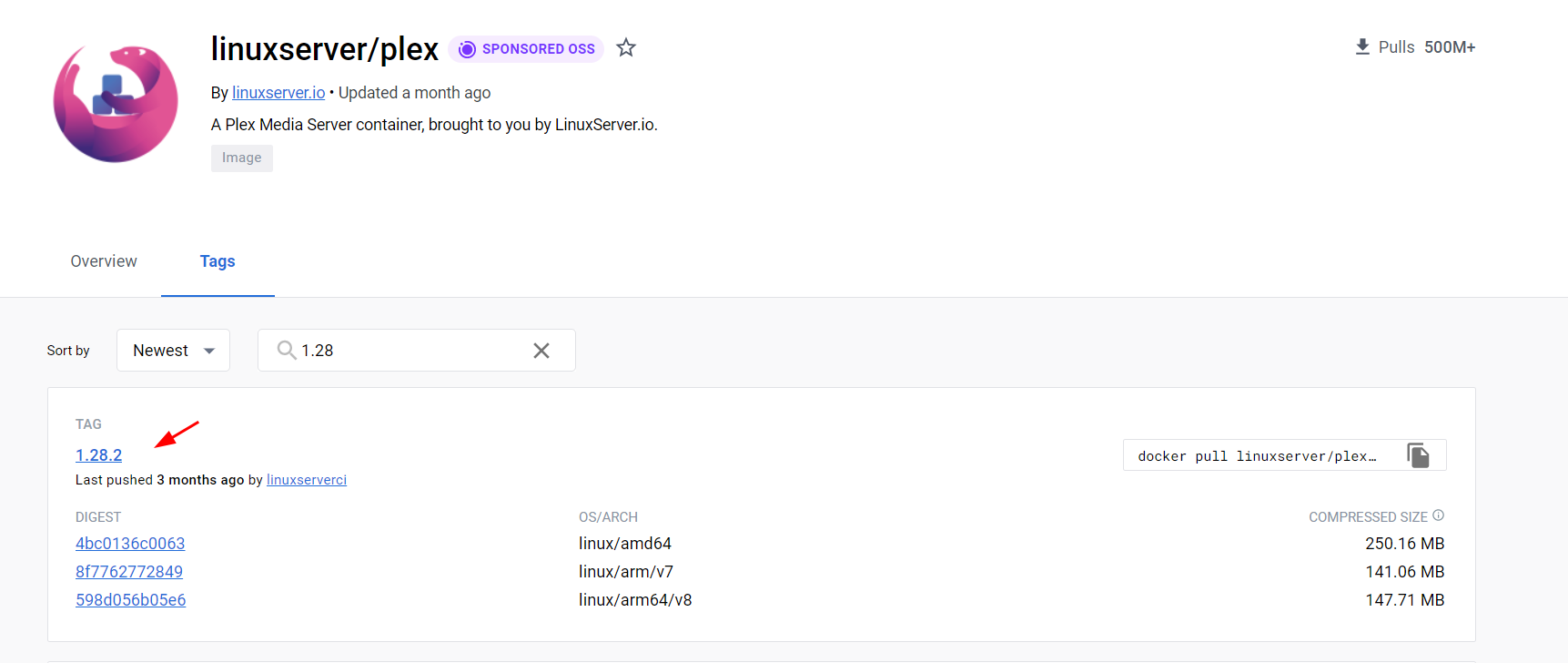

alturismo Posted January 8 Share Posted January 8 1 hour ago, chip said: How can I roll back to a different version since Version 1.30.0.6486 seems to have issues with TrueHD audio. like mentioned many times here too already, look for the tag which you want https://hub.docker.com/r/linuxserver/plex/tags change the repo in your docker conf linuxserver/plex:1.28.2 i choose now the lsio tvheadend docker as i use plexinc plex docker 1 hour ago, chip said: Quick reads say that would have brought you here to the solution too how to choose a specific version Quote Link to comment

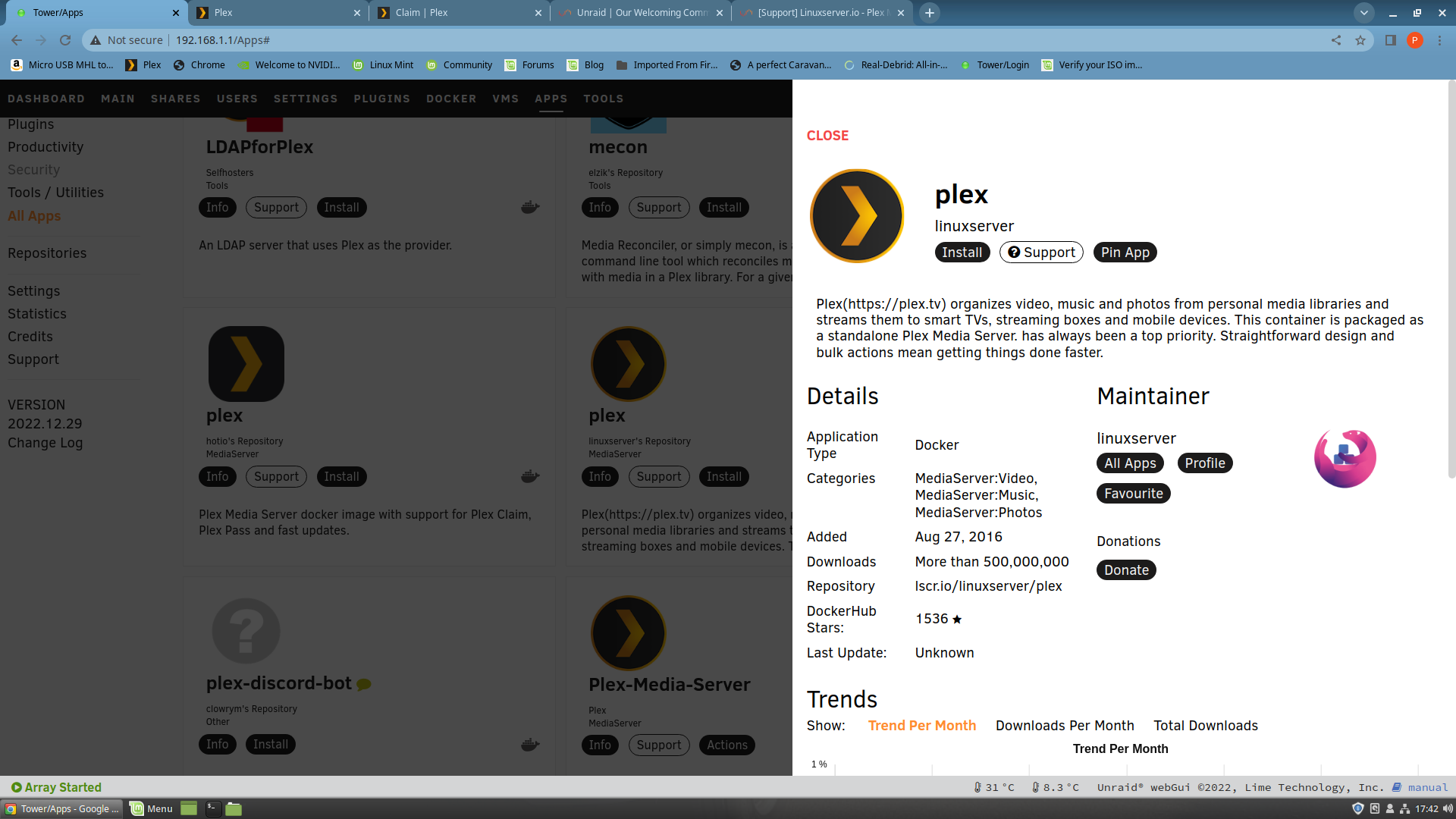

Phil Ash Posted January 9 Share Posted January 9 On 1/1/2023 at 8:00 PM, Greygoose said: EDITED Ok i had multiple issues sorting this, most relating to firewall rules causing confusion. I also went on a circle edditing prefrences.xml, which i had to use krusader to change permissions so i could edit in windows. I dont think this was needed so just use the below instructions. --------------------------------------------- Log into Plex.tv. Then go to https://www.plex.tv/claim/. You get a code that is valid for 4 minutes, if you need more time than 4 minutes, just reload the page and use the new code. Leave this window open. Enter the following within unraid terminal (click icon on the main page) curl -X POST 'http://127.0.0.1:32400/myplex/claim?token=CLAIM_CODE_HERE' If your Claim Code is claim-TxXXA3SYXX55XcXXjQt6, you enter the following in terminal/command prompt: curl -X POST 'http://127.0.0.1:32400/myplex/claim?token=claim-TxXXA3SYXX55XcXXjQt6' Wait a little bit after entering, after 10 seconds or so you will see stuff appear on your screen. That's it, after this step you should see your Server visible again in Plex (just open it as you usually would, or via https://app.plex.tv/). Link to source ------------------------------------------- Use terminal within unraid (little icon main page). 5minute fix at most First question I have installed plex using the apps tab in Unraid. Got the claim code from plex and it seems to all be fine as this is how it shows up on the docker Plex-Media-Server started up-to-datehost192.168.1.1:1900/UDP192.168.1.1:1900 192.168.1.1:32400/TCP192.168.1.1:32400 192.168.1.1:32410/UDP192.168.1.1:32410 192.168.1.1:32412/UDP192.168.1.1:32412 192.168.1.1:32413/UDP192.168.1.1:32413 192.168.1.1:32414/UDP192.168.1.1:32414 192.168.1.1:32469/TCP192.168.1.1:32469 192.168.1.1:8324/TCP192.168.1.1:8324/tower.local/mnt/user/appdata/Plex-Media-Server/transcode/ /mnt/disk1/sambashare/movies//mnt/disk1/sambashare/Movies/ /config/mnt/user/appdata/Plex-Media-ServerONUptime: 9 seconds (healthy) Created: 11 seconds ago However, when I open plex using the WEBUI I get my norml user choice screen but when I log in as me I somehow get Shield Android TV as my server. This has an error as it is unavailable. I was under the impression that when I set up the plex media server using the official docker from Unraid apps pointing the paths to where the files are stored and claim my server with the code from plex it should work? I cannot find where to enable SSH. Where is that control panel mentioned in the instructions above? When I use the commands in the linux mint cinnamon terminal (my system runs on linux mint cinnamon) it isn't a valid command. Unfortunately I am an absolute beginner and have not even the basic knowledge so will need basic dummie step by step instructions to get my plex on unraid working. All help will be much appreciated. Thanks in advance Quote Link to comment
trurl Posted January 9 Share Posted January 9 37 minutes ago, Phil Ash said: official docker from Unraid There is no official docker from unraid. There are more than one plex dockers on the Apps page, including the official plex docker from plex. This is not the support thread for that official plex docker Quote Link to comment
wgstarks Posted January 9 Share Posted January 9 1 hour ago, Phil Ash said: the official docker If you click the docker icon “Support” should be one of the options. This will take you to the proper support thread for whichever Plex docker you have installed. Quote Link to comment

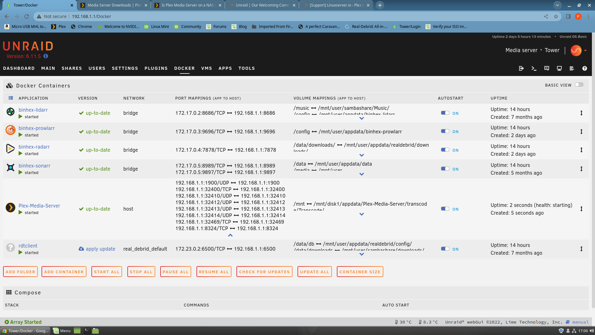

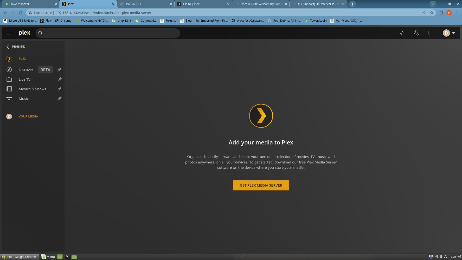

Phil Ash Posted January 10 Share Posted January 10 (edited) 21 hours ago, wgstarks said: If you click the docker icon “Support” should be one of the options. This will take you to the proper support thread for whichever Plex docker you have installed. Unfortunately there is nothing in that plex support forum that gets me beyond the problem. I now managed to get it running but instead of recognising that I have the Plex-Media Server installed on Unraid when I open the Web ui now the plex app asks for me to bwe able to add my media I need to download a plex media server. Which I obviously have just done and successfully set up according to the message I got after finishing the install. Edited January 10 by Phil Ash added screenshot Unraid docker Quote Link to comment
wgstarks Posted January 10 Share Posted January 10 35 minutes ago, Phil Ash said: Unfortunately there is nothing in that plex support forum Yeah. I don’t think the official docker is well supported. My recommendation would be to install the linuxserver.io version that is supported in this thread. It’ll mean starting from scratch probably but the support is better. Quote Link to comment
Phil Ash Posted January 10 Share Posted January 10 5 minutes ago, wgstarks said: Yeah. I don’t think the official docker is well supported. My recommendation would be to install the linuxserver.io version that is supported in this thread. It’ll mean starting from scratch probably but the support is better. is that this one? Quote Link to comment
wgstarks Posted January 10 Share Posted January 10 2 minutes ago, Phil Ash said: is that this one? Yes Quote Link to comment

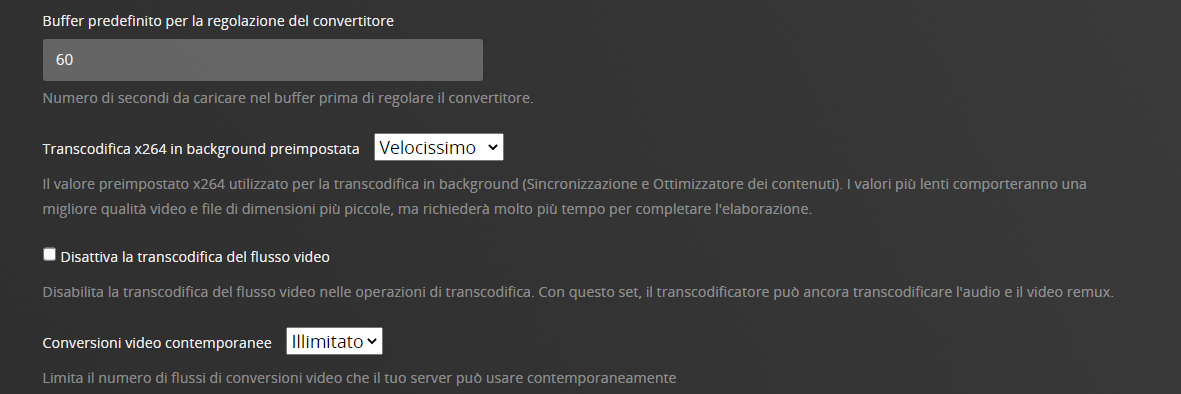

gregzee Posted January 12 Share Posted January 12 I want to put any transcode data in my tmp. I see that /config is pointed towards app data and saying it can get up to 50G or more for large collections.. Is this because of transcoding? How can I make sure that I point transcoding data over to /tmp/transcode or something? Quote Link to comment
alturismo Posted January 12 Share Posted January 12 2 hours ago, gregzee said: How can I make sure that I point transcoding data over to /tmp/transcode or something? may start reading here Quote Link to comment

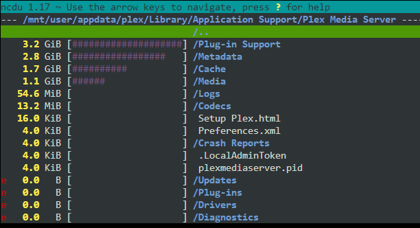

axipher Posted January 12 Share Posted January 12 10 hours ago, gregzee said: I want to put any transcode data in my tmp. I see that /config is pointed towards app data and saying it can get up to 50G or more for large collections.. Is this because of transcoding? How can I make sure that I point transcoding data over to /tmp/transcode or something? You definitely want your main Plex Appdata folder on an SSD for the best browsing experience. My current Plex library is using ~8 GB in its Appdata folder: - Movies: 2248 - TV Shows / Episodes: 444 / 12269 - Music Artists / Tracks: 31 / 1537 The Transcode directory should only have the current active streams and only for the amount of time you have set for transcode buffer, so unless you regularly have 20+ streams that your server is transcoding, you don't have to worry too much. I think mine with 4 streams once hit about 7 GB of usage, but that is purely me trying to remember something from years ago. With that said, and with Unraid supporting multiple pools now, I personally have my transcode directory mapped to an old Intel 660p SSD on it's own pool just called 'cache_temp' so that I'm not wastefully writing to my good redundant SSD cache pool. You could mount it to the linux temp file system at /dev/shm, but that is in your memory and if Plex does do something weird and doesn't delete previous transcode streams, then you eat your memory fast and cause other issues. The large Plex usage in my experience is mostly attributed to a few things: 1) Video Preview Thumbnails (Individual Library Advanced Settings > Advanced > Enable video preview thumbnails): This takes up a ton of space per video 2) Chapter thumbnails (Server Settings > Library > Generate chapter thumbnails): Takes up a good amount of space, less then video preview thumbnails, but still a good extra chunk 3) Lots of TV shows: Each episode gets meta data and with more scene changes, typically 3 or 4 episodes of TV will take up more space then a single movie 1 Quote Link to comment

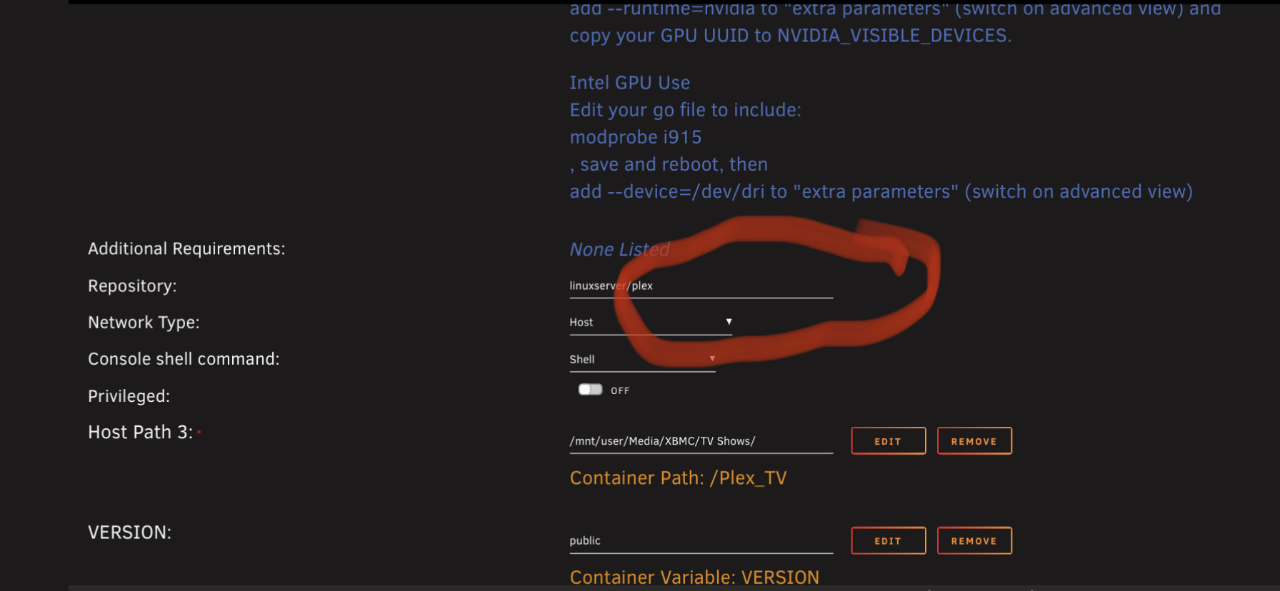

wgstarks Posted January 16 Share Posted January 16 15 minutes ago, Kreavan said: I've heard that reverting to the previous 1.30.0 version fixes the issue. Just not sure how to do that. In the fist post of this thread there is a link to the docker hub repo. That repo contains all the previous tag numbers. Find the one you want to use. In the unRAID docker tab click on the docker name and it will open the edit window. Type a colon and the tag number after the name in the repository field (no spaces). Click apply at the bottom of the page. Quote Link to comment

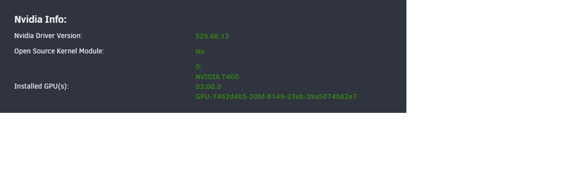

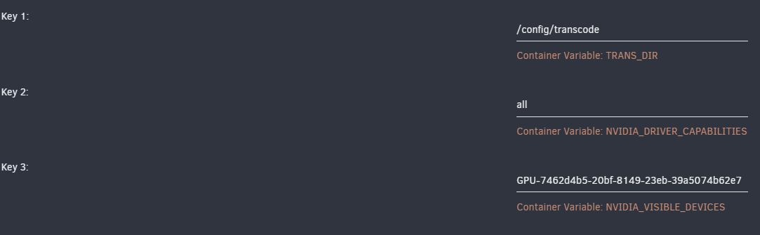

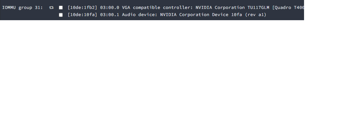

Lordbye Posted January 19 Share Posted January 19 Hi, i have a problem with plex. I followed also space invaders guide but i still have a problem My plex doesn't use hw acceleration System and nvdia driver (installed) report my quadro t400 gpu plex doesn't find it and use always cpu for trascoding How can i use my nvidia for trancode? thsnks Quote Link to comment
Lordbye Posted January 19 Share Posted January 19 2 hours ago, Lordbye said: Hi, i have a problem with plex. I followed also space invaders guide but i still have a problem My plex doesn't use hw acceleration System and nvdia driver (installed) report my quadro t400 gpu plex doesn't find it and use always cpu for trascoding How can i use my nvidia for trancode? thsnks ---------------------- 2 hours ago, Lordbye said: I probably found the problem, I don't have plex pass but only plex base and therefore it doesn't allow me the hw decoding. It's possible? Quote Link to comment
wgstarks Posted January 19 Share Posted January 19 17 minutes ago, Lordbye said: You must have plexpass for this. Quote Link to comment
Lordbye Posted January 20 Share Posted January 20 thanks for the confirmation..... are there any other "media server" that use nvidia gpu without any kind of pass? Quote Link to comment
