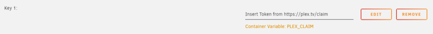

alturismo Posted March 16 Share Posted March 16 2 hours ago, alitech said: Is there a guide somewhere to configure this docker? once you decided which docker you want to take and then post in the proper thread, 1 hint ahead. you are adding nvidia ... but not a plex pass token, so in terms you want to use hardware accel transcoding a plex pass is mandatory ... nevermind which docker you are choosing now (and dont post the token here then) if you dont want to buy plex pass subscription, then remove at least this entry, also the nvidia runtime and GPU ID. and what i asked for would have come after hitting "done" in the buttom, there you see the docker run command and the error if its not working ... at least a error message, also on every docker ... 1/ choose which docker you want to choose, plexinc is the official one but then you are wrong here, move to the proper thread 2/ choose if you want hw acc transcoding, buy a licence ... or remove the entrys 3/ may start reading some basics about docker's to understand ... makes your life easier in terms other dockers shell follow 1 Quote Link to comment
alitech Posted March 16 Share Posted March 16 3 hours ago, alturismo said: once you decided which docker you want to take and then post in the proper thread, 1 hint ahead. you are adding nvidia ... but not a plex pass token, so in terms you want to use hardware accel transcoding a plex pass is mandatory ... nevermind which docker you are choosing now (and dont post the token here then) if you dont want to buy plex pass subscription, then remove at least this entry, also the nvidia runtime and GPU ID. and what i asked for would have come after hitting "done" in the buttom, there you see the docker run command and the error if its not working ... at least a error message, also on every docker ... 1/ choose which docker you want to choose, plexinc is the official one but then you are wrong here, move to the proper thread 2/ choose if you want hw acc transcoding, buy a licence ... or remove the entrys 3/ may start reading some basics about docker's to understand ... makes your life easier in terms other dockers shell follow Thanks for your reply. I can use the official one I have no issues with that. I guess I will remove this docker and start afresh. I do have a plex pass lifetime one so that is what I am using, I guess I didnt configure it to put the Key in the docker which I should have done, this may be been costing me a lot of CPU usage which I was not aware of. Quote Link to comment

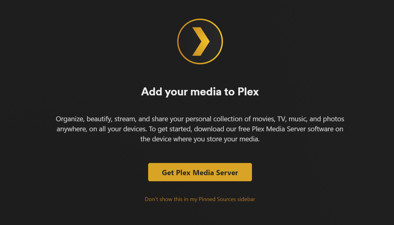

Hoopster Posted April 7 Share Posted April 7 (edited) Hmmm, updated the Plex container today and now my Plex server and local media library are gone. Settings menu is very limited and no way to add the server. All I see is the screen below when trying to add local media. Not sure I can restore from backup as Appdata backup has been giving me errors lately and I have not tracked down the cause. Any ideas how to get my server back so I can add local media libraries? UPDATE: Uninstalled Plex docker and reinstalled. Logged out and back in. Got a new claim token. Tried a specific docker version prior to most recent. Nothing. Still no server shows up at all. Fixed problems with appdata backup and restored a backup from 10 days ago. Problem persists. Edited April 7 by Hoopster Quote Link to comment
Hoopster Posted April 9 Share Posted April 9 Following a suggestion in the Plex forums, I changed the docker networking back to Host from the VLAN on which it had been running fine for years. That allowed the server to be claimed. When I then changed it back to the VLAN, everything seemed to still work except the direct remote access (yes, I changed the router port forwarding every time the Plex container IP address was changed.) For now, I have it back on Host until I can work through any issues that may be preventing the VLAN IP address from working. Other docker containers on that VLAN work just fine. Quote Link to comment

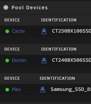

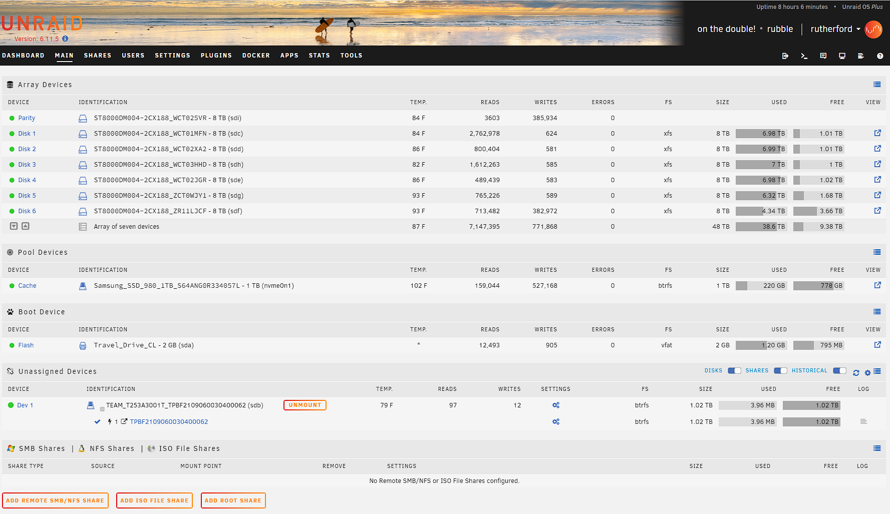

rutherford Posted April 9 Share Posted April 9 I'd like to split out my plex data folder to another hard drive. I added another SSD to the server, it's currently under Unassigned Devices. What's the best way to set this up? thanks! Plex docker > Settings Repository: lscr.io/linuxserver/plex Appdata: /mnt/user/appdata/plex appdata user share settings: Use cache pool: Only Select cache pool: Cache Quote Link to comment
wgstarks Posted April 9 Share Posted April 9 56 minutes ago, rutherford said: I'd like to split out my plex data folder to another hard drive. I added another SSD to the server, it's currently under Unassigned Devices. What's the best way to set this up? thanks! Plex docker > Settings Repository: lscr.io/linuxserver/plex Appdata: /mnt/user/appdata/plex appdata user share settings: Use cache pool: Only Select cache pool: Cache I haven’t tested this but if you copy the appdata folder to the new location preserving all attributes and change your docker’s appdata config to point to the new plex folder it should work. Test before you delete the old Plex appdata folder though. And you should be aware that if the SSD is connected via a USB 3 port that can sometimes be a problem (although hasn’t been for me). Quote Link to comment
rutherford Posted April 9 Share Posted April 9 7 minutes ago, wgstarks said: copy the appdata folder to the new location preserving all attributes and change your docker’s appdata config to point to the new plex folder it should work I was thinking this yes. In what manner should I add this extra cache drive to array (mark it as not included or something)? Or leave as unassigned device? Quote Link to comment
Cessquill Posted April 9 Share Posted April 9 2 hours ago, rutherford said: I was thinking this yes. In what manner should I add this extra cache drive to array (mark it as not included or something)? Or leave as unassigned device? I have mine set as a single disk cache pool Quote Link to comment
rutherford Posted April 9 Share Posted April 9 17 minutes ago, Cessquill said: I have mine set as a single disk cache pool What does that look like on the Main page? Is that a second disk cache drive? Quote Link to comment
Cessquill Posted April 9 Share Posted April 9 3 minutes ago, rutherford said: What does that look like on the Main page? Is that a second disk cache drive? Quote Link to comment
rutherford Posted April 9 Share Posted April 9 Interesting. Huh. I’ll try that out! Quote Link to comment
