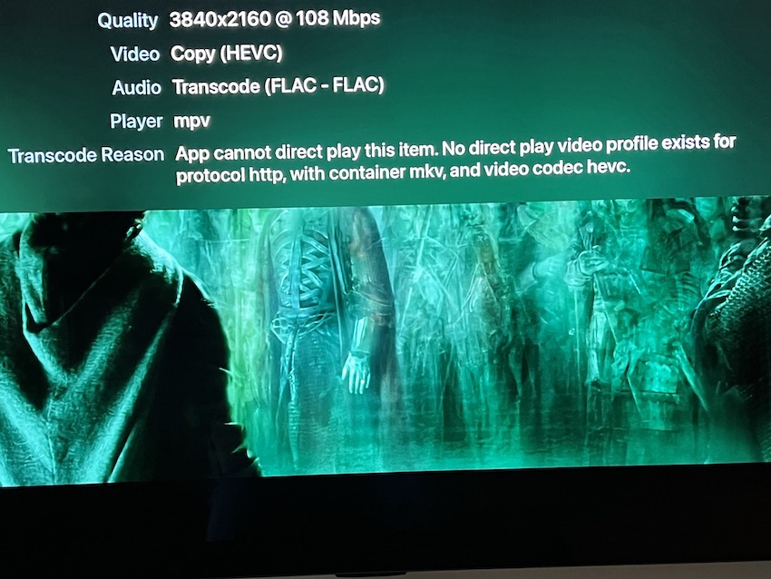

August 15, 20233 yr 5 hours ago, frodr said: Direct Play, about 80Mbps and above what is your client ? you know some clients have issues playing back high bitrate content ... sample, LG TV's native apps etc ... also usually claimed in the manuals from the clients, like 60mbits, 80mbits, ... 23 minutes ago, rader said: I just came home to the exact same issue as frodr on both of my plex media servers on two different unraid boxes. Was working great last night. Now niether plex dockers are working, yet all other dockers are fine. ok, so either you have the same issue (high bitrate content) or your dockers are not working anymore at all ?
August 15, 20233 yr 56 minutes ago, alturismo said: what is your client ? you know some clients have issues playing back high bitrate content ... sample, LG TV's native apps etc ... also usually claimed in the manuals from the clients, like 60mbits, 80mbits, ... ok, so either you have the same issue (high bitrate content) or your dockers are not working anymore at all ? Dockers aren't working anymore. Was investigating them both and saw that one was lscr.io and the other was linuxserver. Both were offline with slightly different messages. lscr.io was unable to connect. linuxserver had some errors related to a malformed xml file. Switching the network connection from custom to bridge at least brought back the linuxserver webpage, but it's not connecting to my "plexserver02" server name. It is connecting to the "On Plex" services. The lscr.io docker still hasn't been revived yet. The docker is running according to the unraid docker tab, but no webpage is accessible. I'm trying to force an update and see if that resolves the issue.
August 15, 20233 yr 3 hours ago, alturismo said: what is your client ? you know some clients have issues playing back high bitrate content ... sample, LG TV's native apps etc ... also usually claimed in the manuals from the clients, like 60mbits, 80mbits, ... ok, so either you have the same issue (high bitrate content) or your dockers are not working anymore at all ? Its Nvidia Shield Pro.
August 15, 20233 yr 18 minutes ago, frodr said: Its Nvidia Shield Pro. ok, that usually should be capable todo so but, i assume you already checked its "direct play" mode, so all the Plex Server does is pass the stream to the device .. which is then ~ 10 MB/s which aint really much so to test it out, may install kodion the shield just for testing purposes and play it there to see what happens, if its fine its more a plex client issue and you should forward to the plex forums.
August 15, 20233 yr 5 hours ago, alturismo said: ok, that usually should be capable todo so but, i assume you already checked its "direct play" mode, so all the Plex Server does is pass the stream to the device .. which is then ~ 10 MB/s which aint really much so to test it out, may install kodion the shield just for testing purposes and play it there to see what happens, if its fine its more a plex client issue and you should forward to the plex forums. It is Direct Play I´m referring to. Tried Shield Pro/Emby: Same trottling. Apple TV / Emby: Not able to connect to server. Apple TV (purchased 11/2022) / Plex: No trottling, but don't decode Atmos. Video is Direct Play, but it transcodes the audio. May that's the reason why I don't get Atmos sound. Why does it transcode audio? See reason in picture. Edited August 15, 20233 yr by frodr Added picture.
August 15, 20233 yr 3 hours ago, frodr said: Why does it transcode audio? prolly as your client doesnt support it natively ... but like i thought, videop is copy and high bandwith like you mentioned ... so this is all client related and you should activate logging (in your client) and use those logs fpr the plex forums. that would be the right way and prolly better as it doesnt look Server related at all.
August 15, 20233 yr 4 hours ago, alturismo said: prolly as your client doesnt support it natively ... but like i thought, videop is copy and high bandwith like you mentioned ... so this is all client related and you should activate logging (in your client) and use those logs fpr the plex forums. that would be the right way and prolly better as it doesnt look Server related at all. Yes, I believe so. I had hoped for a strange hidden setting in Plex would solve it. So, ATV is not decoding Atmos in Plex, nor Netflix. But it does in the TV+ app. Apppppppeeeellllllllll! Shield Pro did not trottle today, and Atmos works fine. I wish the updated the GUI though.
August 15, 20233 yr 1 hour ago, frodr said: Yes, I believe so. I had hoped for a strange hidden setting in Plex would solve it. So, ATV is not decoding Atmos in Plex, nor Netflix. But it does in the TV+ app. Apppppppeeeellllllllll! Shield Pro did not trottle today, and Atmos works fine. I wish the updated the GUI though. AppleTV supports Dolby Atmos passthrough. It should be getting passed through to your AV receiver. https://support.apple.com/en-us/HT204069

August 16, 20233 yr 11 hours ago, wgstarks said: AppleTV supports Dolby Atmos passthrough. It should be getting passed through to your AV receiver. https://support.apple.com/en-us/HT204069 It should, but it don't. I reinstalled the the OS on ATV. I got Atmos in Netflix, but not from Plex.
August 16, 20233 yr 10 hours ago, frodr said: It should, but it don't. I reinstalled the the OS on ATV. I got Atmos in Netflix, but not from Plex. "If you don't see the idiot in the room........., its you." For some reason one switch assigned only 100 Mbps to its clients. No wonder I had trottling on high bit rate streams. That's fixed, then it's only Atmos on Plex to solve. I might very well be the on the client, but it's nothing more than reinstalling (which is done) on the ATV. So possible solution must other places.

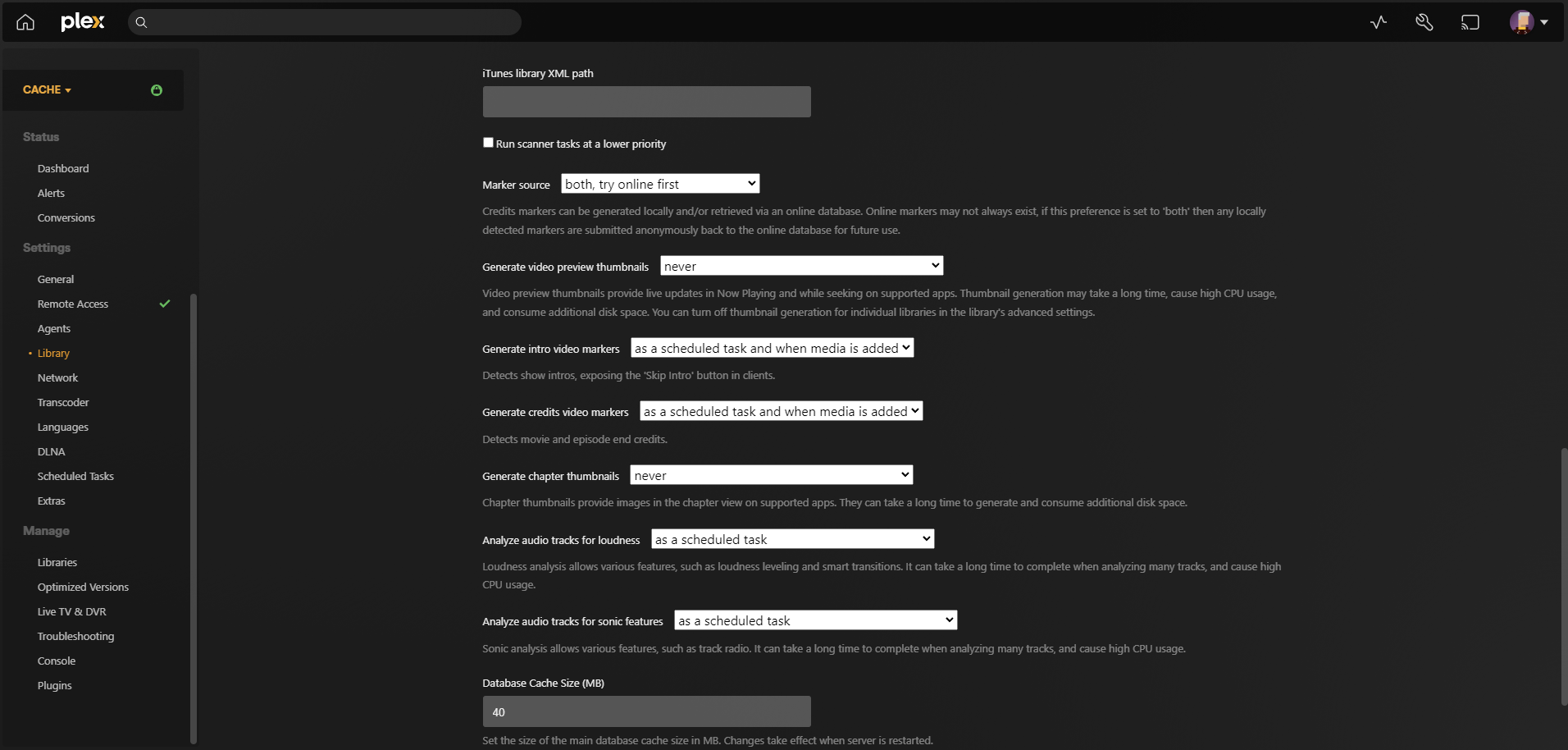

August 22, 20232 yr Should it normally be possible to run hardware transcoding and generate video preview thumbnails/intro/outro detection all at the same time? I'm currently using an Intel n100 CPU and all 4 cores go up to 100% while doing this, so no smooth transcoding is possible. The only solution right now is to run all these things scheduled overnight. Would it help to upgrade to an i3-12100? I would really like to be able to run these things as soon as new media is added but still be able to run 1-2 streams at a time.
August 22, 20232 yr 4 hours ago, Janis.S said: Should it normally be possible to run hardware transcoding and generate video preview thumbnails/intro/outro detection all at the same time? I'm currently using an Intel n100 CPU and all 4 cores go up to 100% while doing this, so no smooth transcoding is possible. The only solution right now is to run all these things scheduled overnight. Would it help to upgrade to an i3-12100? I would really like to be able to run these things as soon as new media is added but still be able to run 1-2 streams at a time. There's a check box under Settings > Library for Run scanner tasks at a lower priority that might help you case, I havne't tried it myself though. I have my server set to just add media at 2 AM and do all the scan tasks then since no one is ever streaming at that time. If I really want to watch a show right away I just downloaded, I either use VLC locally, or Add it to Library and wait the 10 or so minutes for just that one show to do its full scan. Not sure on the upgrade from n100 to i3-12100 though, not sure how different the decode/encode engines are in those. But if you are maxing out all 4 CPU cores for the other parts of the scan (chapters, metadata, intro and outro detection, all audio tasks a CPU bound, some HDR I think is still CPU bound), then the upgrade might help, but I don't think it will completely get rid of the problem.
