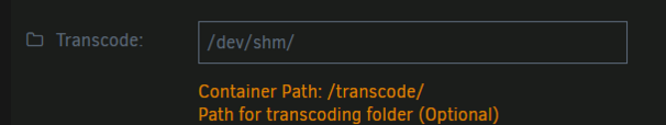

Lately my Plex install is ballooning my docker folder (I switched from image years ago) and I'm not sure what's up. Not the appdata, but the actual docker container folder data itself as reported by Unraid when you hit "container size" in the docker section of the Unraid gui. I woke up to a notification that my ssd was filling up, and after trying to figure out the source I found the Plex docker size to be reporting over 1TB. Updating/restarting the container seems to reset the size back to the expected 300 or so MB. As far as I can tell all of my mounts are correctly mounted to outside of the container (I have not changed them in well over a year). Looking at the different support channels, I seem to be having a similar issue to this post: https://forums.plex.tv/t/unraid-plex-ballooning-overlay2-folder-in-docker-directory/865874 but since the issue was not resolved over on the Plex forums I figured I'd try here as well. I just restarted the container to clear some space and neglected to grab logs, I'll update this post later when I start to see it fill up again. I was wondering if anyone has any ideas where to start for dealing with this.

We've had a report of this before, it's likely the Sonic Analysis dumping files in `/run/plex-temp/` and not deleting them.
Really plex should be dumping this in your tmp folder/memory and at least deleting them when done.
my guess would be do to this folder data path:
as /tmp/transcode is what I use for plex and don't have a issue.
/tmp is unraids tmp folder already in ram.
the /dev/shm needs made before using that path and is another memroy disk in ram...
/dev/shm may be too smal for your transcode casing a disk full eror make extra unneded read and writes...
Gotcha, thanks for the tip! I'll see if I can find a solution.

Thanks for the tip but transcoding to ram has been working for me for a long time this way, I have 128GB of ram and have never had an issue before. I also don't notice disk usage increasing when transcodes are being done.
@jedivoodoo
Did you create a pool called "app" or did you put this in wrong? Typically it's "/mnt/user/appdata/plex"
6 minutes ago, MowMdown said:
@jedivoodoo
I have separate SSDs for the appdata/system shares and download/cache, that's just what I named the appdata drive.
--shm-size=256mb --mount type=tmpfs,target=/tmp/cache,tmpfs-size=1000000000
as example of a extra parameter... that can set and docker manger paths and sizes..
But if transcode it is not. as I have seen this happen due to temp files created for dvr and live stram access for usb/card tuners....
This I start to question old plex configs such as plugins...
you could use the above comands and make a docker variable for
/run/plex-temp/
Mapping container path /run/plex-temp/ to /tmp cache
worth a test...

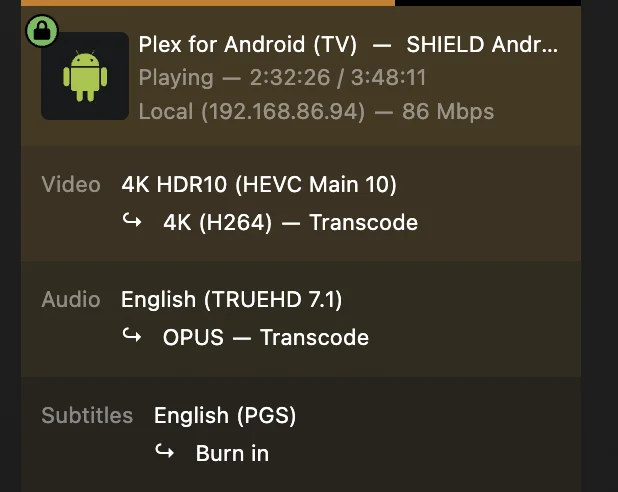

Guys, I just had to rebuild my Plex docker because my appdata become corrupt.
Got Plex up and running, however remote users with Nvidia Shield Pros cannot direct play HDR titles. They used to flawlessly.
Here's how their stream shows on my end.
Even when disabling subtitles, there's no difference. There should be no transcoding, but I can't figure out why Plex is insisting on it.
I've noticed that when unchecking 'enable HDR tonemapping' it allows him to play the title back in HDR - but previously I had this checked so that clients who couldn't play HDR could still benefit from HDR tonemapping. Those who could direct play HDR could still do so flawlessly.
Any ideas?
Edited by Corvus
SOLVED!
I fixed my own problem. It wasn't anything mentioned on any other help forum. Instead, it's a new quirk of Plex. In 'remote access' settings, I had my correct upload speed entered (just like I did on the old server). I didn't think anything of it, especially since the old server no longer exists. All I did on a hunch was delete the value and press 'save'. Despite Plex telling me 'no upload speed set', HDR now streams flawlessly!
Thanks for the new 'feature', Plex!
Solved! Solution just below by ConnerVT
