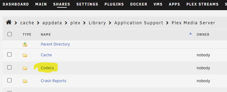

  • Go to the appdata share and look in Plex\Library\Application Support\Plex Media Server\Crash Reports You will find folders for your previous versions named as the release version.
  • Yep, seems like the problem.   Not to be outdone... google.  And what do I find.... Hoopster's post from over a year ago. I see your post here regarding the iGPU not being enabled corr

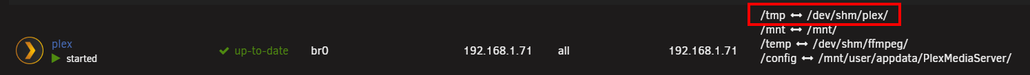

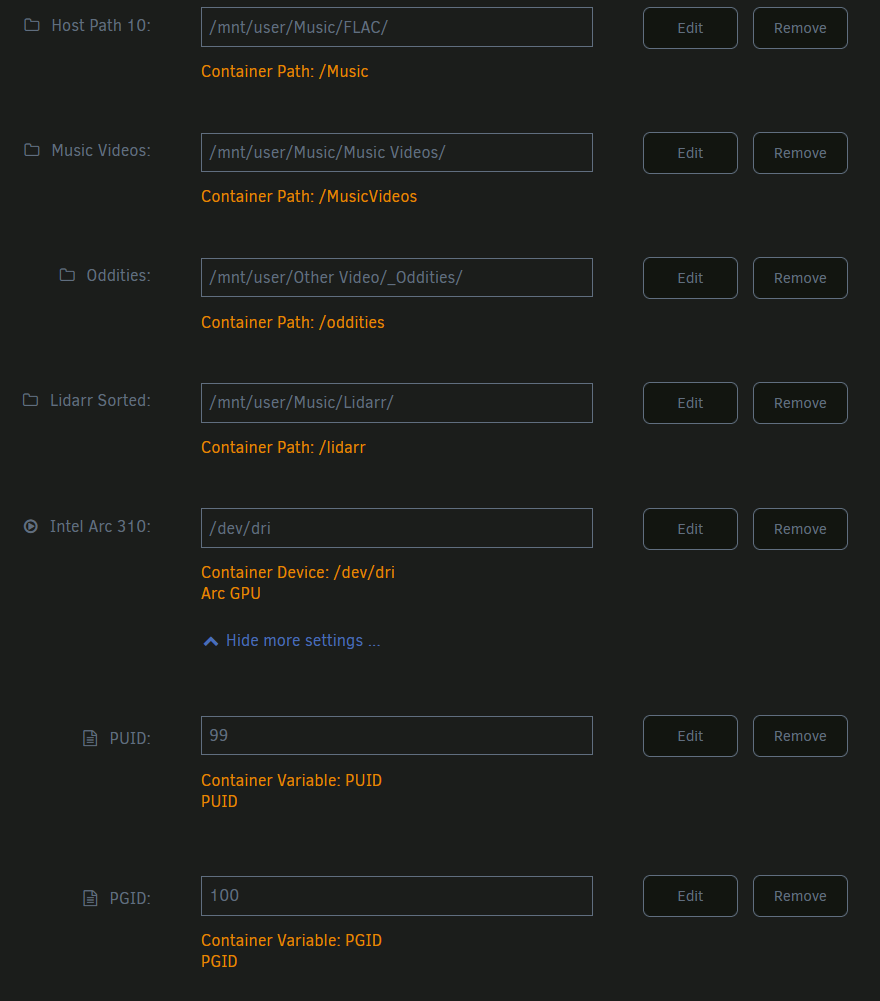

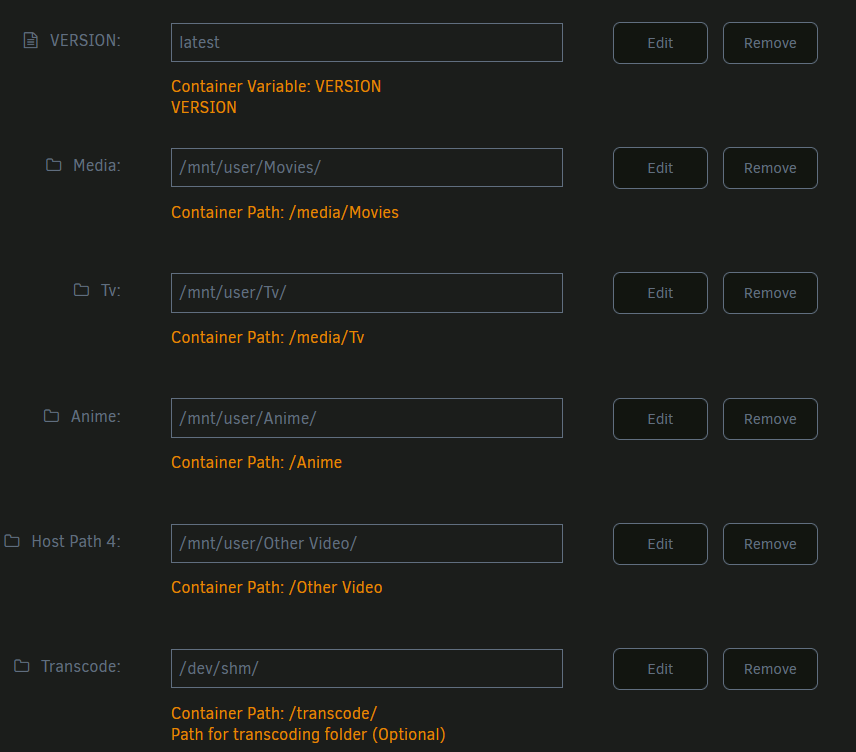

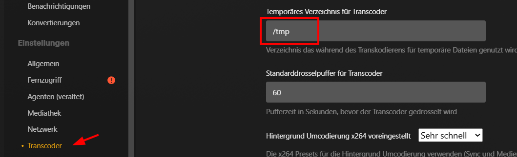

most likely a failed mount inside plex container.
sample, transcode location, compare your mount with your entry inside plex
especially when after a reboot "temp" files are gone
I appreciate the tip but as I've posted earlier, this is not the case. All of my mounts are correct and have not changed in well over a year, but this issue is relatively new. It is related to the sonic analysis feature as far as I can tell and happens primarily when I add new music.

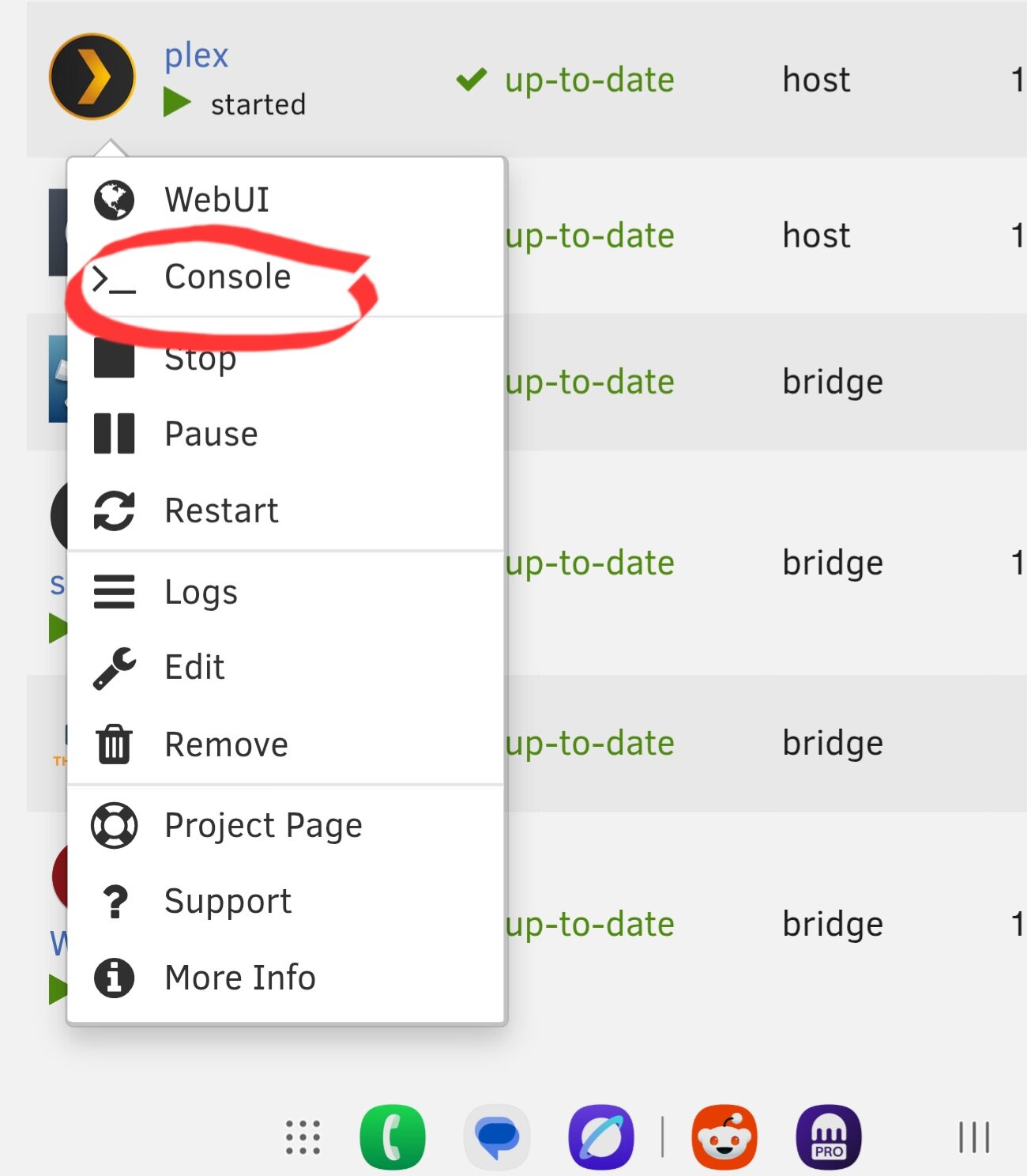

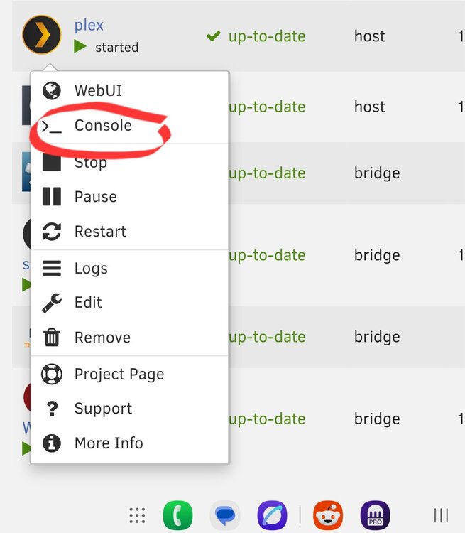

After I reset my password i had a problem to reclaim my unraid plex server, after some googling this worked for me:
I ended up having to do a plex.tv/claim and then used the new claim code via plex docker console with the following:
curl -X POST "http://localhost:32400/myplex/claim?token=YOUR_CLAIM_TOKEN_HERE"

Here is my Plex template. I am mapping the Transcoder temporary directory - /transcode to RAMDISK and Downloads temporary directory - /tmp to TEMP folder on the Plex config drive.

This needs to be reported to Plex. We do not have control where plex dumps it's temp files for credit detections/sonic analysis.
So, @j0nnymoe it turns out it is not a Plex issue rather a LSIO issue. 'TMPDIR=/run/plex-temp' is specified by your build process.
Look at what I found on your build - https://hub.docker.com/layers/linuxserver/plex/latest/images/sha256-9170109a442498630befe62f8236c68ddd7da21cf66c606f9a390dacf931a6e2
ENV DEBIAN_FRONTEND=noninteractive PLEX_DOWNLOAD=https://downloads.plex.tv/plex-media-server-new PLEX_ARCH=amd64 PLEX_MEDIA_SERVER_APPLICATION_SUPPORT_DIR=/config/Library/Application Support PLEX_MEDIA_SERVER_HOME=/usr/lib/plexmediaserver PLEX_MEDIA_SERVER_MAX_PLUGIN_PROCS=6 PLEX_MEDIA_SERVER_USER=abc PLEX_MEDIA_SERVER_INFO_VENDOR=Docker PLEX_MEDIA_SERVER_INFO_DEVICE=Docker Container (LinuxServer.io) TMPDIR=/run/plex-temp
This was first added to 1.41.0 - https://hub.docker.com/layers/linuxserver/plex/1.41.0/images/sha256-dff1f3af12fc385eb3a13901480ce62cd6b2e64f74897cc7d6a13a2922bf5f5a
Before that the last image without this TMPDIR variable is 1.40.5 - https://hub.docker.com/layers/linuxserver/plex/1.40.5/images/sha256-55ca5b9bb96ded7a0ea54f6579ad8285cec7822869f86c88a1bfedd3cf4febcd
I am assuming this makes it so that the docker variable for temp folder gets ignored as well. Please fix thanks.
Edited by Unraid-arr
more info
Good spot - we'll look into it.
Side note, why plex think it's a good idea to use the TMPDIR for stuff that they know is going to use a large amount of space rather than the user configurable path (like transcoding etc) is an absolute mystery.
We could move it back to the default /tmp but the same thing will happen unless users have mounted /tmp to tmpfs (but that will then break read-only and non-root operation)
Worth adding too, while whatever fix we put in place, you're still going to need storage somewhere & it won't fix the fact that plex is creating these large files which then sometimes don't get removed when finished with.
