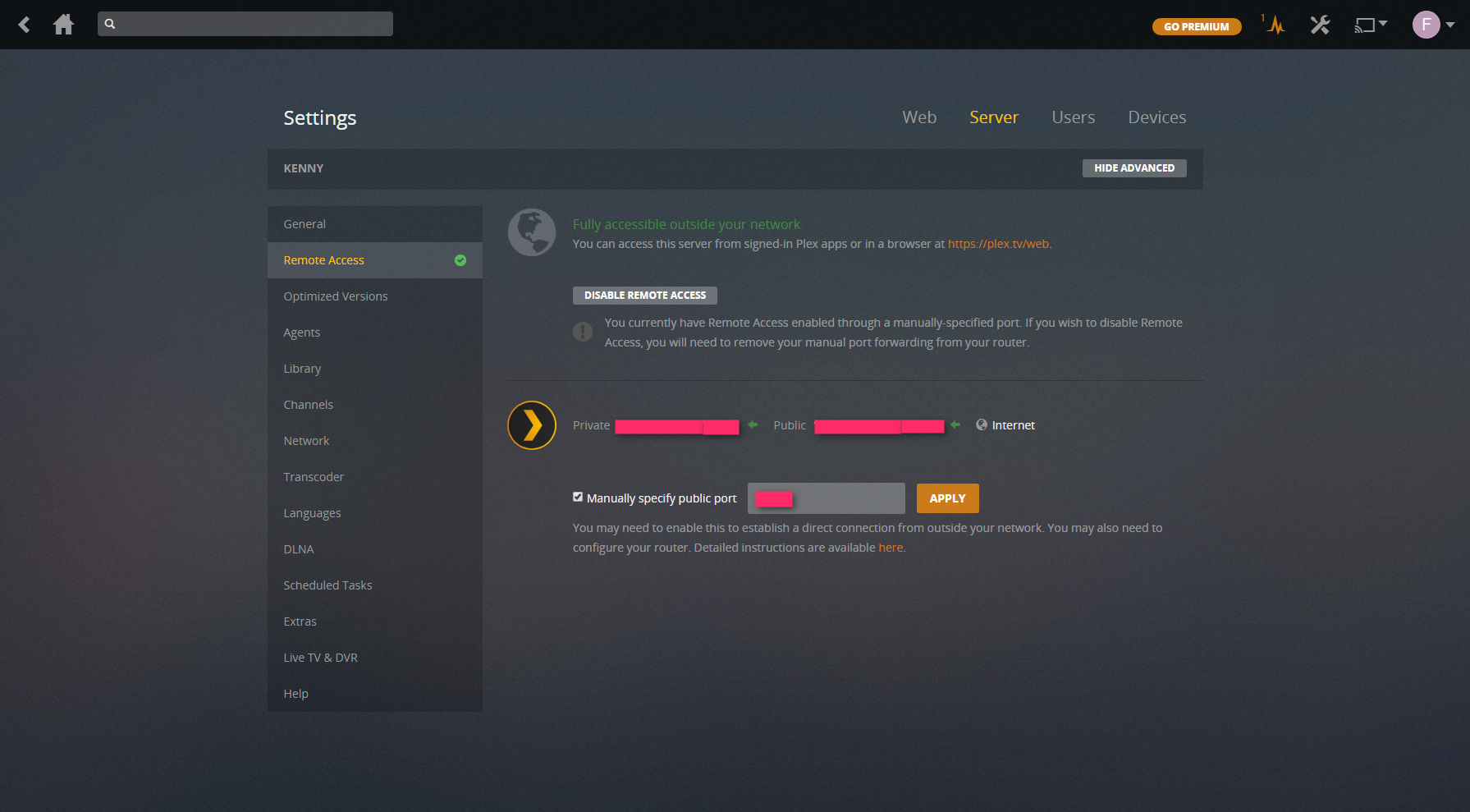

Hello,
I have this docker installed on my unraid server and I seem to be missing the following option;
"limit remote stream bitrate" in Settings --> Server --> Remote Access
The docker is installed as Network Type =  "host"
can anyone else check to see if this option is available in your instance?
4 hours ago, flixxx said:
Hello,
It's  available here. Do you find it if you push the show advanced button?
Edited by saarg
nope, still nothing.
Do you have plex pass? (I don't)
Is you docker set to bridged mode or host? (Not sure if this would impact it)
According to Plex, that feature requires Plex Pass.
