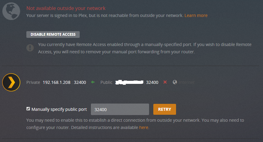

OK - could do with a bit of help on this bit if anyone is able to.
I can't currently get remote access to work - but my hunch is that it's my unraid network interface setup

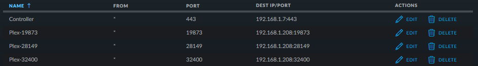

Remote access just won't succeed - I'm using Unifi router, with a modem in bridge mode, so there should not be a double-NAT issue.
In Plex, i've set 'manual port' to 32400 (I've tried letting uPnP take care of it, and I've tried an alternative port - same results)
In Unifi, this port is forwarded to the local IP
if I browse to [public facing ip]:32400/web, the plex web interface successfully loads - so I think that rules out a forwarding / nat issue
I also have (had) another plex install on another machine, which worked just fine, including remote access. So reckon it's something local to the docker/server

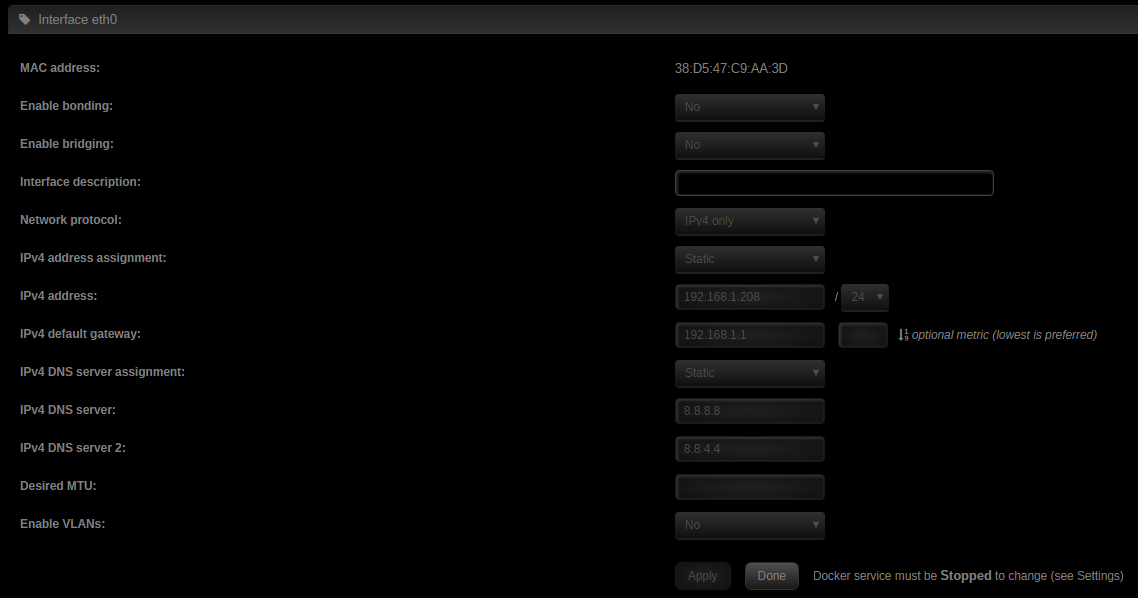

I've attached my eth0 setup - it was a bonded connection (bond0) which I hastily turned back to a regular one when I was having a different problem which I thought might be network related, and wonder if I've done something funky which is blocking communications.

So, after 3 solid days of trying to get this working - I finally worked out what the underlying issue was - both for being able to 'claim' my original server, form sharing libraries, and remote connections. My MTU size was defaulting to 1500, but was evidently too high! Changed it to 1484 (well, used MSS Clamping instead) and instantly worked.

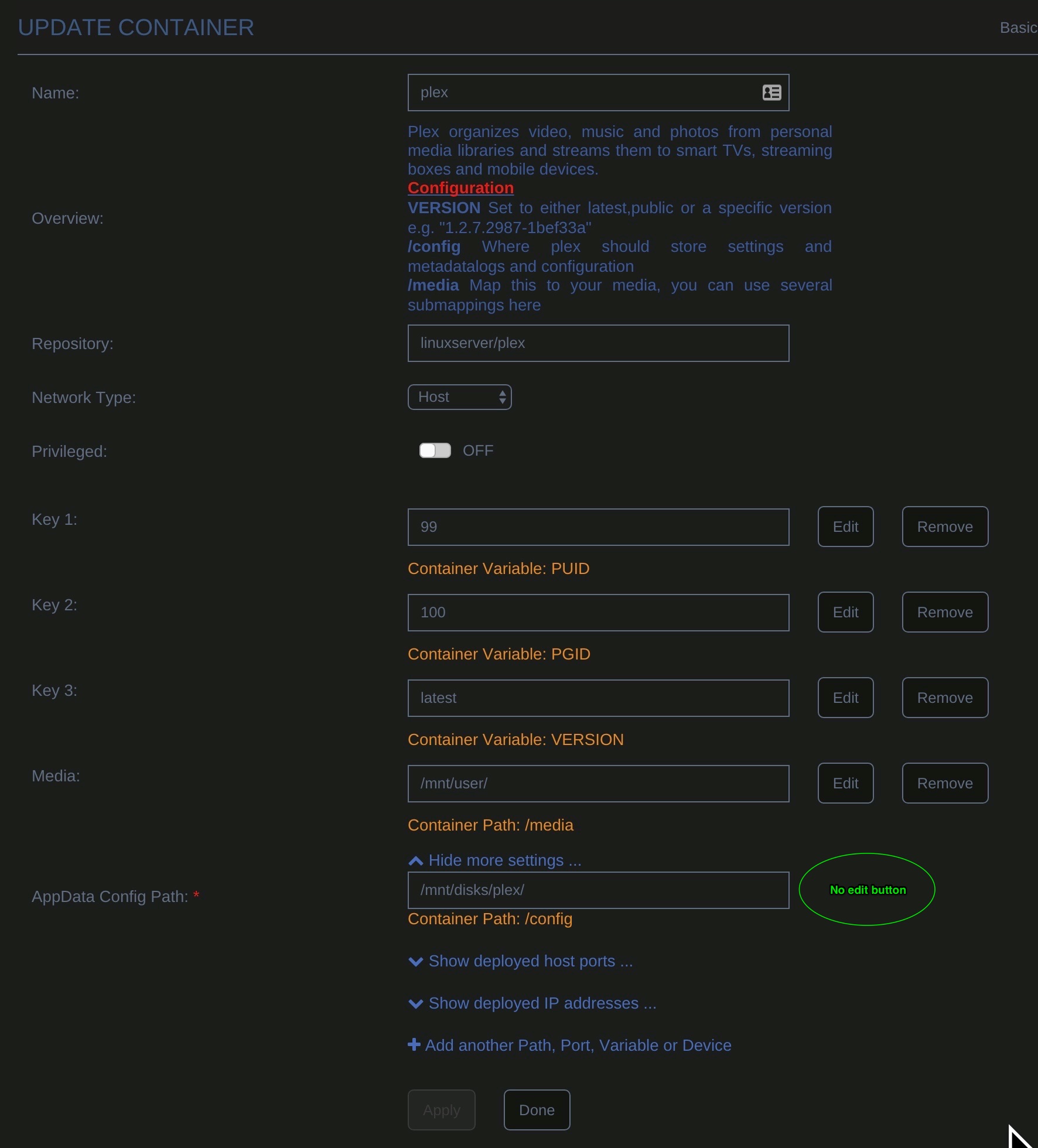

I keep getting a warning from the Fix Common Problems plugin.
Docker application plex has volumes being passed that are mounted by Unassigned Devices, but they are not mounted with the slave option
My Plex /config path is mapped to /mnt/disks/plex/, which is a SSD unassigned device. If I edit the Plex docker, there isn't any option to set/select RW Slave for this path.

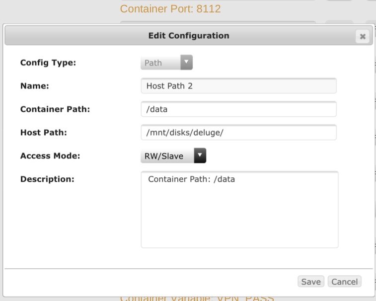

Don't you just click in the box and it allows you to browse?

That will allow me to edit/select the path for /config, but doesn't allow me to select any of the "slave" modes.

Click the edit button for the path and you will see a pop up with the r/w slave option.

Please look at my original post. There isn't an edit button for the /config path.

Turn on advanced view.

Thank you!
I must comment that this is a poor GUI setup. I would suggest that all Edit buttons be displayed in either Basic or Advanced mode. having a mix is confusing.
