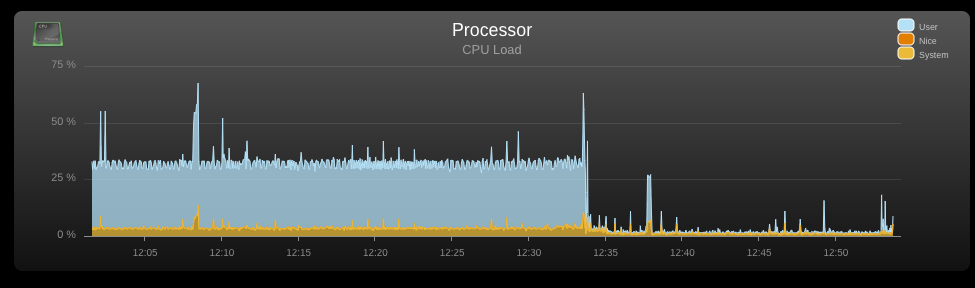

On 19/02/2018 at 12:54 PM, WannabeMKII said:
As an additional screenshot, I restarted the Plex docker at 12:34 and this is the outcome.
I'm still after help with this if anyone can help? Appears to be happening every other day...?
Is Plex indexing or doing anything at this point?
what are your thumbnail settings in plex scheduled tasks?
It shouldn't be and not that I can see.

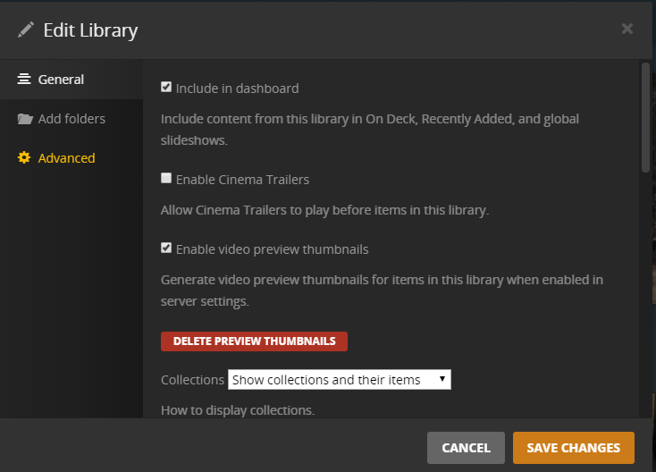

Scheduled tasks are due to start at 2am and finish by 5am. Is that what you mean?
I may have missed this in the thread, but are you sure something isn't streaming? Have you tried Active Streams, File Activity, and Open Files plugins to see what they say?
are your thumbnails set to be created on a schedule or 'as a scheduled task and when media is added' - found in Library settings.
100% sure. I also have Tautulli and PlexPy keeping an eye on things.
They're set to be run 'as a scheduled task' only at the moment.

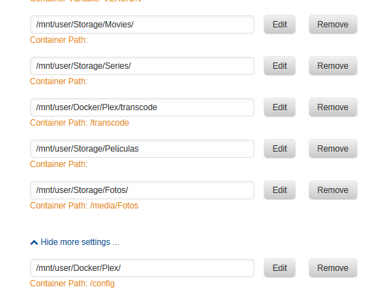

23 minutes ago, L0rdRaiden said:
What could be the reason behind plex not keeping settings or at least some of them after a reboot?
I had as well another issue, I had a message in plex saying that there was as new version, but according to docker it was the last one. A few minutes later plex says that I have the latest version, right now I have Version 1.12.0.4829. What has happend? has plex autoupdate, wihout updating the docker image? is this ok? I though the only way to update plex was when the docker version updates.
I see there is a new version but according to plex is the last one.
If your config is gone after a reboot, you either didn't configure your config mount or you specified it the wrong place.
But without the run command, it's just speculations.
The container updates on start of the container. The update on the docker page is for the container itself. It updates the base OS and dependencies when we refresh the container every friday.
Edited by saarg
I think the configuration is fine, right? I will test it again.
On the other hand you mean that there is now way, Plex is able to autoupdate unless it is done through docker?
You might want to change the config one to /mnt/cache or /mnt/diskX as user might cause issues.
I also see that for some of your mounts there are no container path. You should add one.
The Plex container only auto updates when you restart the container.
