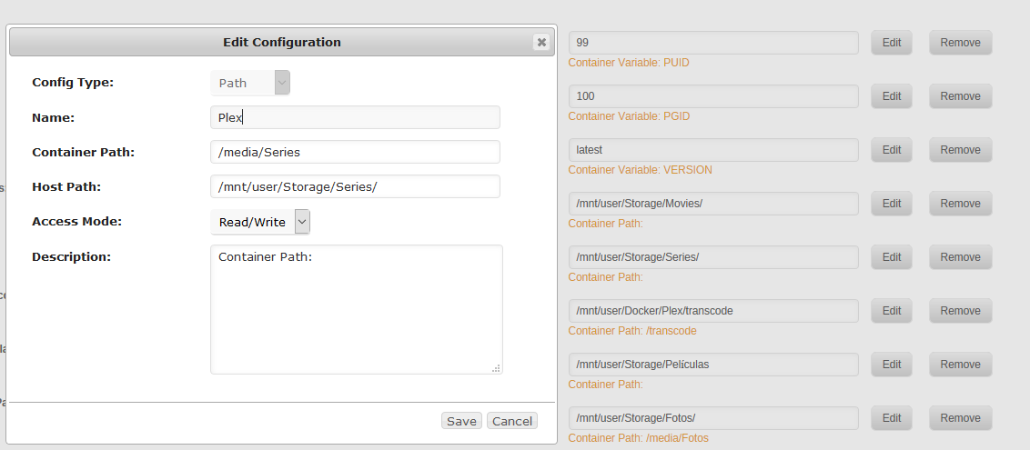

You might want to change the config one to /mnt/cache or /mnt/diskX as user might cause issues.
I also see that for some of your mounts there are no container path. You should add one.
The Plex container only auto updates when you restart the container.
If I take all my dockers apps in none of them I have applied the container path? why do I need it?
Why "user" can cause issues?
Sorry for asking but I like to understand the root cause, so I learn and don't repeat mistakes.
Without a container path, there is no way for the application to access the storage specified by the host path. I am surprised you aren't getting an error trying to start the docker with the settings in your screenshot.
Depends. What is the Use cache: setting of your Docker user share?
If you don't understand what is wrong with the settings in your screenshot, then you obviously don't understand volume mapping. Please see the first link in the Docker FAQ. It will tell you what we need to help you. Then read at least the "Getting Started" portion of the Docker FAQ.

I understand the mapping, I think, I already read the guide but I don't see anything that goes against my configuration
My container is in /mnt/user/Docker/Plex/ including the config files, but I have never map in any docker app the container path and everything works.

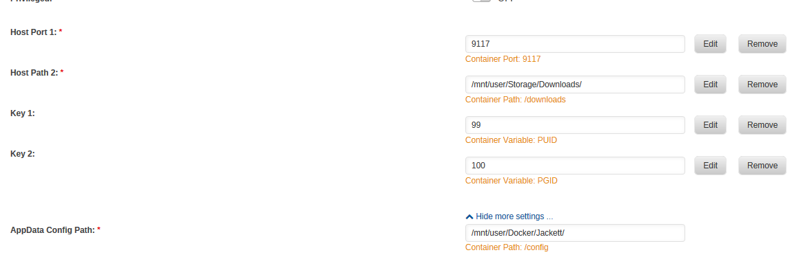

For example this is what Jackett looks like
I guess is because I have used the same path for both configs files and containers/images, is this a bad idea?
Do I need to map then the image? how do I do it? what paths do I use? where can I find an example?

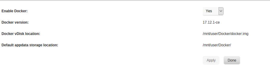

The cache setting is prefer. I treat the docker folder as AppData since I don't have Appdata (I don't use that share or that name)

If you compare that screenshot with the previous one, you will see that in the area below the textbox where it has the words "Container Path" in orange lettering, Jackett has /downloads, for example, but similar places on your other screenshot there is nothing next to "Container Path" for many of those. For example, for the host path /mnt/user/Storage/movies, there is nothing next to "Container Path".
If you really want to learn, please do as I said and look at that link to the Docker FAQ I already gave. Then you will know what we want you to give us whenever you have any docker problem (at the first link in the FAQ), and you will be able to ask better questions if you at least try to understand the "Getting Started" stuff. The questions you are asking now are really just kind of random.
As I already said I read the FAQ weeks ago and understood it.
If you don't see the path is becasue this taken from the description of it, and I haven't written anything, but the mapings are setup correctly.
So the config is fine, and regarding the issue that brought me here of plex settings not being saved, which has nothing to do by the way with having a movie folder with a bad mapping, I will take a closer look to see what could be the root cause, in case you may know why, I'm all ears.

By using /mnt/user instead of /mnt/cache or /mnt/diskX you might get issues like you have with config not saving. Using /mnt/user you are going through the fuse system and that has shown to have a bad impact on config mounts alot of times.
So try changing that as a start.
As for the container path not there, we just tried to help as we saw something was wrong. But I'll hold it in next time.
