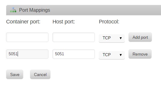

Port mappings attached. Although I can connect through 5051, I'm still getting port in use errors, which I assume is coming from the renamer. The folders in question end up with .ignore files and the movies never get moved.

DON'T change the container port, just the host side.

Have you changed the port to 5051 in the couchpotato ui? If so change it back and keep it as 5050.  If in doubt delete your container, appdata and recreate from fresh.

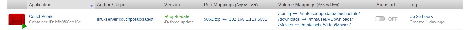

Post some screenshots of you Unraid docker page (with the advanced view), and your couchpotato webui settings.
Docker page won't tell you much, I changed it back to 5050 and changed the config file back to 5050. Setting up ports was not my issue, other than the damn renamer bitching about port already in use.

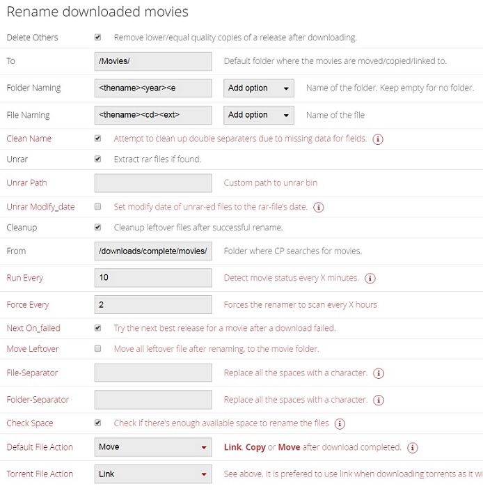

Including my Docker page and Renamer settings

I was looking for orphan containers and any conflicts.  Either you're doing something not quite right or there's a conflict somewhere with your ports.

I was going to run a port scan to see if anything else is on 5050, but I don't think so. I think Renamer is just off somehow. I did read somewhere that the From folder should not be your download folder, as it might try to move movies before they are complete. But it won't move them manually either. The first few times I tried it manually I got directory does not exist, but now I don't even get that. I've read a bunch of similar complaints on the CP forum, but no one fix.
