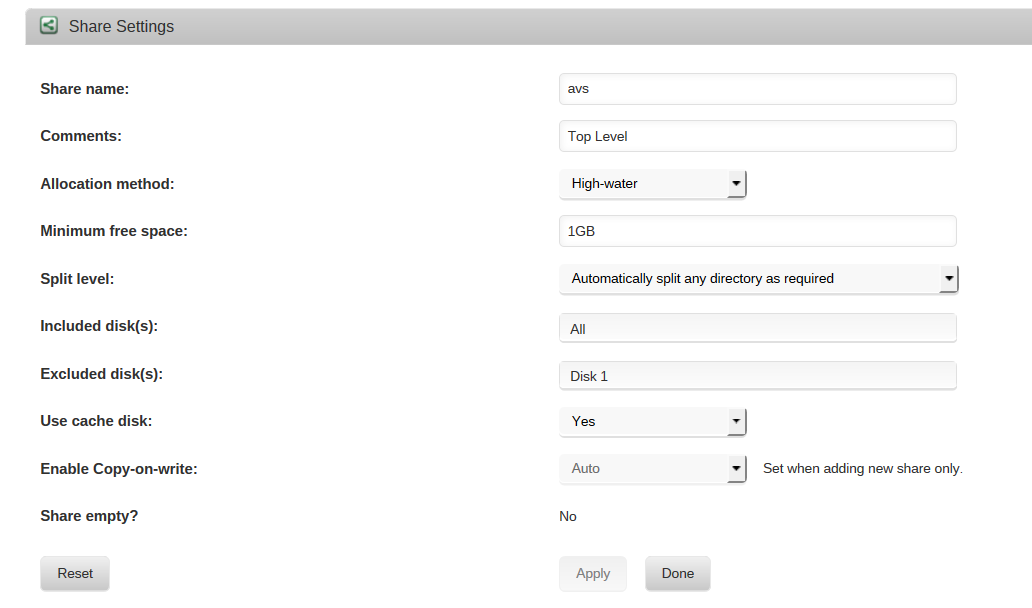

August 14, 201511 yr Author Robj I think I have solved this one.I have attached the "screenlogs" pasted the latest one. Aug 14 07:09:01 Tower kernel: ffff8800995ac010: 00 00 00 01 00 00 00 9b c5 06 e0 29 17 fc 4b 42 ...........)..KB Aug 14 07:09:01 Tower kernel: ffff8800995ac020: af 1e e9 94 80 d5 75 12 00 00 00 00 00 00 00 66 ......u........f Aug 14 07:09:01 Tower kernel: ffff8800995ac030: 02 70 0d 28 00 00 00 00 00 00 00 00 00 00 00 00 .p.(............ Aug 14 07:09:01 Tower kernel: XFS (md1): Metadata corruption detected at xfs_dir3_block_read_verify+0xa6/0xb1, block 0x58 Aug 14 07:09:01 Tower kernel: XFS (md1): Unmount and run xfs_repair Aug 14 07:09:01 Tower kernel: XFS (md1): First 64 bytes of corrupted metadata buffer: Aug 14 07:09:01 Tower kernel: ffff8800995ac000: 58 44 42 33 7f 35 b4 55 00 00 00 00 00 00 00 58 XDB3.5.U.......X Aug 14 07:09:01 Tower kernel: ffff8800995ac010: 00 00 00 01 00 00 00 9b c5 06 e0 29 17 fc 4b 42 ...........)..KB Aug 14 07:09:01 Tower kernel: ffff8800995ac020: af 1e e9 94 80 d5 75 12 00 00 00 00 00 00 00 66 ......u........f Aug 14 07:09:01 Tower kernel: ffff8800995ac030: 02 70 0d 28 00 00 00 00 00 00 00 00 00 00 00 00 .p.(............ Aug 14 07:09:01 Tower kernel: XFS (md1): metadata I/O error: block 0x58 ("xfs_trans_read_buf_map") error 117 numblks 8 Aug 14 07:09:05 Tower emhttp: shcmd (1218): mv '/mnt/user/Video' '/mnt/user/avs' |& logger Aug 14 07:09:05 Tower emhttp: shcmd (1219): mv '/boot/config/shares/Video.cfg' '/boot/config/shares/avs.cfg' &> /dev/null Aug 14 07:09:05 Tower emhttp: shcmd (1220): :>/etc/samba/smb-shares.conf Aug 14 07:09:05 Tower emhttp: shcmd (1221): cp /etc/exports- /etc/exports Aug 14 07:09:05 Tower avahi-daemon[10229]: Files changed, reloading. Aug 14 07:09:05 Tower emhttp: shcmd (1222): echo '"/mnt/user/avs" -async,no_subtree_check,fsid=100 *(sec=sys,ro,insecure,anongid=100,anonuid=99,all_squash)' >>/etc/exports Aug 14 07:09:05 Tower emhttp: Restart SMB... Aug 14 07:09:05 Tower emhttp: shcmd (1223): killall -HUP smbd Aug 14 07:09:05 Tower emhttp: shcmd (1224): cp /etc/avahi/services/smb.service- /etc/avahi/services/smb.service Aug 14 07:09:05 Tower avahi-daemon[10229]: Files changed, reloading. Aug 14 07:09:05 Tower avahi-daemon[10229]: Service group file /services/smb.service changed, reloading. Aug 14 07:09:05 Tower emhttp: shcmd (1225): pidof rpc.mountd &> /dev/null Aug 14 07:09:05 Tower emhttp: Restart NFS... Aug 14 07:09:05 Tower emhttp: shcmd (1226): exportfs -ra |& logger Aug 14 07:09:05 Tower emhttp: shcmd (1227): /etc/rc.d/rc.atalk status Aug 14 07:09:06 Tower avahi-daemon[10229]: Service "Tower" (/services/smb.service) successfully established. Aug 14 07:10:09 Tower emhttp: /usr/bin/tail -n 42 -f /var/log/syslog 2>&1 Aug 14 07:12:10 Tower emhttp: /usr/bin/tail -n 42 -f /var/log/syslog 2>&1 Aug 14 07:23:06 Tower kernel: mdcmd (26): spindown 3 Aug 14 07:23:06 Tower kernel: mdcmd (27): spindown 4 Aug 14 07:23:06 Tower kernel: mdcmd (28): spindown 5 Aug 14 07:23:06 Tower kernel: mdcmd (29): spindown 6 Aug 14 07:24:43 Tower emhttp: shcmd (1228): /usr/sbin/hdparm -y /dev/sdc &> /dev/null Aug 14 07:24:44 Tower emhttp: shcmd (1229): /usr/sbin/hdparm -y /dev/sdd &> /dev/null Aug 14 07:26:06 Tower kernel: mdcmd (30): spindown 1 Aug 14 07:26:06 Tower kernel: mdcmd (31): spindown 2 Aug 14 07:41:06 Tower kernel: mdcmd (32): spindown 0 Aug 14 08:00:01 Tower logger: mover started Aug 14 08:00:01 Tower logger: skipping "plexmediaserver" Aug 14 08:00:01 Tower logger: mover finished Aug 14 08:32:54 Tower emhttp: /usr/bin/tail -n 42 -f /var/log/syslog 2>&1 We had a power outage two weeks ago.I had no ups on the box at the time.That could have caused this corruption issue.I had not touched the box at all up until Monday as I tried to do a parity swap from 2TB to a 4TB.The preclear on two 4TB took days and I only did a 2x preclear.I still need to figure out why the 2TB that was moved to a data slot and which happened to be the "faulty disk" did not ask to be formatted to XFS. After the xfs_repairs starting with a -v from a remote ssh session to a GUI repair using -n and the finally -L as the last resort,I removed the md1 or disk1 after stopping the array in maintenance mode and started the array without it.The array detected the missing disk and started normally.I did not check the shares or the presence of smb shares at this stage.The array was stopped and started with the disk1 and it detected it as a new disk a continued to rebuild the disk1 into the array which took a couple of hours.I decided to try another xfs_repair -n,then -v and again -L and no change.The system just continued to kick out the xfs error text every few seconds. I started the array in normal mode and found all the shares that were missing and the new ones I created initially where present in the list of shares.The system continued to kick out xfs errors and I decided to move the valid data and delete all shares.I could delete all but one video share.I stopped and started the array as this would have restarted smb.The "video" share was still present after that.I decided rename the share in the GUI solved the shares creation problem.The XfS dump issue stopped after the rename i.e ": mv '/boot/config/shares/Video.cfg' '/boot/config/shares/avs.cfg' &> /dev/null " as shown in the attached log.I still cannot delete the renamed share on disk1 and a new xfs message has popped up "Structure needs cleaning".This appears at the second level or folder in that broken share.I have removed disk1 from global shares to delete the share structure but it keeps on saying""Structure needs cleaning".I have decided to format the drive with reiserfs. avs_shares.zip
