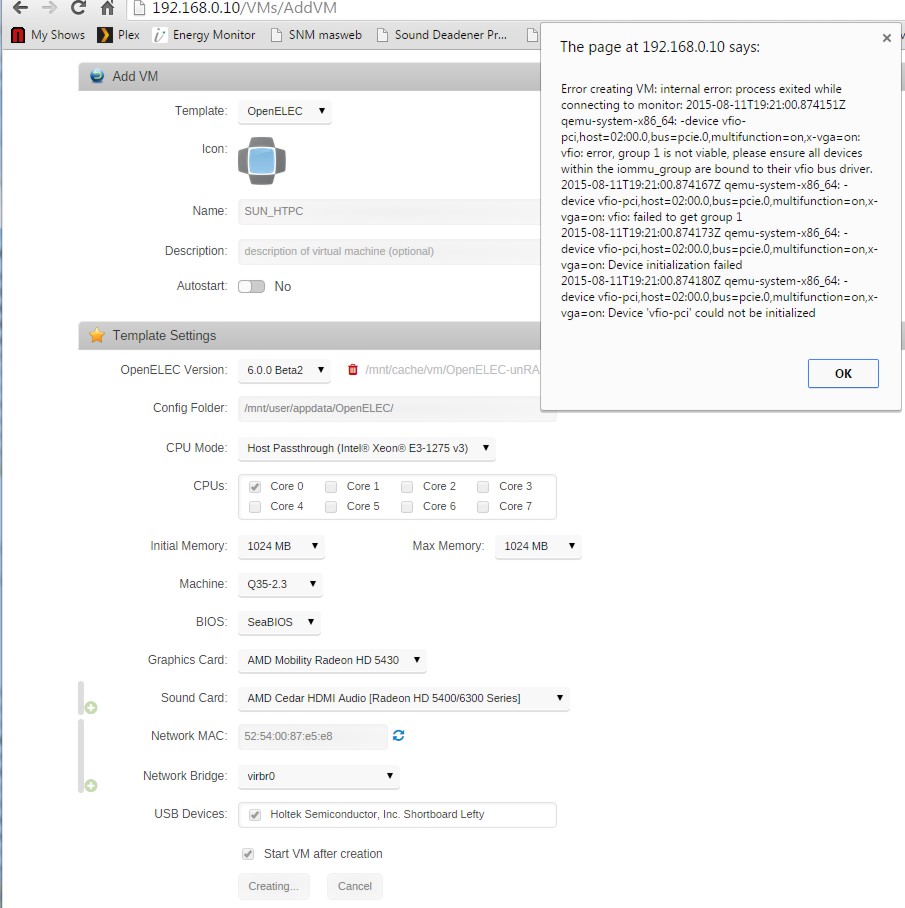

Trying to install the official Limetech Openelec VM and I'm getting an error creating the VM, jpeg is attached. Is this my graphics card not compatible?
Your graphics card is in a group with other devices, so you aren't able to pass it through it looks like. You have to turn on PCIe ACS Override in Settings --> VM Manager.
After you enable the setting you have to reboot your server.
Many thanks, works perfectly now.
