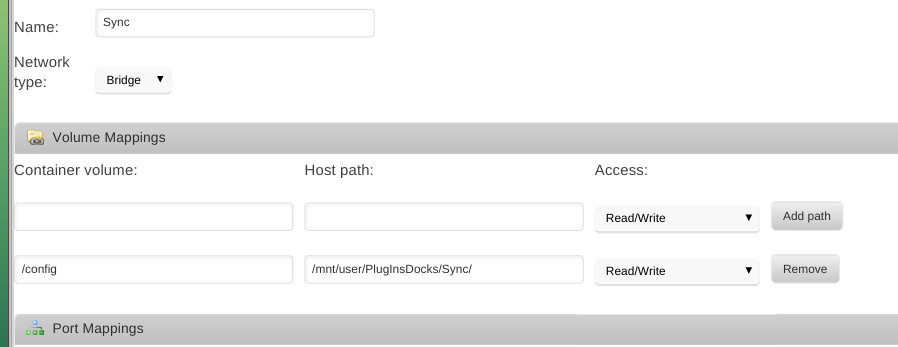

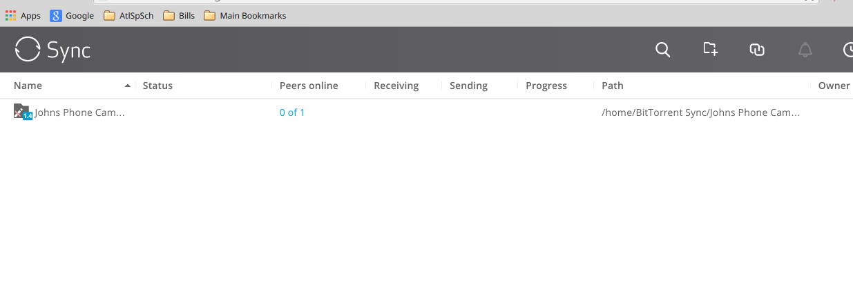

I got BTSync to sync my photos from my phone, but where are they? It says  "/home/Bitorrent Sync/Johns Phone Camera". But where is that, I can not find it on my unRaid 6 server. When I do the drop down menu in "Volume Mappings" to select a location to the host path, It's like it is on the OS that was built for the container and I can not get it out of the container on to my server disks or shares.
Thanks
I don't use this docker, but the principle is the same with all of them. You have to tell the docker where on the host "/home/BitTorrent Sync/Johns Phone Camera" is. That is the whole point of the volume mappings. You told it /config was at /mnt/user/PluginsDock/Sync, and if you look there I'm sure you will find what the docker has in /config. But since you didn't tell it where to put anythinng else, it is inside docker.img, probably taking up way too much space. I suggest you remove container and image to clean up the mess and try again.
Also, before trying it again, see search tips in my sig and see if you can find other posts about using this docker.
