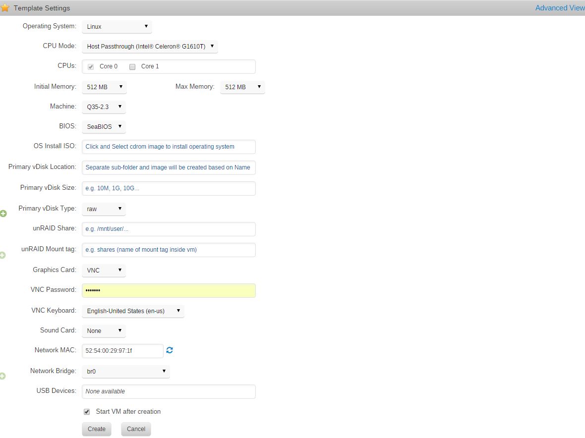

I can do the "e1000" thats fine but
I dont have the same options in advanced ????
Please see attached jpeg
Just RAW or qcow2 for primary vdisk type
Which version of unraid do you have?
6.1.9
Thats probably why you cant change the bus type in the gui (My Version: cBpnGE4.png)

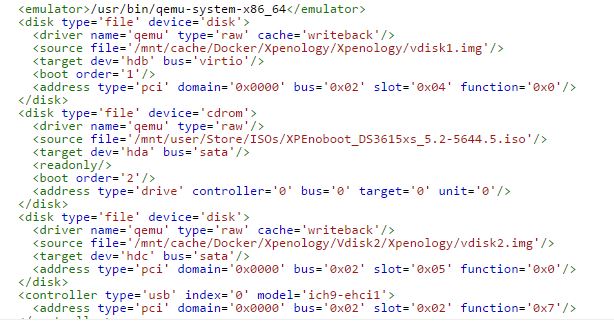

Im not 100% sure if this works but try changing the harddrive config to:
      <source file='/mnt/user/DSM/DSM/vdisk1.img'/>
      <backingStore/>
      <target dev='hdc' bus='sata'/>
      <boot order='2'/>
      <alias name='sata0-0-2'/>
      <address type='drive' controller='0' bus='0' target='0' unit='2'/>
Replace the red text with your settings

My text doesn't match yours,Vdisk2 was already "hdc" but bus was "virtio" i have changed to sata but error on start  >:(
Try this config:
      <source file='/mnt/user/isos/XPEnoboot_DS3615xs_5.2-5644.5.iso'/>
      <backingStore/>
      <target dev='hda' bus='sata'/>
      <readonly/>
      <boot order='1'/>
      <alias name='sata0-0-0'/>
    </disk>
      <backingStore/>
      <target dev='hdb' bus='sata'/>
      <boot order='2'/>
      <source file='/mnt/user/DSM/DSM/vdisk2.img'/>
      <backingStore/>
      <boot order='3'/>
      <alias name='sata0-0-4'/>
      <address type='drive' controller='0' bus='0' target='0' unit='4'/>

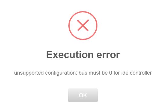

My config file dosen't look exactly the same and when i edit it and change virtio to sata it says unsupported config

I'll just have to switch/wait for the 6.2 release  :(
Yes, looks like the stable version doesent support sata :(
