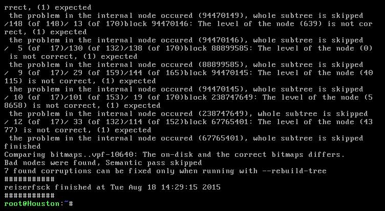

August 18, 201511 yr I notice an issue where I could not move/delete some files on the unRaid system. I found out that they are mounted as read only. There seems to have been some sort of reiser issue causing things to be mounted as read only. I followed the instruction to run a reiserfsck and the results are attached below. Syslog also attached. http://lime-technology.com/wiki/index.php/Check_Disk_Filesystems#Drives_formatted_with_ReiserFS_using_unRAID_v5_or_later The above page mentions to not run the --rebuild-tree option without some expert consultation, so that is why I am here. What is my next step? syslog.zip
August 19, 201511 yr The above page mentions to not run the --rebuild-tree option without some expert consultation, so that is why I am here. What is my next step? Yeah, portions of that page were written many years ago, including those warnings in red! I think it's time to relax them, turn off the red, especially now with the webGUI to run the command. At the same time, there was a reason it was in red. We didn't want people just casually running those options, without knowing how dangerous they were. It's like heart surgery, you don't ask for it unless you really need it. It never returns the system to perfect, and there may be a little data loss. It does a great job, and makes the drive usable again, but it's possible files may be lost or corrupted, or moved into the lost+found folder. Go ahead and rerun the reiserfsck command with the --rebuild-tree option. Unfortunately if it says you need it, then you do. Was there any reason you preferred the command line over the webGui method? If you like, you can use the webGUI method and put the --rebuild-tree option into the options box, and click the Check button.
August 19, 201511 yr Author I didn't even realize I could do it from the GUI now. I'll have to look and get familiar with that. I did run the command and it finished. There was nothing in the lost & found folder. Whatever was corrupt is just gone, and I have no clue what it may have been. This issue has brought up some questions though. What is md1? The drives are sda, sdb, etc. I have never seen a md1 drive. Was this an issue with a single drive or is it something that is spread across devices?
