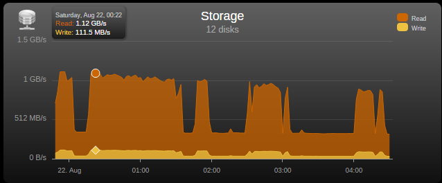

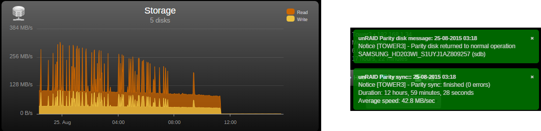

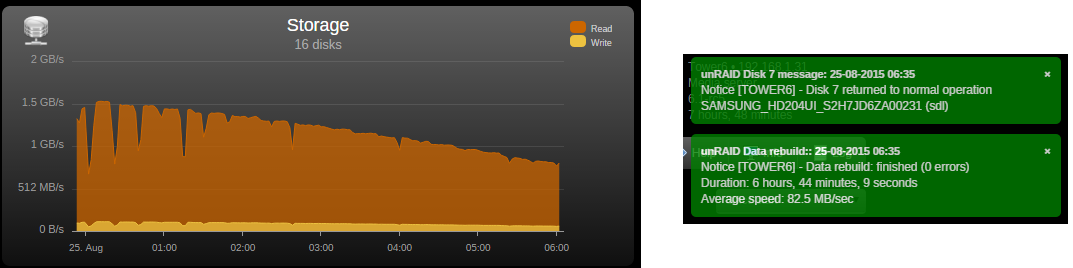

In the last few months I’ve noticed that sometimes on some of my servers parity check, sync or disk replacement are done with a very irregular speed, this happens in at least 3 different servers so it can’t be a bad board or controller card.
There’s nothing in the log when the speed changes, tried blowing a fan on the SAS card in case it was overheating, happens with 6.0.1 and latest 6.1rcs but not always and with varying degrees.

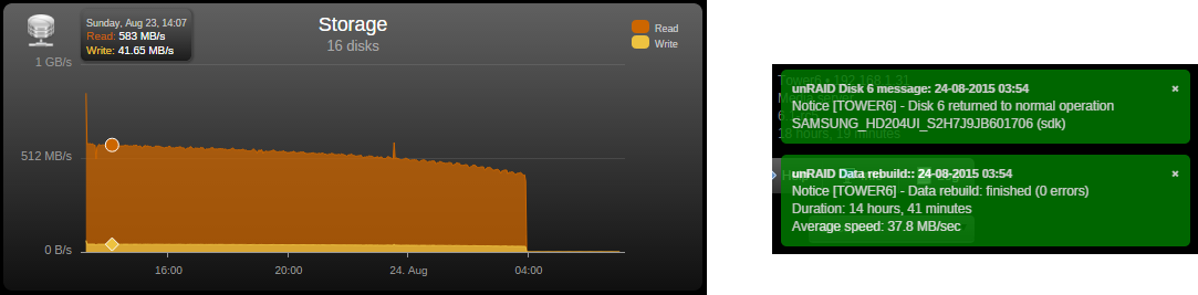

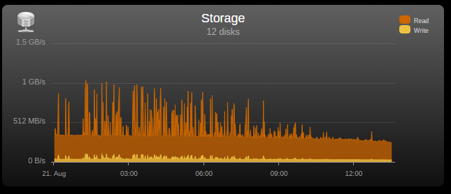

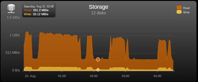

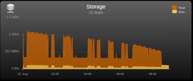

Below are screenshots of a disk replacement and a parity sync, one done almost always at the minimum speed and the other fluctuating many times between normal and slow.
It’s frustrating because it’s not always reproducible but when it happens it can double the duration of the operation, anyone seen anything similar or has any ideas?

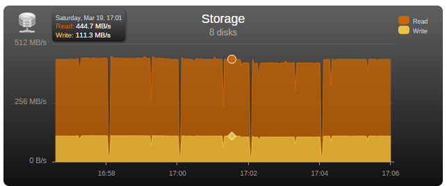

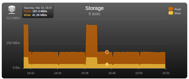

Screens below of how this issue looks if using or not one or more of these disks connect to a AHCI controller during 10 minutes of a parity sync.
