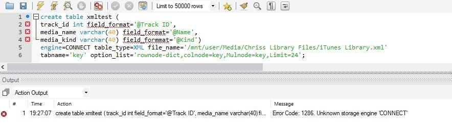

Looking to load an XML file (itunes library.xml) into a database.  However it seem this container doesn't have CONNECT installed with mariadb.
I am requesting this be added into the container build
