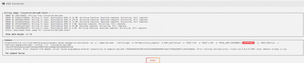

hi, when i put password for root user i cant connect to mariadb, and i have this error: Current charset is windows-1252. If password has been set using other charset, consider using option 'passwordCharacterEncoding', how to use this variable to setCharacterEncoding in docker?
I installed this first time today and got this, anyone know?

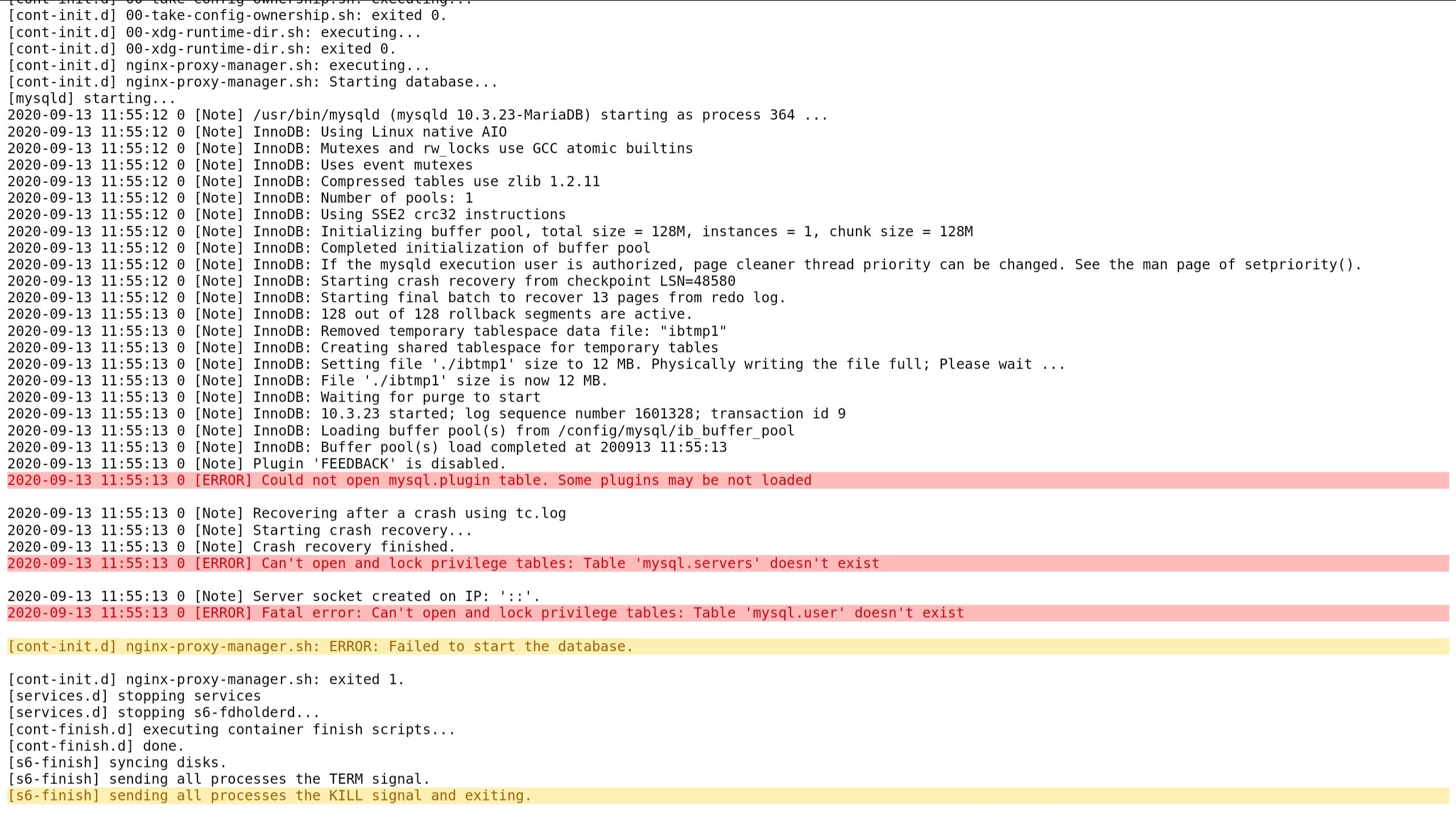

I have just updated the container however my reverse proxy has gone down reporting three errors relating to MariaDB;
2020-09-13 6:11:54 0 [ERROR] Could not open mysql.plugin table. Some plugins may be not loaded
2020-09-13 6:11:54 0 [ERROR] Can't open and lock privilege tables: Table 'mysql.servers' doesn't exist
2020-09-13 6:11:54 0 [ERROR] Fatal error: Can't open and lock privilege tables: Table 'mysql.user' doesn't exist
Any advice would be greatly appreciated.
***Edit***
I have tried removing;
ib_logfile0
ib_logfile1 &
aria_log_control
And restarting the service however that did not work, neither did downgrading the container image.
I'm not sure what nginx-proxy-manager has to do with our mariadb container? The above screenshot doesn't look like it's from our container.
Apologies, I should have clarified, I updated the MariaDB container then I started getting the above errors in NginxProxyManager. The screenshot (from NPM) was just to show the errors and how they were formatted. I assumed that the errors were purporting to be caused by MariaDB somehow, however I could well be wrong.
I have raised an issue on GitHub with the NPM team, incase the error was from their end, however I wanted to enquire here also as the errors mentioned difficulty in connecting to MySQL.
I got this working by changing "bridge" to "host", now I have a new problem.
When I open it console and type mysql -uroot -p I write my pw and hen this in coming, tried reinstall of container, same problem:
# mysql -uroot -p
Enter password:
ERROR 2002 (HY000): Can't connect to local MySQL server through socket '/var/run/mysqld/mysqld.sock' (2)
It still doesn't have anything to do with our container. There is MySQL inside the container. It's pretty obvious from looking at the screenshot you posted.
