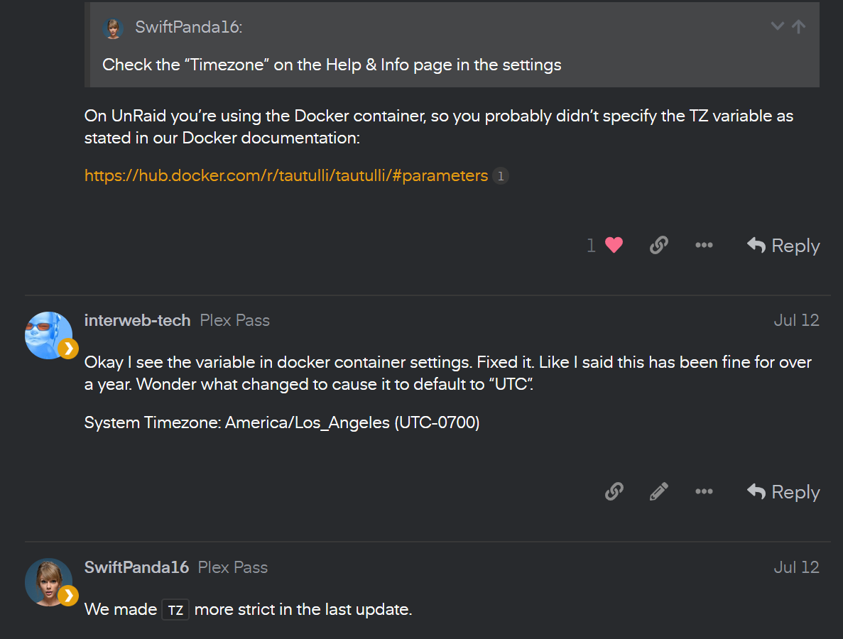

So yesteday I realized something is funky with the logging in my Tautulli. When i view the History tab, the timestamps are wrong compared to when the episode/movie was played. This was correct just a few days ago.
Both Tautulli and Plex run with same timezone, and if I open the Tautulli app on my android phone, the History tab shows the correct timestamps, so it's only in the Tautulli docker that the timestamps are wrong. Not really sure how this happend?
Ran update on both plex and tautulli, no change. Correct in app, wrong in docker. Run command is pretty basic, no big changes.
root@localhost:# /usr/local/emhttp/plugins/dynamix.docker.manager/scripts/docker run -d --name='tautulli' --net='bridge' --cpuset-cpus='0,2,4,6,8,10,1,3,5,7,9,11' --log-opt max-size='50m' --log-opt max-file='1' -e TZ="Europe/Berlin" -e HOST_OS="Unraid" -e 'PUID'='99' -e 'PGID'='100' -p '8181:8181/tcp' -v '/mnt/user/FTP/':'/logs':'ro' -v '/mnt/user/appdata/tautulli':'/config':'rw' 'linuxserver/tautulli'
Running 6.7.0 unraid atm.
Sorry for using a screenshot but easiest way to quote from another forum (Plex forum)
Link to TZ parameters:  https://hub.docker.com/r/tautulli/tautulli/#parameters
Tnx for the post, I finally realized it was just me being stupid. When viewing the logs, I was connected trough my vpn to my VM that I hadn't changed the timezone on the computer itself. So the computer was running US timezone. Now at home, everything is correct, and this is also why my phone was showing the correct timezone :D

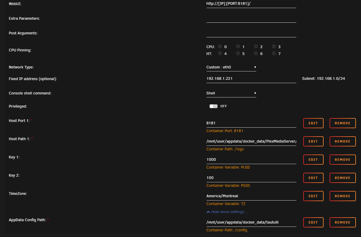

Hi all,
for the life of me, I can't figure out how to make this work in Unraid with a "custom" network Type.
All my Containers use distinct IPs, so they can route beween each other if some need to (host to host = ok, bridge to bridge = ok, custom to custom = ok, but Never managed to get differing network types to route to each other, the simplest was to go Custom IPs all the way)
Can't get access to the webUI if I use a config like in the screenshot. I reinstalled the whole image from scratch and removed the existing config folder,
I took a look at the logs at first it listens on 0.0.0.0:8181.
Tried modifying parameters relating to the webservice listening interface , to no avail.
Right now it looks like :
[General]
http_basic_auth = 0
http_root = ""
http_proxy = 0
launch_browser = 1
http_username = admin
https_create_cert = 1
http_host = 192.168.1.221
enable_https = 0
api_enabled = 1
https_ip = 127.0.0.1
https_domain = localhost
http_password = admin
interface = default
http_port = 8181
So, anyone has tautulli working in UNRaid with a custom IP ?
Thanks for the help !

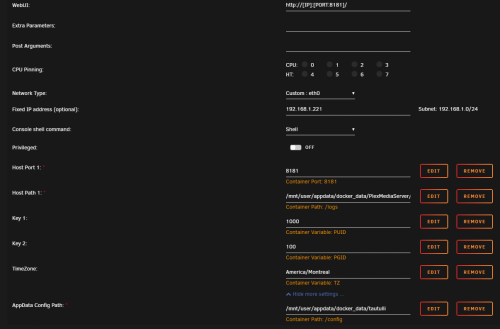

1 hour ago, Altheran said:
Hi all,
image.thumb.png.709278118ef26caa4c25000fef7e2a3a.pngimageproxy.php?img=&key=e5eec7c5c933ca16
[General]
http_basic_auth = 0
http_root = ""
http_proxy = 0
launch_browser = 1
enable_https = 0
api_enabled = 1
interface = default
http_port = 8181
From where are you browsing to tautulli? If it's from a VM on unraid, you will not manage to access it. It's a security feature in macvlan.
2 hours ago, Altheran said:
what your network settings?
Edited by sjaak
I'm browsing from my personal PC (192.168.1.165). Everything is on a regular LAN on 192.168.1.0/24
UNRAID server has a single ETH interface on 192.168.1.230
All my containers (Except UniFi controler and Krusader wich are on host) are on custom : eth0 networks. Each has a dedicated IP. They ALL work, except for Tautulli... Tautulli has 192.168.1.221.
I know about the MACVLAN stuf, wich is also why I didnt wrap my head around having a Wireguard server to remote manage my server / dockers ;) It is also why I have ALL my dockers on custom eth, so they can talk to each other.
Edited by Altheran
Took Enter as post instead of newline

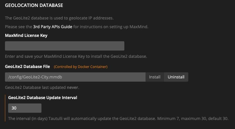

Why isn't Geolite2 working anymore?
