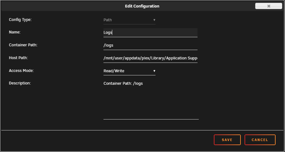

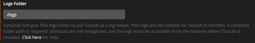

Could someone tell me how to read the log files from Plex in Tatulli?
I have set the path like this:
Path: /mnt/user/appdata/plex/Library/Application Support/Plex Media Server/Logs/
And in Tautulli
So any input to what's missing is much welcome
6 hours ago, casperse said:
Hi All,
I had this working before but not on Unraid :-)
And in Tautulli
I have the same settings, only i have the access mode set to read only (Tautulli don't need write access)

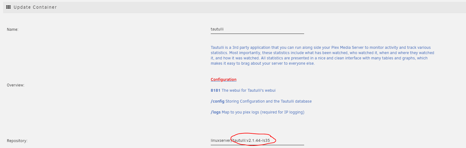

I was having this same issue, unable to open the history page, user page, etc. You can roll back to that last version that worked pretty easily by changing the docker image pulled.
In my case I'm using v2.1.44-ls35 which seems to be in a good state.
Rolling back to this version fixed my issues. I am able to see all data now. Thanks for that!

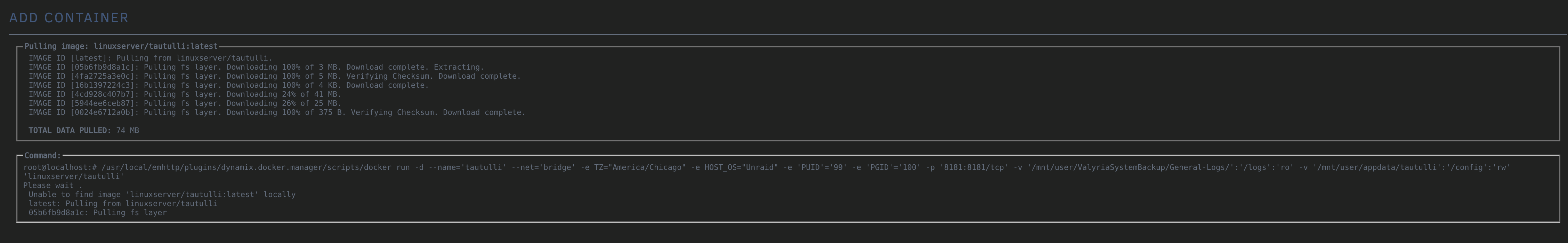

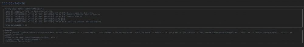

Anyone seen this before in the install?  you can see it didnt complete the PULL's in the top section.
Unable to find image 'linuxserver/tautulli:latest' locally
1760335716_ScreenShot2020-03-25at9_18_17AM.thumb.png.75c3184b185f6cc03d1b56f57566ca12.png
its been sitting at this screen for 5 minute, and not the Docker tab will not load
Edited by wesman
