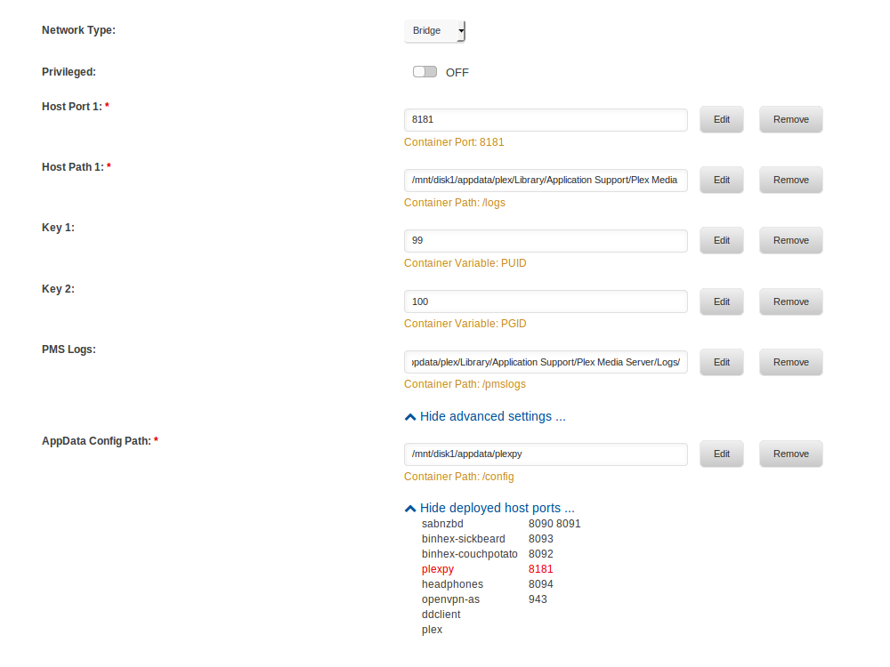

I found out that there was some trouble for getting the PlexMediaServer logs.
What i did to fix it: added a extra container path and called something else than /logs (i use now /pmslogs)
After i did this tweak and fill the right path in the config, Plexpy got the PMS logs and elso the external user statics are now working in the history view.
I dont know if more people got this problem?
just being using Plexpy for about 2 days.
Without actually posting what your port mappings are it's impossible to test, but nobody else has reported any problems,

well, PMS and Plexpy use almost the default settings. the only change what i did is change the /config path to 1 physic disk (not /mnt/user/ i use /mnt/disk1/ because its a ssd)
the rest are default settings. but with the upgrade from unraid 6.1.x to 6.2 some of my dockers got some trouble with permissions right, but thats here a little bit offtopic talk...
well, With the PlexMediaServer upgrade yesterday, Plexpy stops working. So because i just use Plexpy i decide to remove it complete and start fresh.
I don't know what i did wrong last, but now the logs files are working fine with the default setup
