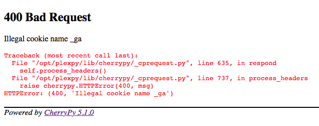

It was working nicely but I got this when I opened the Web page:
400 Bad Request
Illegal cookie name _ga
  File "/opt/plexpy/lib/cherrypy/_cprequest.py", line 635, in respond
    self.process_headers()
  File "/opt/plexpy/lib/cherrypy/_cprequest.py", line 737, in process_headers
    raise cherrypy.HTTPError(400, msg)
HTTPError: (400, 'Illegal cookie name _ga')
Powered by CherryPy 5.1.0
I deleted the appdata and the container and reinstalled. Log attached - seems normal. I still get the 400 error.
EDIT: I tried a different browser and I got the Welcome page of the Setup Wizard. So I went back to Safari and deleted the cookies it was storing from my server and it too came good.
Plexpy_Log.txt
Yeah cherry.py does that from time to time...

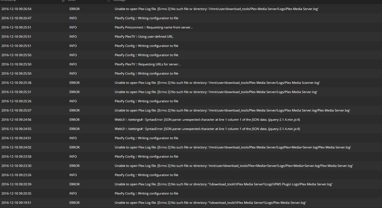

I'm having a really difficult time importing my Plex logs into plexpy.
I've tried multiple different formats and can confirm that the plex logs are all in the logs folder. I have a feeling I'm missing something really obvious here, can someone point me in the right direction?

Ah, I should have RTFM. Thank you.

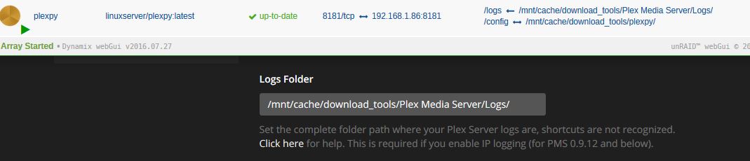

In the plexpy webui, I'm still getting the directory not found in the logs, even after a restart. I am using the binhex plex docker, could that make a difference?
You don't need to change anything in the plexpy webui.  just keep it as /logs and read the docker faq so you understand how folder mapping works.

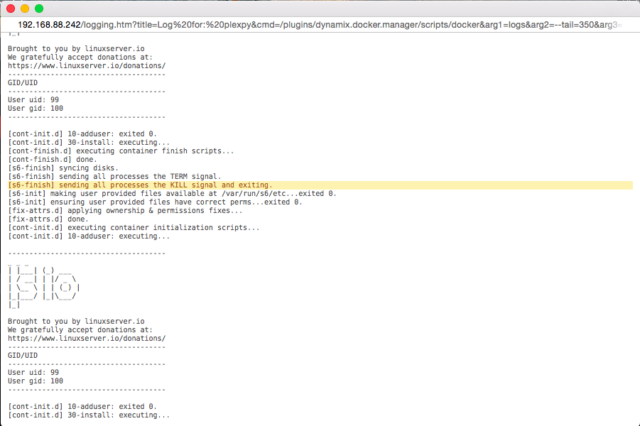

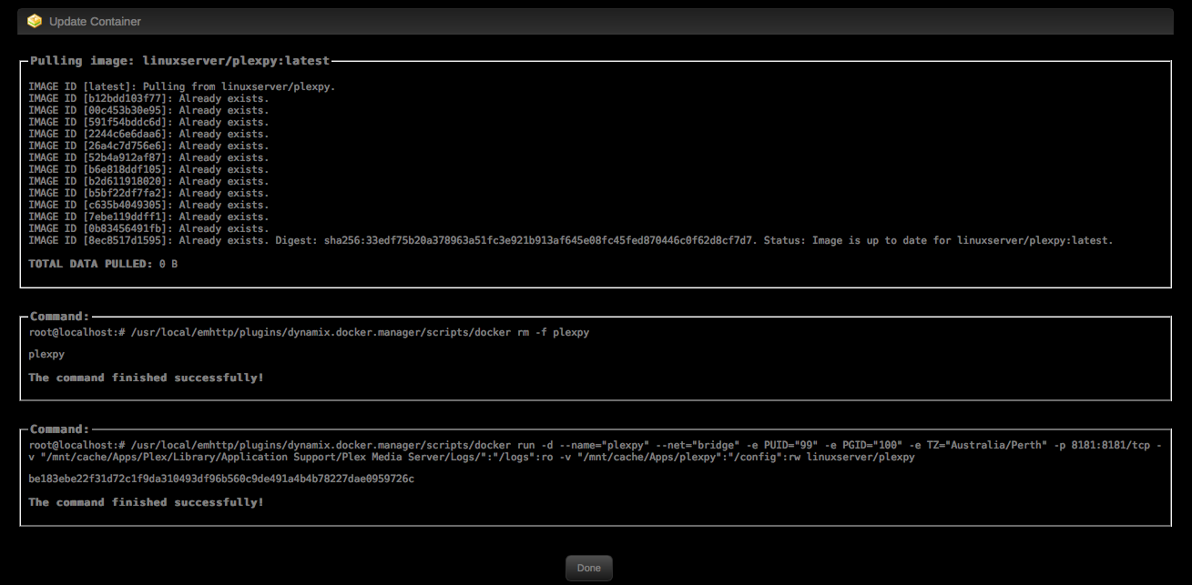

i having a problem starting plexpy after an update today. I went from approx version 1.4.15 or earlier to latest version 1.4.17. i've checked the plexpy startup logs and is stuck on 30-install: executing.
I ve tried remove image and reinstalling. I even thought updating plex might help but it didn't. Ive also tried restarting my server. And unsuccessfully specifying a specific version. It also looks like plexpy is not writing to its appdata folder as it is empty.
Ive added pics of the relevant info.
if you need any more i have my diagnostics.

Please disregard Everything
I thought i Would leave the app to install for ages.
took more than 10 minutes to finish executing
not what I'm used to when doing an update to a docker app
please forgive me for my impatience.
hope this help someone else.
very embarrassed, sorry.
