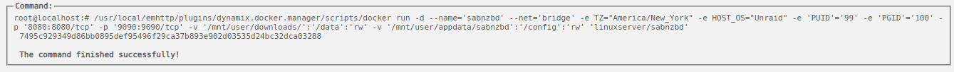

Here is my run command:
This is the log taken from the Docker tab in Unraid: log.txt
