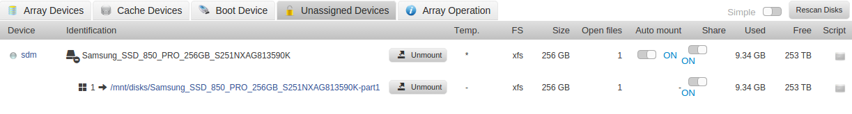

First off, thank you greatly for the linuxserver.io dockers, each of the ones I've enabled are able to start without much configuration whatsoever.
Although after running through this setup I have a quick question for the guru's about how I have my system setup with this docker.
System is running unraid 6.1.6 , SAB 0.8.0Beta3 [0b6395f], I've mapped the folders to a 256Gb SSD formatted with xfs I've mounted using unassigned devices outside of my array with some basic folder structure in the root (/SAB/downloads/ and /SAB/incomplete/ etc for example) to keep each docker separate for basic house keeping. According to Unassigned devices the SSD has a total used of 9.1GB out of the 256Gb (for some reason it's also reporting that it has 253Tb free which I'm guessing has more to do with how the drive is reporting to unassigned devices but that's another issue to track down at a later time)
My issue is that even when I've mapped the folders correctly, SAB is reporting only 7.1Gb free space, even though the SSD has more than that free. Is this something that I should be concerned with? I have yet to initiate a download but wanted to confirm if what SAB is reporting is the correct amount of free space for the download/temp folder.

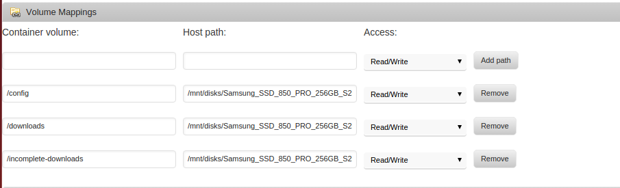

Hmmm, I don't use SABnzbd myself, but you're right that does sound a bit odd.  Can you post me screenshots of your SABNzbd mappings and your unassigned devices page with the disks expanded to show the partitions like this:
Here you go. Aside from the full mapping being shown that is. Naming is too long to show all at once with the drop down.
Should also mention that this does affect the ability to download files larger than the 7.1Gb that are showing as free.

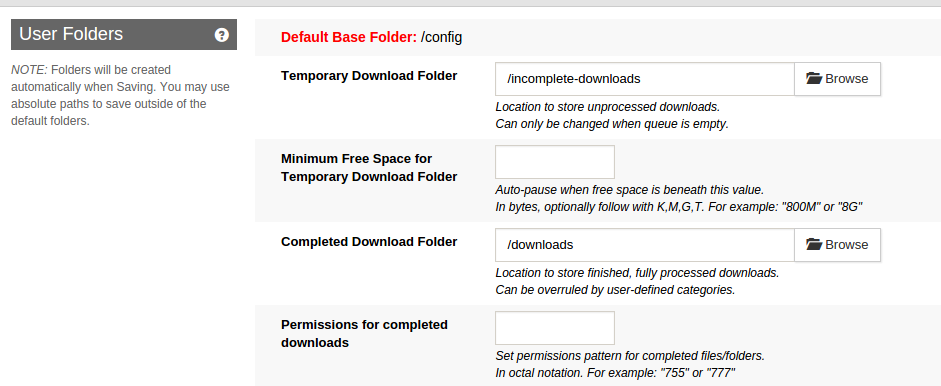

Ok that looks good, now can you post me a screenshot of your sabnzbd webui config where you've setup your download locations.  And do you have a 10GB docker image by any chance?

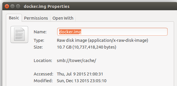

Yes I do have a 10.7Gb docker image, located on the cache drive of the array but it's cache only so it won't be moved.
So to recap, docker image is on the cache drive of my array, folders are mapped to folders outside of array. Would this be the issue? If so, is there a simple way to move the docker image from the cache drive to the unassigned drive as that's where I'll be keeping the additional folders.
Here's the details.
Another interesting situation occurred.
I stopped the array to see if there was a simple way to move the docker image which was no real help since docker can only be managed when the array is running but when I restarted the array the newly added dockers (Couchpotato, SAB and Sonarr) all reverted back to fresh installs. I'm assuming that is due to the /config folders being blank as they're all mapped to the same drive.
OK, I've installed sabnzbd on my machine and I can't reproduce this.
Essentially what is happening is that sabnzbd instead of using the paths you've set is downloading inside the docker.img one thought I've had is when you power on your machine, it could be that a race condition occurs so that docker service starts and sabnzbd starts before your SSD is mounted in Unassigned Devices.  As sabnzbd can't find the mappings you've set, it doesn't map them at all and leaves /downloads and /incomplete-downloads inside the container and therefore inside the docker.img...
This should be fixed by restarting the container, however if this is the case then the problem will start again on reboot as it will face the race conditions again..
I appreciate the detailed response, I'm pretty certain that I restarted the container with no change but I'll try again after work.
Yeah, I thought you may have, any chance the path in the docker mappings is wrong?  You know you can change that in Unassigned Devices to make it a little easier don't you? For instance I've changed my mapping to /mnt/virtualisation for my SSD.
