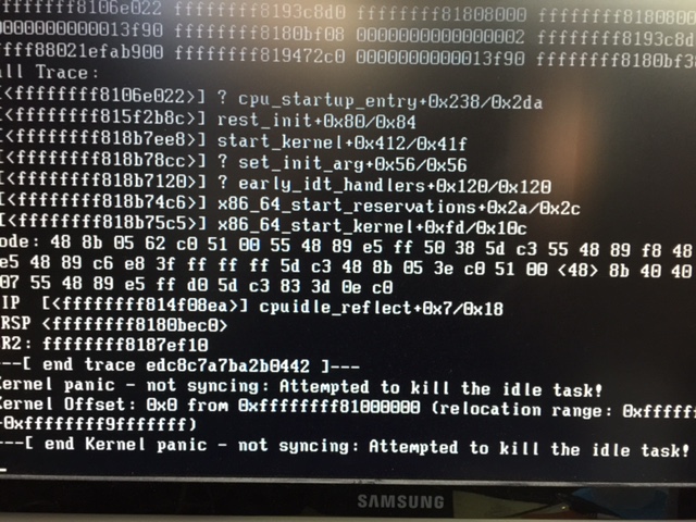

I have upgraded to 6.0.1 stable release. The server ran fine during the array startup and the parity check completed. This morning when I checked it, I got the same thing. The server is inaccessible via browser, and no response from keyboard input. I performed a hard shutdown via the power switch.
I am attaching a camera shot of the screen.

Alrighty. I loaded up a new flash drive following the upgrade instructions. I copied the ident.cfg, network.cfg, and share.cfg files to the new config folder. Note regarding the instructions versus what I have - There is no share subfolder under config. All .cfg files were in /config. There is a shares subfolder which contained all my share names with .cfg so I copied that folder over also.
I booted the machine, and in less than two minutes, I get the lockup dump ending with ---[ end Kernel panic - not syncing: Attempted to kill the idle task!

Today I turned on notifications and found a command timeout on my oldest drive, a 2Tb Seagate. I did a short smart test which passed. I also replaced the HDD cable because I found a reference to faulty cables causing command timeouts. I just fired the machine up, it ran for 30 minutes and got another kernel panic dump:
Are there any other signs to look for or tests to run? Any ideas? CPU, M/B? I can't imagine it is software at this point. I will probably order a new drive to replace the 2Tb...all my others are 3Tb.

HDD with Smart error replaced. Memtest ran for another 24 hours. Neither fixed the issue. Finally decided to replace MB/CPU. That did it!
