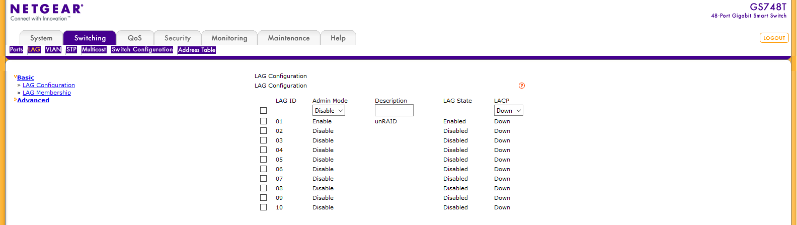

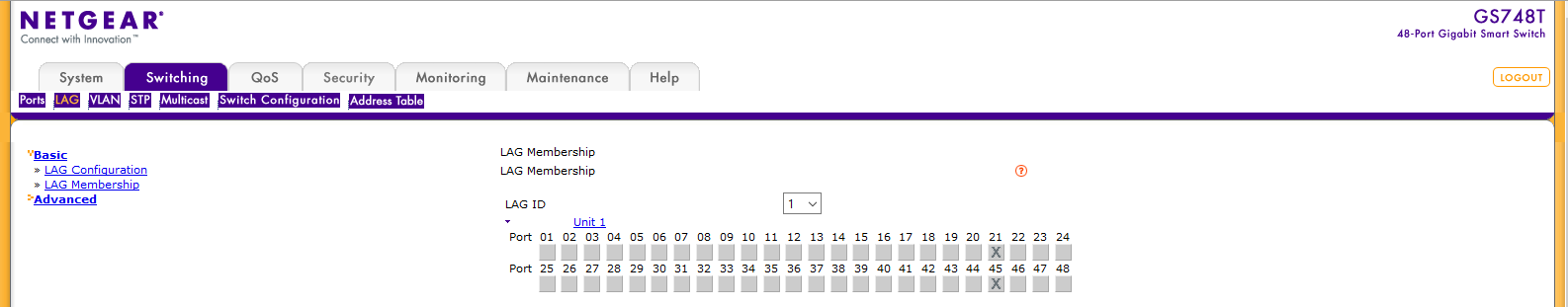

Its a netgear GS748T, and I have the 2 ports in what they call a LAG group - all other 46 ports are indv - I am 99.99% positive I have this set correctly as when I didnt and plugged in the 2nd network cable - the whole network came to a stop and I could see the looping happening.  Unplug the 2nd cable and the network could come back to normal.
Both cables plugged in right now and network performance is as expected except for the br0 message.  I needed to set the br0 so my 2 VMs would get independent ips from my dhcp server.
I am watching the switch monitoring interface and there are no errors anywhere happening on the network....
So I am still not sure where to look for this error.

Here are the two router config screen and how they are setup
Myk

If your switch supports link aggregation with LACP then I would advice to use mode 802.3ad (4) on your unRAID system. This has the advantage that an active protocol monitors the links in the bundle and any change would be automatically detected at both ends, keeping them in sync.
Changing to 802.3ad stopped the br0 messages
Thanks!
