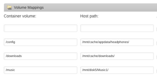

Why can't I get it to find my music?  What path should I put in headphones under the "Manage" tab in "Path to directory"
/music
assuming your music is actually in the path you've mapped to it. (/mnt/disk5/Music1)
thanks that worked.  Slowly understanding how dockers work

/downloads >  /mnt/user/downloads/music/
In headphones
in Download settings
I enable deluge
Move When Completed      >      /downloads
Music Download Directory  >      /downloads
in Quality & Post Processing
Destination Directory      >          /music
In Manage
Path to directory            >          /music
In deluge
i set music label when complete  >  /downloads/music
The problem when download finish headphones cant Post Processing
What mistake i did ?
Well I don't use either but I'm guessing it's something to do with deluge is still accessing the files in /downloads so headphones can't move them to /music Also where is /downloads mapped to on deluge?
I don't use torrents so I can't be of any more help. Sorry.
You're setting deluge to move the files to /downloads/music yet headphones I'm guessing wants to move them to /music  Conflict of interests..
