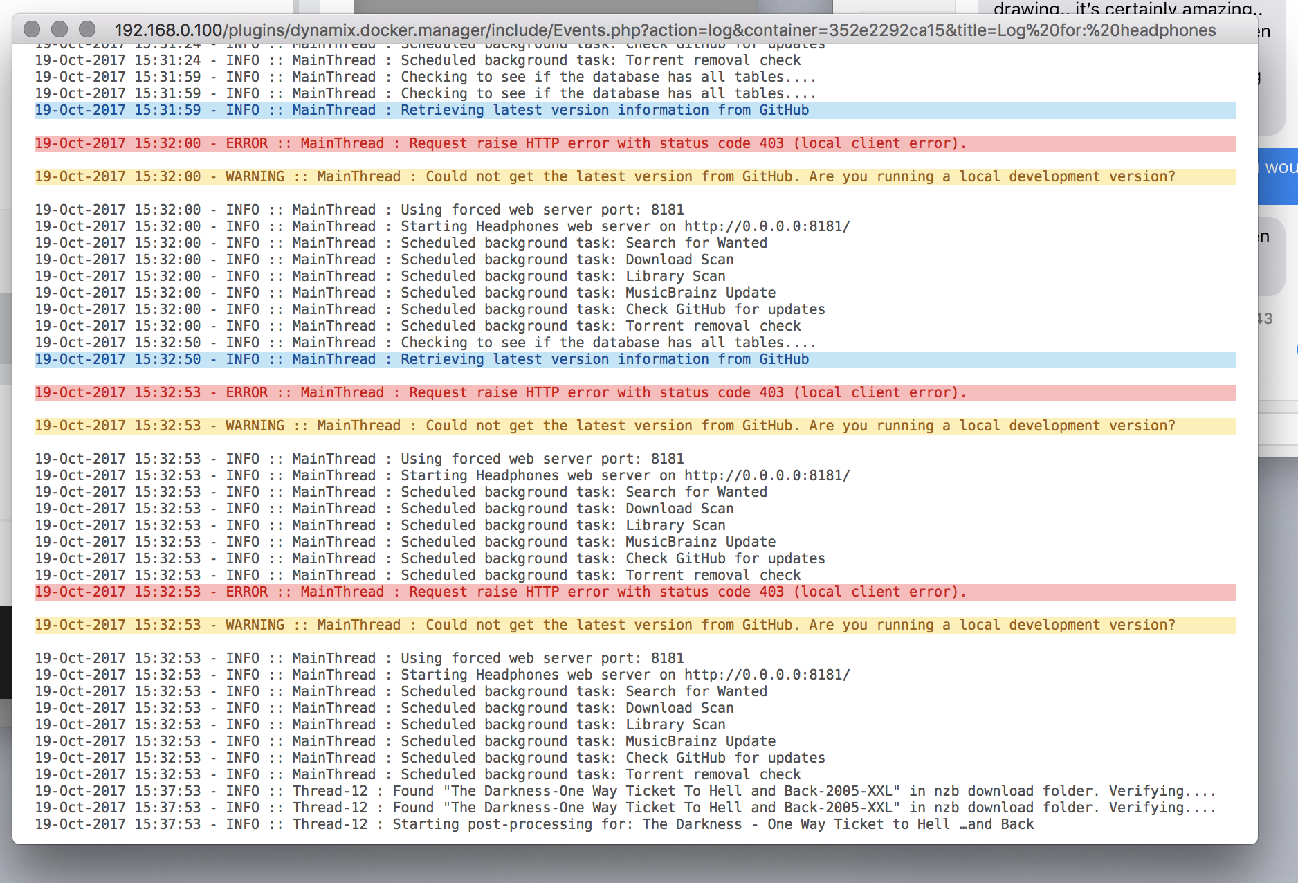

any progress on the segfaulting?
[edit] is there anyway to disable to the image loading to atleast work around the segfaulting?
[EDIT] OMG it's fixed!  thank you to whoever was responsible for the latest update :-*
.... spoke too soon, just segfaulted.. although it seems much improved, as i was able to add 2 artists and have all albums and artwork download quickly.

So anyone got any news on Headphones restarting constantly, I see the has been on going without a solution ?
I don't think it's supported any longer.  It does kind of function but adding new artists will cause it to crash and restart over and over. Once you get past the 5 minutes of crashing it will search and download music fine.

Don't get me wrong.. it does kind of work, but it also crashes repeatedly. It used to work brilliantly, not so much these days:(
Edited by reggierat
Latest docker update seems to have resolved the issues, headphones is running pretty well now.
