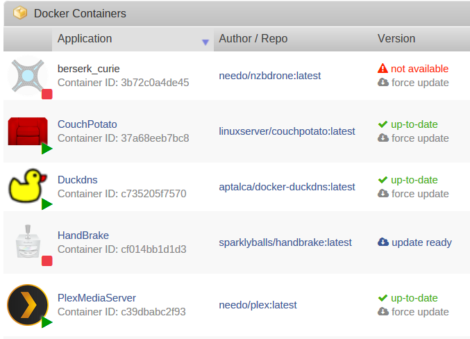

August 27, 201511 yr So I woke up to to my Sonarr (NEEDO) docker no longer working. The Sonarr webpage loads, but nothing from the database is pulled (basically a blank screen with the Sonarr background). Given the errors I am seeing I figure this is not related to the container and Sonarr was just the first casualty. My first attempt was to restart Sonarr. This did not help and the Sonarr log is showing SQL "disk is full" errors. Log (errors at the bottom): http://pastebin.com/smPYAbv4 I then tried reinstalling the docker and pointing to the same mappings as my existing setup to keep my configuration. This gave more disk is full errors: http://pastebin.com/VgHQYfHS This also appears at the bottom of the update page: Warning: file_put_contents(): Only 0 of 4 bytes written, possibly out of free disk space in /usr/local/emhttp/plugins/dynamix.docker.manager/dockerClient.php on line 297 Warning: file_put_contents(): Only 0 of 24 bytes written, possibly out of free disk space in /usr/local/emhttp/plugins/dynamix.docker.manager/dockerClient.php on line 453 I then thought that my docker image, which is set at 10GB was full. Assuming I am reading the docker settings page correctly I still have plenty of space: Label: none uuid: 7216ff55-ac0b-4da2-86ed-f17424d2b442 Total devices 1 FS bytes used 8.30GiB devid 1 size 10.00GiB used 10.00GiB path /dev/loop0 btrfs-progs v4.0.1 I am using my cache disk for the docker image and it currently has 43GB free. Last night is was down to 1.2GB but I'm assuming that should not have caused the issue. I also updated from 6.0 -> 6.01, rebooted and the problem continues. The container's name now says "berserk_curie", which is mildly entertaining (see attachment). Does anyone have an idea on how to fix my berserk curie?

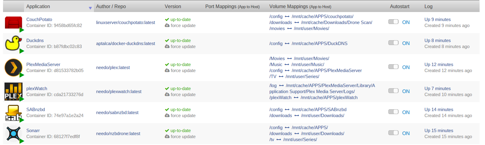

August 29, 201511 yr Author Thanks for the help everyone and sorry for the slow reply on getting back to this thread. I checked through all my mappings and could not find any incorrect mappings. I decided to go for broke and deleted my docker image and started from scratch. Everything now works and my data usage looks like this: Label: none uuid: 83fdbf07-310a-4331-b6ca-41461ab16872 Total devices 1 FS bytes used 1.94GiB devid 1 size 10.00GiB used 4.04GiB path /dev/loop0 btrfs-progs v4.0.1 Much better than the 10GB/10GB and 8.3GB file system usage from my original post. I wish I knew what caused this, but I guess after 6 months of continual docker usage maybe this is to be expected..... I am attaching a screenshot of my mappings if someone wants to take a quick look to see if something stands out. Thanks
August 30, 201511 yr Thanks for the help everyone and sorry for the slow reply on getting back to this thread. I checked through all my mappings and could not find any incorrect mappings. I decided to go for broke and deleted my docker image and started from scratch. Everything now works and my data usage looks like this: Label: none uuid: 83fdbf07-310a-4331-b6ca-41461ab16872 Total devices 1 FS bytes used 1.94GiB devid 1 size 10.00GiB used 4.04GiB path /dev/loop0 btrfs-progs v4.0.1 Much better than the 10GB/10GB and 8.3GB file system usage from my original post. I wish I knew what caused this, but I guess after 6 months of continual docker usage maybe this is to be expected..... I am attaching a screenshot of my mappings if someone wants to take a quick look to see if something stands out. Thanks Your mappings looks ok but you must also make sure the settings in each Docker app are ok. These settings are individual for each app (and might not be needed in all apps) and I don’t have all the apps you are using but for example in Deluge you need to set the download location to /downloads in the app itself (in the GUI) as well if you have the Volume Mappings /downloads <--> /mnt/cache/APPS/Downloads . Also it looks like the latest version of Plex (0.9.12.11) is giving some users problems. It looks like when Plex is playing a video it is storing temporary data in the Container. This data is deleted after when you stop playing but look out for this as well because if the Docker.img gets full you will have a crash.
