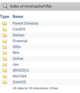

Don't know that it matters.  How mine is setup is attached as well as the shares I have setup.
Basically I have a folder where I store all of my ISOs.  Then for each VM I have a folder where I store the image files.  I did it this way because that is how Virtual Box (what I started with on a Windows Host) did it.  Also I thought if logs existed separately for each VM I might be better keeping them there.  Don't know if that is possible with unRAID haven't read much about KVM set mine up with prior experience on Virtual Box as I said.
I see... So you have a VM share on the cache disk and you contain all your VMs and ISOs there? I don't currently have a cache drive and don't really need one other than to put the VM installs on so they have quicker/read write. This is what I was thinking about using the 2.5" laptop drive for. Installing the drive and using it exclusively as a cache drive for the VMs, but not for any media transfer. I'm quite content with the setup I have for media transfer.
I don't use the cache drive as a cache drive either.  All array shares write straight to the array.
