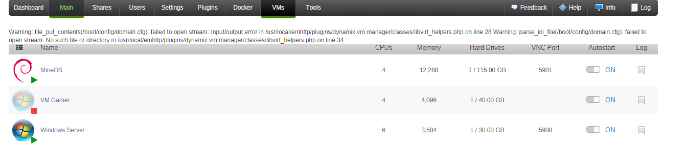

And I had not noticed, but a line at the top of my VM page as follows:
"Warning: file_put_contents(/boot/config/domain.cfg): failed to open stream: Input/output error in /usr/local/emhttp/plugins/dynamix.vm.manager/classes/libvirt_helpers.php on line 28 Warning: parse_ini_file(/boot/config/domain.cfg): failed to open stream: No such file or directory in /usr/local/emhttp/plugins/dynamix.vm.manager/classes/libvirt_helpers.php on line 34"

Image attached.
