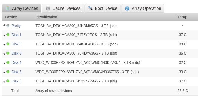

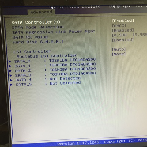

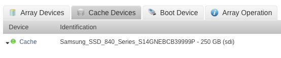

unRAID is booting and fully functional but I recognized some strange behavior: BIOS is only showing 4 out of 5 Toshiba drives. One Toshiba drive, the two WD RED's and the Samsung SSD cache drive are hidden. However, unRAID is showing all drives.

  • I connected the backplane to #13 & #15 (see manual pg. 6/7). It seems that LSI controller is attached to #15 & #21 and the mobo ports to #13 and the two blue SATA ports. Can anyone confirm?
  • I have NOT flashed the LSI controller

Sounds like it may be "picky" on memory ... although it's also possible it just wasn't seated securely and removing it and replacing it did the trick.
Not sure why all your drives aren't showing in the BIOS ... are they by chance shown in two different locations based on which controller they're connected to ?

Man, I know this board inside and out. A. It doesn't matter that you have no video on the xeon chip, as the board has an asmedia vga chip. You need to flash the lsi firmware to whatever latest, non-raid. I don't know if I'm confusing this board with the c2550 but one of the two has storage shit in two different places, one on the main settings menu, then a few tabs over there is an Intel North and South Bridge menus, one of them has more storage info. I've also had the "Loading" error, but only after updating FW and Baseband, then not letting it "settle" also, remember that one of the SAS plugs (the one closest to the USB plug inside) is Sata only, along with the two ports on the board. In a previous build I had 8x 4TB Reds in the Sleds on the SAS Ports (SAS works with Sata but not the other way), plus another 4 SSDs in the 2.5 cage, I wasn't using the pci at the moment, so I hung my 450 Sfx sideways with thumbscrews. Lol. But seriously, I raged out and used implements of mass destruction on my first DS380, the SATA plugs and Capacitors will literally fall off that stupid backplane. ONLY use Sata cables that have the "clips" for unplugging them or you are in for a real treat. And I never will figure out why they made that stupid thing with Dual Channel SAS connections on it, as they were very rarely used on anything.
