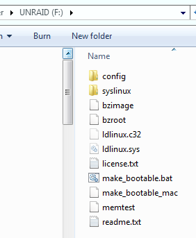

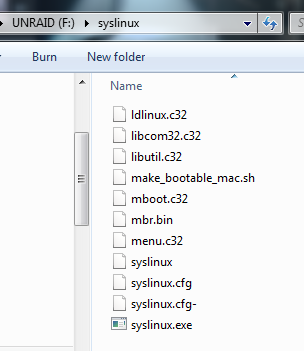

Can you show us the contents of the root folder of your flash drive, and the contents of the config and syslinux folders?

Please find attached snapshots of the content (with some old *.cfg )
syslinux
config
