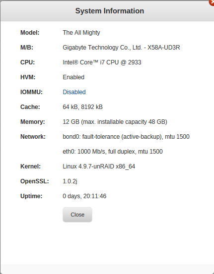

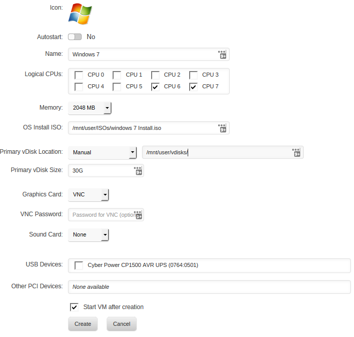

Hello I'm also trying to create a windows 7 VM running unraid 6.3.0. I'm also getting the message "unable to open /dev/net/tun, is tun module loaded?: No such file or directoy" I'm using the template wizard under the vm tab to create by VM.  What do I need to do to get the TUN module loaded?  I have also uploaded my diagnostics file for your reference.
Thanks for taking the time.  Unraid has been a life saver.
