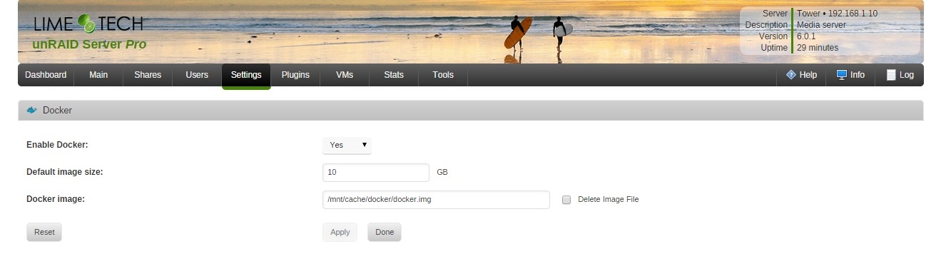

September 6, 201511 yr Author Yeah so I looked at each of those folders and none of them are Plex. It appears the orphan is hiding some place else. I guess thats why its orphaned. Are you meaning I should delete the /mnt/cache/docker/docker.img won't that delete all my containers? I decided to try to stop and start Docker from the gui and the syslog output this: Sep 5 22:04:12 Tower php: /usr/local/emhttp/plugins/dynamix.docker.manager/event/stopping_svcs Sep 5 22:04:12 Tower php: Stopping Docker... Sep 5 22:04:12 Tower logger: stopping docker ... Sep 5 22:04:12 Tower logger: unmounting docker loopback Sep 5 22:04:18 Tower emhttp: /usr/bin/tail -n 42 -f /var/log/syslog 2>&1 Sep 5 22:04:33 Tower php: /usr/local/emhttp/plugins/dynamix.docker.manager/event/started;/usr/local/emhttp/plugins/dynamix.docker.manager/dockerupdate.php Sep 5 22:04:33 Tower php: Starting Docker... Sep 5 22:04:33 Tower logger: starting docker ... Sep 5 22:04:46 Tower php: Updating templates... Updating info... Sep 5 22:04:46 Tower php: Warning: stream_socket_client(): unable to connect to unix:///var/run/docker.sock (No such file or directory) in /usr/local/emhttp/plugins/dynamix.docker.manager/dockerClient.php on line 505 Sep 5 22:04:46 Tower php: Couldn't create socket: [2] No such file or directory Done. Sep 5 22:04:51 Tower emhttp: /usr/bin/tail -n 42 -f /var/log/syslog 2>&1
September 6, 201511 yr From that snippet, it would appear to me (could however be wrong) that there is some corruption in the image. You can try running a scrub from the docker settings page. Yes you are correct that my suggestion of deleting the img also deletes the containers. But, the great thing about docker is that as long as you add the container back via the user-templates (the my* templates on the add-container page), and have set up the config folders to be stored in something like /mnt/cache/appdata (ie: outside the docker.img), as soon as the container finishes downloading, its back exactly the same way it was before. All of your tv shows are already scanned, etc. It also wouldn't hurt to upgrade to 6.1, since you are still on 6.0.1 (unless there is still a plugin you require that's incompatible with 6.1) - But that has nothing to do with this issue
