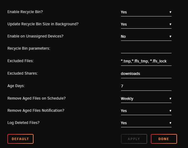

I seem to have an issue where the deleted files log no longer works.
This issue seems to have started some time around July.
On two separate Unraid systems, despite the "Log Deleted Files" flag being enabled, it no longer tracks them.
When I delete a file, it correctly ends up in the recycle bin. But upon clicking "empty trash" or waiting for the automated schedule to execute, it no longer shows an
Jul 19 02:26:13  unlink => xyz

The log entry is only when the file is initially deleted, not when it is removed from the recycle bin.
On 10/1/2020 at 10:13 AM, Spiritreader said:
Oh sorry I got that confused.
Still, no log entries show up unfortunately.
My workflow is as follows.
- Delete file from SMB share
- check recycle bin, no entry
Deleting file from smb share
https://i.imgur.com/JGgu0Q4.png
Shows up in recycle bin when clicking on inspect
https://i.imgur.com/HYj8MeT.png
No delete log entry
https://i.imgur.com/gInWpzH.png
If you post diagnostics, we can help further.  I have no issues with the logging.

3 hours ago, dlandon said:
Restart the recycle bin.
I've tried the following:
- stop and restart the recycle bin
- toggle logging off and on while the recycle bin is started
- stop recycle bin, toggle logging off and on, start the recycle bin.
No change, still not logging.
