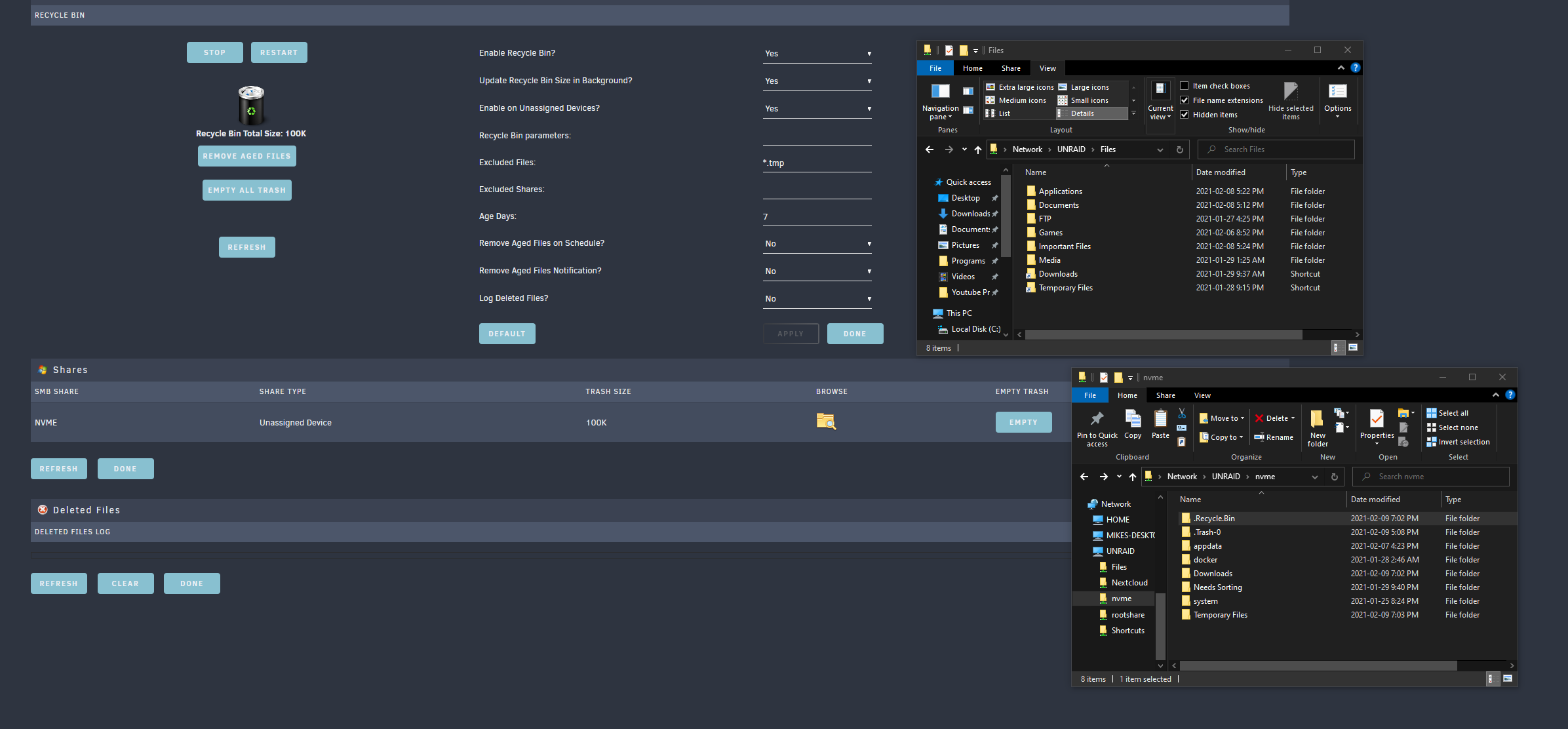

I have installed this plugin but it does not add a .recycle bin to any of my Unraid shares.  It only adds it to my Unassigned drive share (Which I also want).  Is there something I need to configure?  See screenshot below on how my "files share" (Which is on the array) does not get a .recycle.bin when my "NVME" share (Which is on an unassigned drive) does.  Ive also tested deleting a file from the array and it does not appear goto this recycle bin plugin.

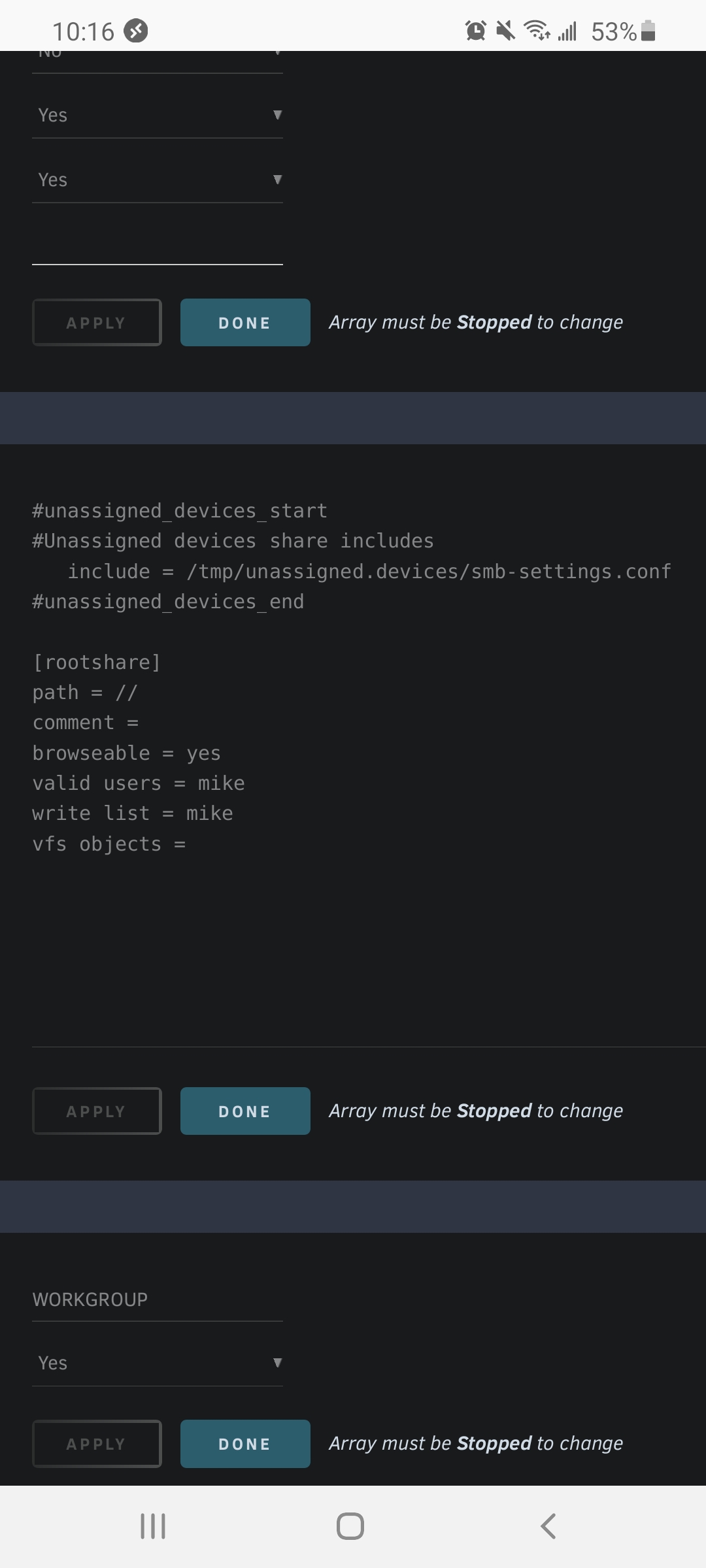

I'm deleting files from my windows machine.  So yes SMB share.  In this particular case its the "files" smb share.  Located at \\unraid\files (which is actually /mnt/user/files on the unraod machine.
Here's a picture of the smb extra settings if it helps.  Im not sure if this plugin has an intent to add anything extra to it?
Edited by 007craft

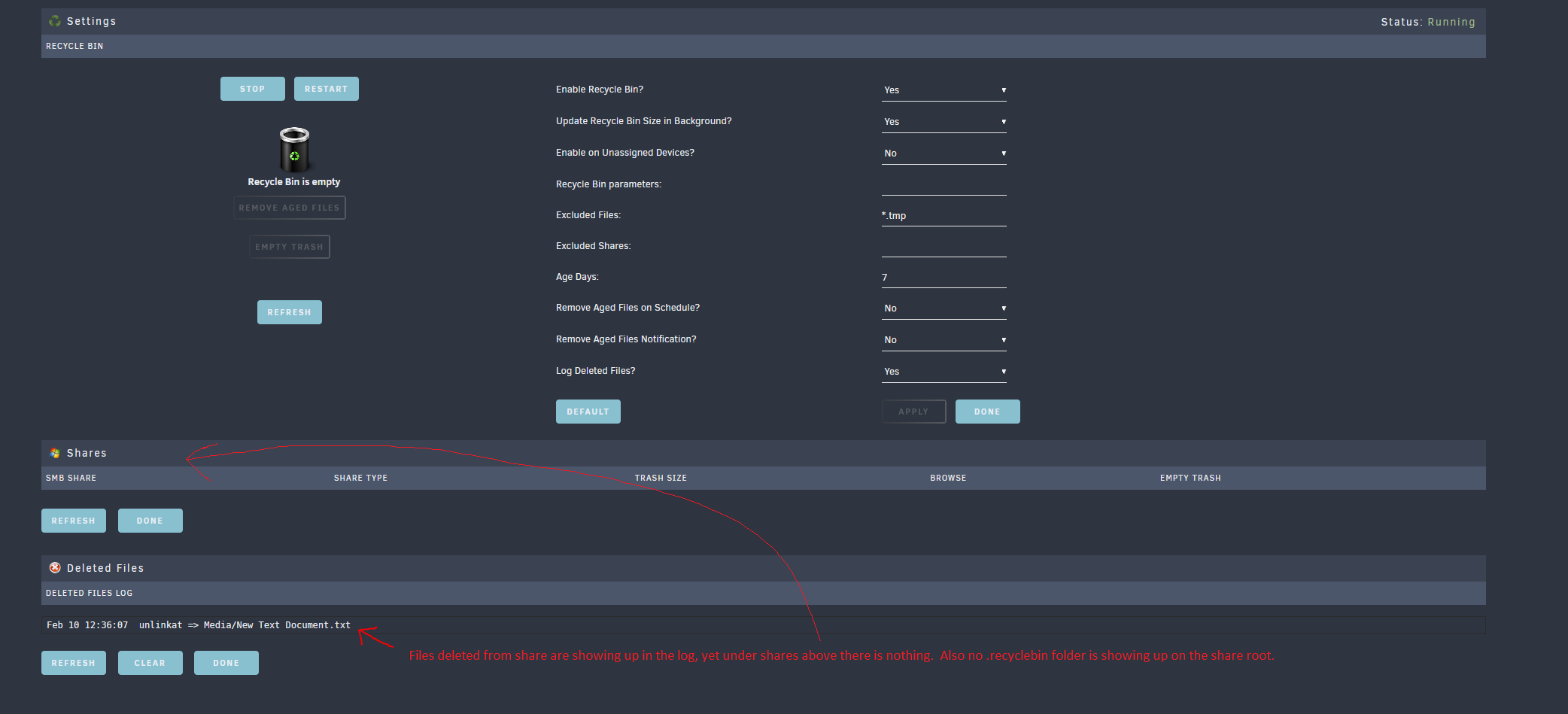

After trying to troubleshoot my Issue with recycle bin not working on non unassigned drives I reinstalled the plkugin but this time payed attention to the process.  I get this exact same error.  Looks like the plugin is failing to update the contents of the sbm-extra.conf file, thus it wont work with any unraid Samba shares.  So looks like the plugin is currently broken.  Can somebody advise a fix?
If I turn on file deletion logging, that will even detect files being deleted from share, yet still no share or recycle object shows up (see screenshot)
It looks like you have manually changed some things in the smb extra file.  Yes, the recycle bin makes some changes to the smb extra file.  Please remove the lines from [rootshare] on, then remove and re-install the recycle bin plugin.
The line 'vfs objects=' is probably removing the vfs recycle bin.
I've updated the plugin.  Stop the recycle bin, update the plugin, then re-start the recycle bin.

Thanks I reinstalled the plugin with the new updated version and now my SMB extras file is populated with:
#vfs_recycle_start
#Recycle bin configuration
[global]
   syslog only = No
   syslog = 0
   logging = 0
   log level = 0 vfs:0
#vfs_recycle_end
I also went ahead and removed the "vfs objects=" line.
It seems to be working now.  Thanks!  I guess the only thing I noticed not working is if I make a new file, and delete it right away, it doesnt show up in the recycle bin.  I'm assuming thats because when I make a new file its actually making it on cache and files on cache wouldnt goto the bin.  So the plugin works, as long as the file has had its chance to be moved over by mover.
