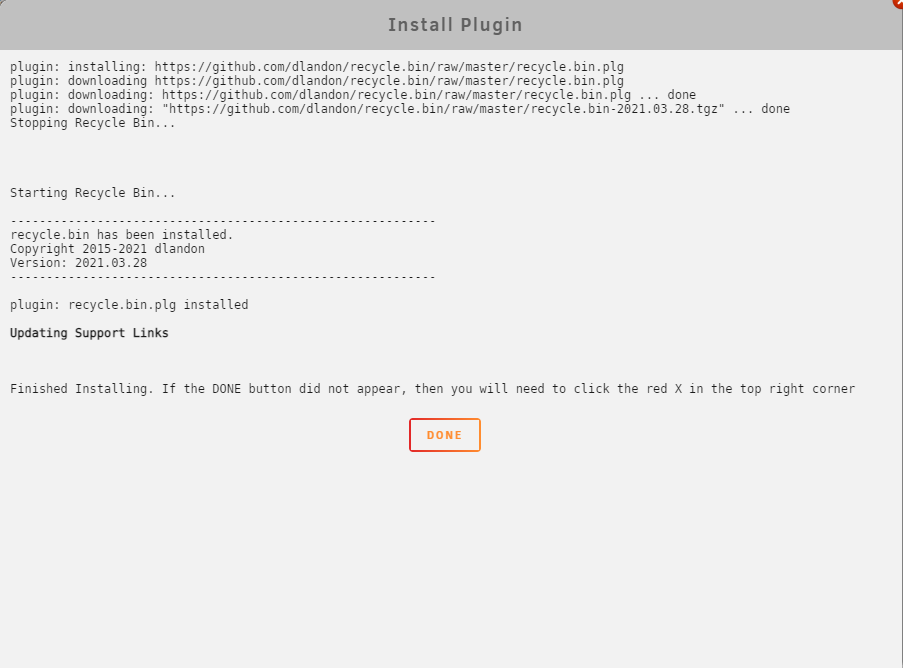

Hello Together,

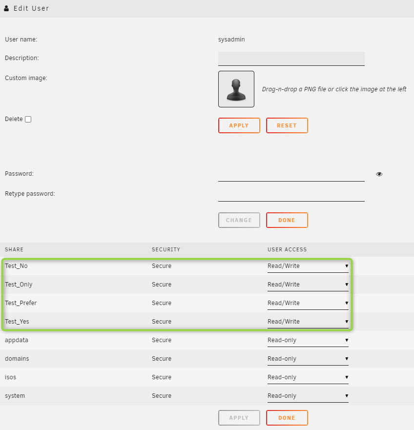

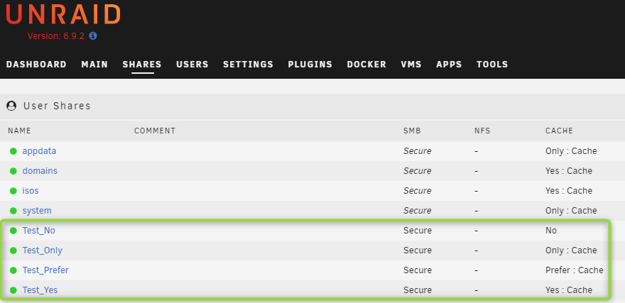

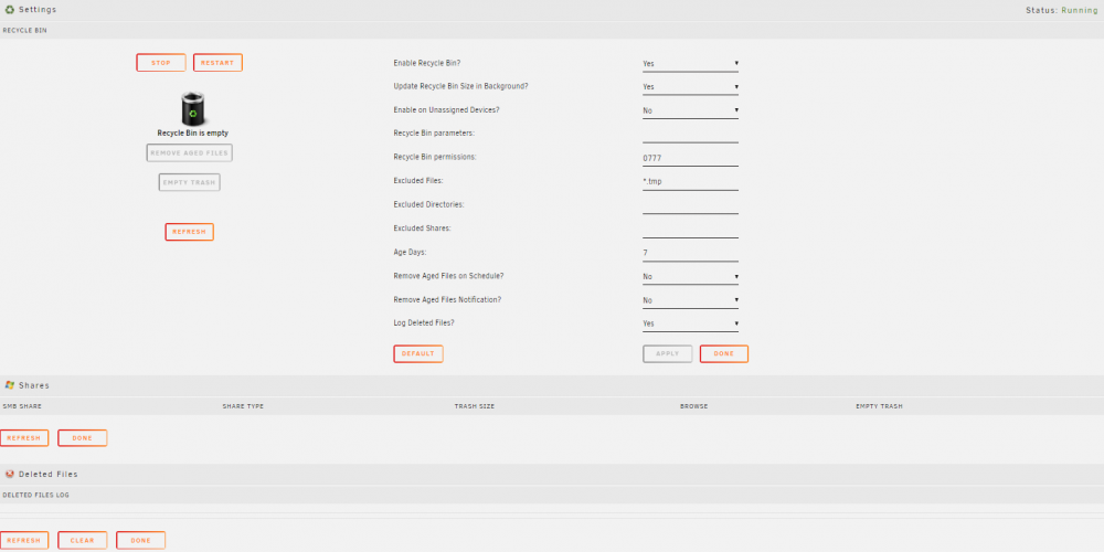

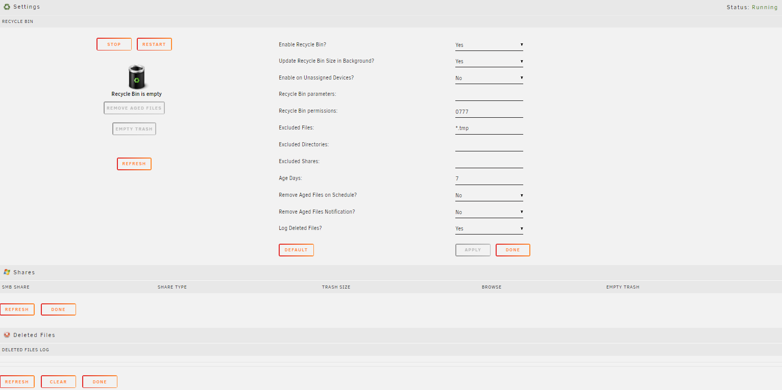

I have a small problem, I did the installation of the plugin, only unfortunately it does not recognize shares.
I have uninstalled the plugin, reinstalled, tested an older version (did not work), set up Unraid again, created shares in different ways (Cache Only, Yes, No, Prefer).
All shares do not have a .Recycle.Bin, they are not shown to me via SMB or via SSH. I also tested it with WinSCP...
I know it worked once though, because on an older test server, I already had this plugin installed.
And before someone asks 🙂 Yes I did a reboot 🙂
Any advices?
Thanks for your help!
Here some screenshots.

Did you actually delete anything over the network (SMB)?
Oh man, you just can't imagine how much I want to hide now and be ashamed for the next few years!
You are my hero!
Sorry for my post! 😂

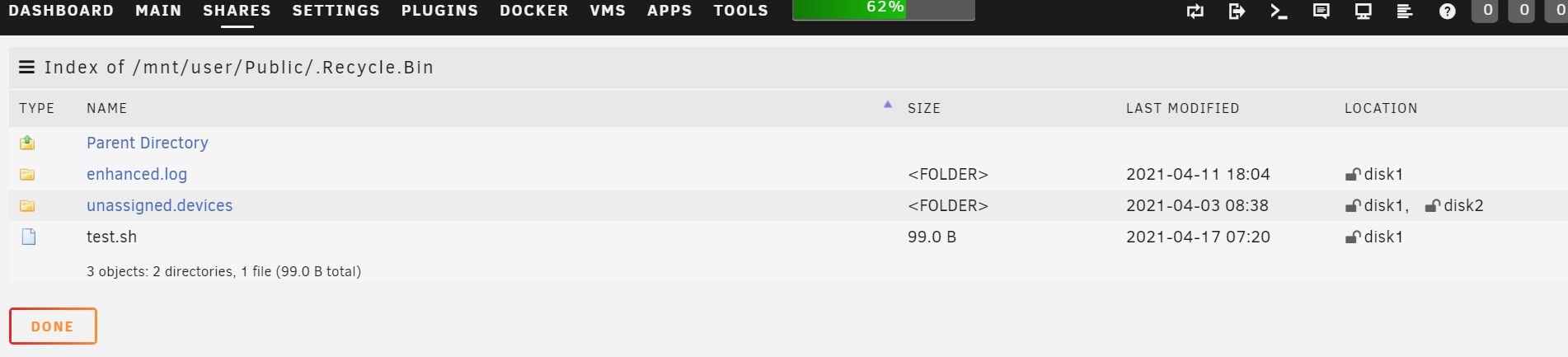

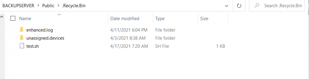

You go to the recycle bin by browsing to it: //tower/share/.Recycle.Bin.
