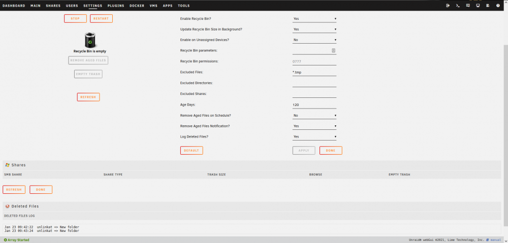

HAIL!
I'm getting a similar issue, UnRAID 6.9.2 with the latest update of Recycle Bin installed but .Recycle.Bin isn't appearing when I delete a test file on either of my shares -- though they do appear in the log [screenshot below]. I did, for a brief moment, have one share show up in the SMB shares... but lost it when I reinstalled the plugin in an attempt to get my other share to appear.
No idea if it's a bug or me being a dingus, but I'm hitting a brick wall on what it could be at the moment.
Current troubleshooting steps:
> Stop/Start Array.
> Server Reboot.
> Uninstall/Reinstall of Plugin.
> Multiple folder/file deletes (after each of the above).
> Creation of a new share (just incase it was a bug with the pre-existing share). '.Recycle.Bin' still refused to spawn.
> Staring into the abyss trying to work out what I could possible be doing wrong here.
> Enabling 'Unassigned Devices' -- followed by a test then revert when it didn't help.
> Triple cheking settings for Recycle Bin, SMB Shares, and the shares -- all appear to be in order.
> Manually ran 'Move' in a hope that it may trigger somthing -- it didn't.
Several points:
  • You are aware that the recycle bin only shows files deleted from SMB shares?  Using mover or deleting then from a command line won't show them in the recyce bin.
  • The .Recycle.Bin folder is a hidden file in SMB shares unless you've turned off 'Hide "dot" files:' in Settings->SMB.
  • It can take up to several minutes for the Recycle Bin page to actually show deleted files in your shares because of the background update.  The physical .Recycle.Bin folder will be in your share immediately.
  • Zero length files are not put in the recycle bin.
  • Empty folders aren't save in the recycle bin.
I think you're trying too hard and need to have a little patience to let the recycle bin to work,
