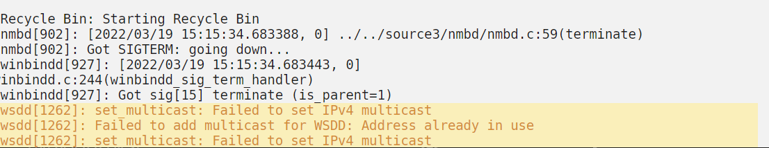

have some error or warning after stopped and started again the plugin
The recycle bin restarts samba.  Those are from wsdd restarting.
What is meaned ?
What is meaned ?
wsdd is reatarted when samba is restarted by the recycle bin.  It is not the recycle bin creating those log entries.
