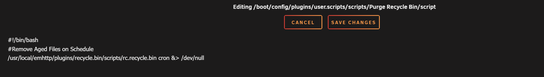

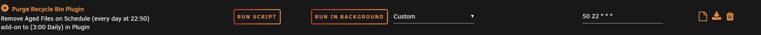

On 3/15/2022 at 12:03 AM, dlandon said:
Set up a User Script to run on a cron for the time you want and run this command:
/usr/local/emhttp/plugins/recycle.bin/scripts/rc.recycle.bin cron &> /dev/null
i made a user script on 22:50 and its not working , i mean the script is runned by log but not delete old files only working when im running the script from user scipt menu in settings by manual pressing run script or run in backround.
Maybe you can help on it ?
if im not tuching/changing the permission option, its by default 0777 right?
image.thumb.png.c80dce71874249b99e44f0a33254e221.pngimage.thumb.png.0af0c7c4c679a3a5bf705167ad4043d8.png
Sounds like the User Script cron is not set up right.
Strange i can see its running on log ,but folders in /mnt/RecycleBin/User Shares/my share1/Directory1 is still exist ...
Edited by Masterwishx

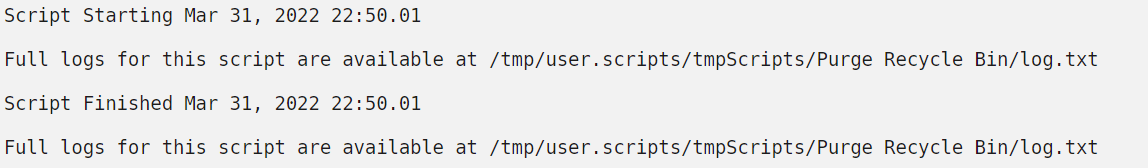

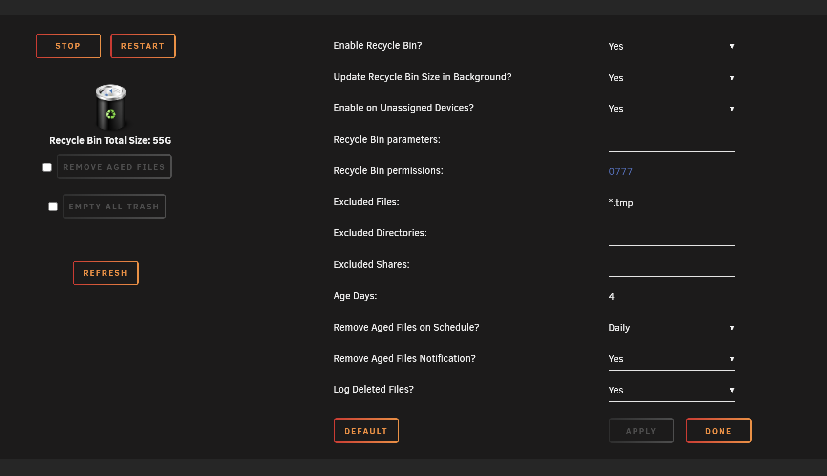

Also on this user script log:

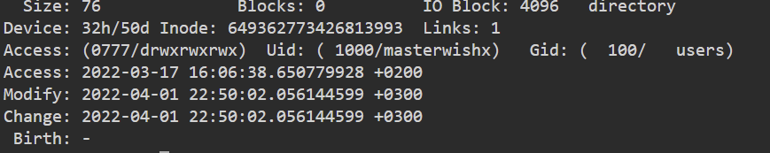

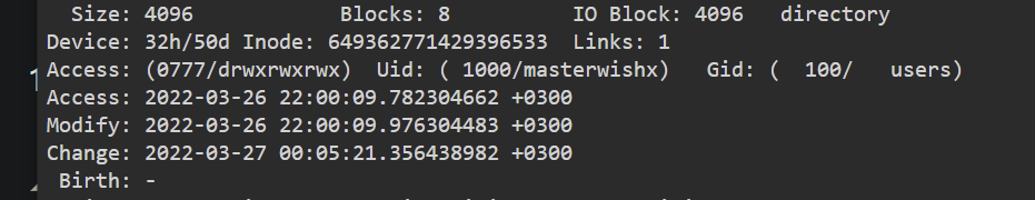

The recycle bin files are not aged by last modified (mtime).  They are aged by the atime.

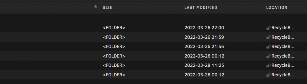

OK Thanks i got it , then i checked by stat command i can see same time of atime and mtime ...
we talking about folders in /mnt/RecycleBin/User Shares/my share1/Directory lvl1 ,
like  /mnt/RecycleBin/User Shares/my share1/Directory lvl1/Directory lvl2_1
       /mnt/RecycleBin/User Shares/my share1/Directory lvl1/Directory lvl2_2
       /mnt/RecycleBin/User Shares/my share1/Directory lvl1/Directory lvl2_3
Also strange that they deleting from manual script run , checkd also auto run in 3:00 also not delete the directorys

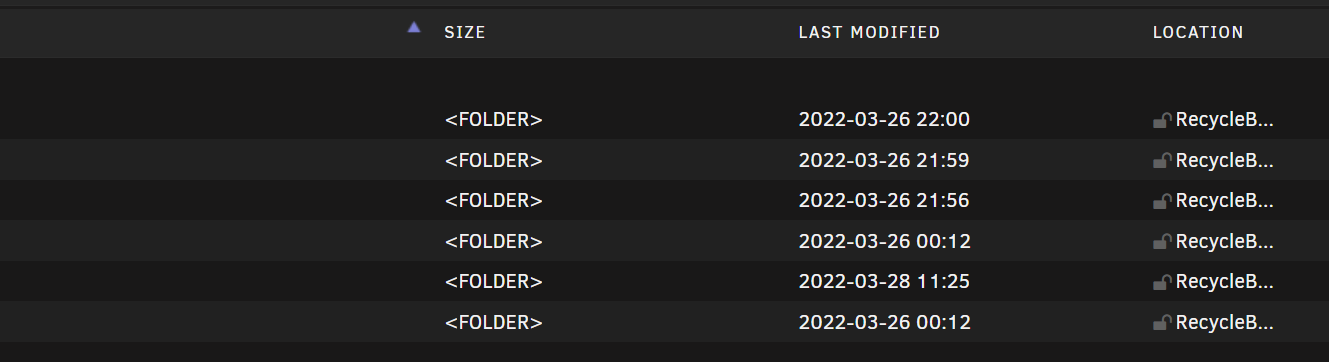

21 hours ago, dlandon said:
Looking into this.
Today checked , and its deleted ...
the plugin check folders aged by the atime in smb share only Directory lvl1 or also Directory lvl2 ?
example /mnt/RecycleBin/User Shares/my share1/Directory lvl1/Directory lvl2_1
The Recycle Bin plugin uses the following command to find aged files:
find /mnt/RecycleBin/User\ Shares/*/* -type f -atime +4
Run this command and see what comes up as aged files.  These are the files that are deleted.
I'm not seeing anything yet, but I'm still checking.

Strange but Somehow yesterday almost all folders deleted by the user script in 22:50 (but cant see what files is deleted in the log of script ) only one folder is avalible and its all files is listed after running your posted  (find ..... ) command and its by stat command:
The log of deleted files are files deleted in the shares, not files deleted from the Recycle.Bin folder by the plugin command.
I am testing one thing I don't like in the script, but I'm not sure it is affecting the removal of aged files.
The aged files are determined by the 'find' command, not what 'stat' shows.  The age days of 4 would I think be files that are over 4 days old, not exactly 4 days old.
I think you might be over analyzing this.

On 4/2/2022 at 12:01 PM, Masterwishx said:
also wanted to ask you wrote we should exclude appdata and system from Recycle.Bin , is it still actual ?
It's a suggestion, not a requirement.  There's really no reason to use the recycle bin on those shares because they are not user shares.
I ran a test last night on the latest release of the plugin and it didn't delete the aged files.  I'm testing again tonight with a change I made that I believe was causing the issue.  It seems to be intermittent, so I'll be running my tests for several nights to be sure I've in fact got it.

On 4/4/2022 at 2:10 AM, Masterwishx said:
Thanks for your time to solving this issue,  in my case its deleted after all and now its empty but after some days after (atime + next day) , will be cool if you will fix it .
It doesn't appear that there is anything for me to fix here.  You need to understand how the age days work.  In your case, aging files 4 days it is actually aging files older that 4*24 hours ago and not 4 calendar days ago.  If the cron runs at 3:00 AM, any files older that 4*24 hours ago will be removed.  If there is a file that was deleted 4 days ago at 3:30 AM, it would not be aged at 3:00 AM because it is less that 4*24 hours ago, even though it was deleted 4 calendar days ago.
If you want better granularity, then run the cron every hour.  This will remove any files older that 4*24 hours ago every hour.
you right , so when i checked i was talking about next day after 4*24  --> 5*24 atime of files  but somehow sometimes its not deleting at all after 4*24hours when auto user script in 5th day 22:50 or 3:00 , its  after 4d+24h + 1-2-3-4 days , so anyway its deleting at the end and its NOT a Big problem for me at all.
