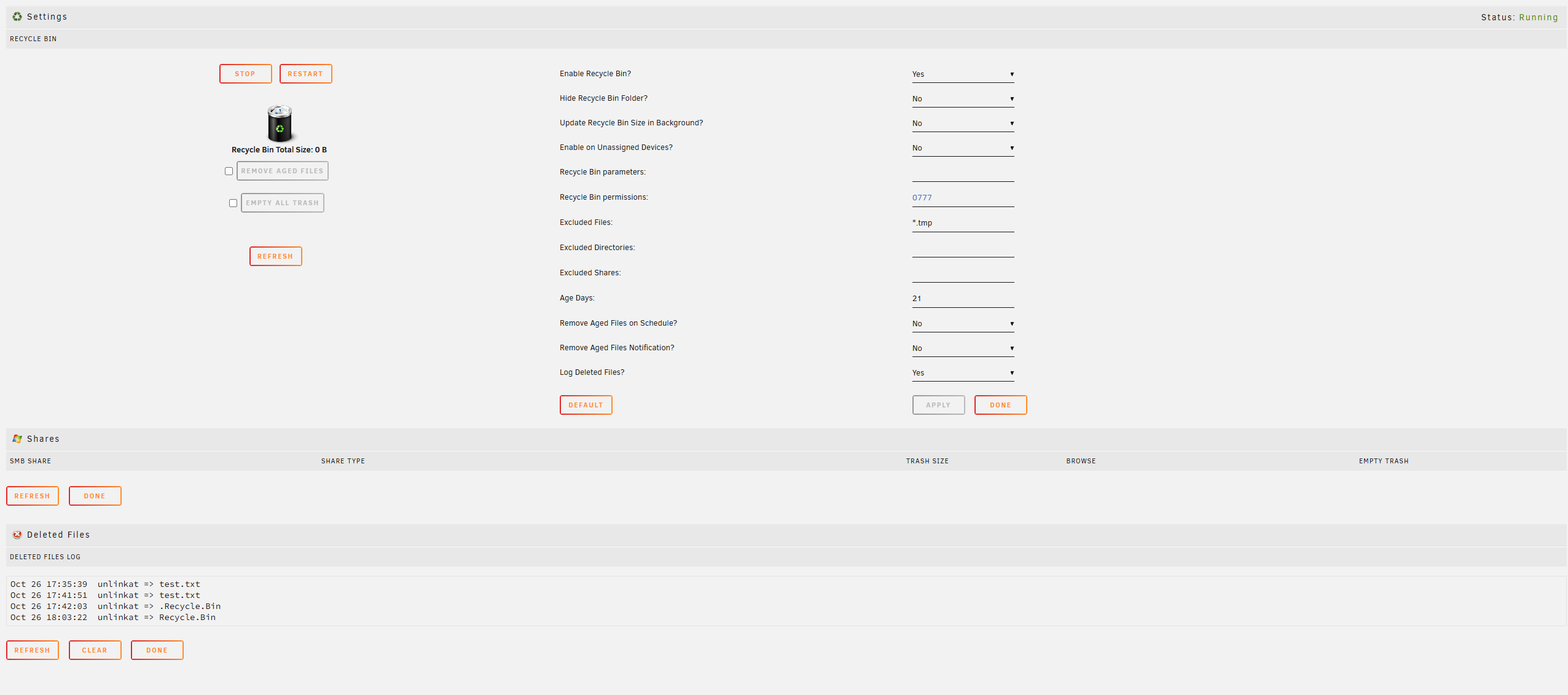

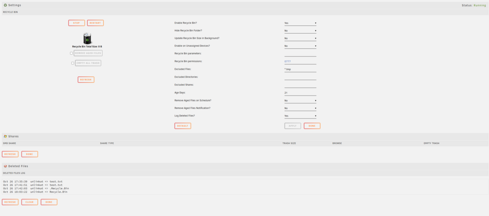

Howdy, not sure why, nothing shows up under 'smb shares' in settings. I can access the server (my 'media' share) from Windows Explorer, am I missing something? Thanks let me know if I should post screenshot of settings page(s).
Edited by YaSo
pics
It's working for me.  When you are testing, be sure to create a file that is not zero length.  Any file that is zero length will be ignored and not put in the Recycle Bin.
Post diagnostics.
Yeah, I'm an idiot for not testing it way back when I first set up the server. I thought that my shares would show up in the 'Shares' section of the Recycle Bin settings, like they show up in the normal 'Shares' page.
When I didn't see my shares show up in Recycle Bin after turning it on, I thought I didn't set my shares up properly and could never figure out how to get them to show there, so i turned the Recycle Bin off.
If I had tested it I would have seen that the 'Shares' section of Recycle Bin settings only populates AFTER you have deleted something, not just when you turn the feature on.
