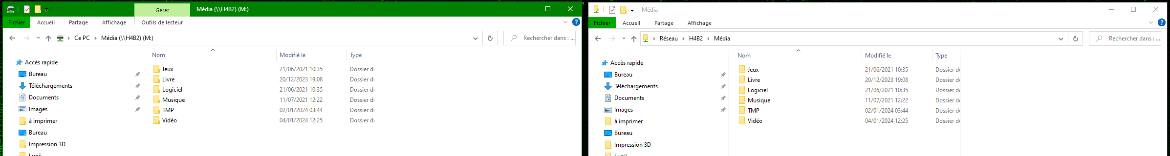

Just deleted a folder by accident (one that is not on my backup NAS because not important enough to increase the disk size on the second NAS) .
Just checked my .recycle bin to discover it's empty.
Can you tell me it only works on windows  if you deleted the folder  in the left folder with the "map network drive" with a letter but not if you  deleted it on the right screen with "add a network location".
Thanks in advance
It works in either situation.
