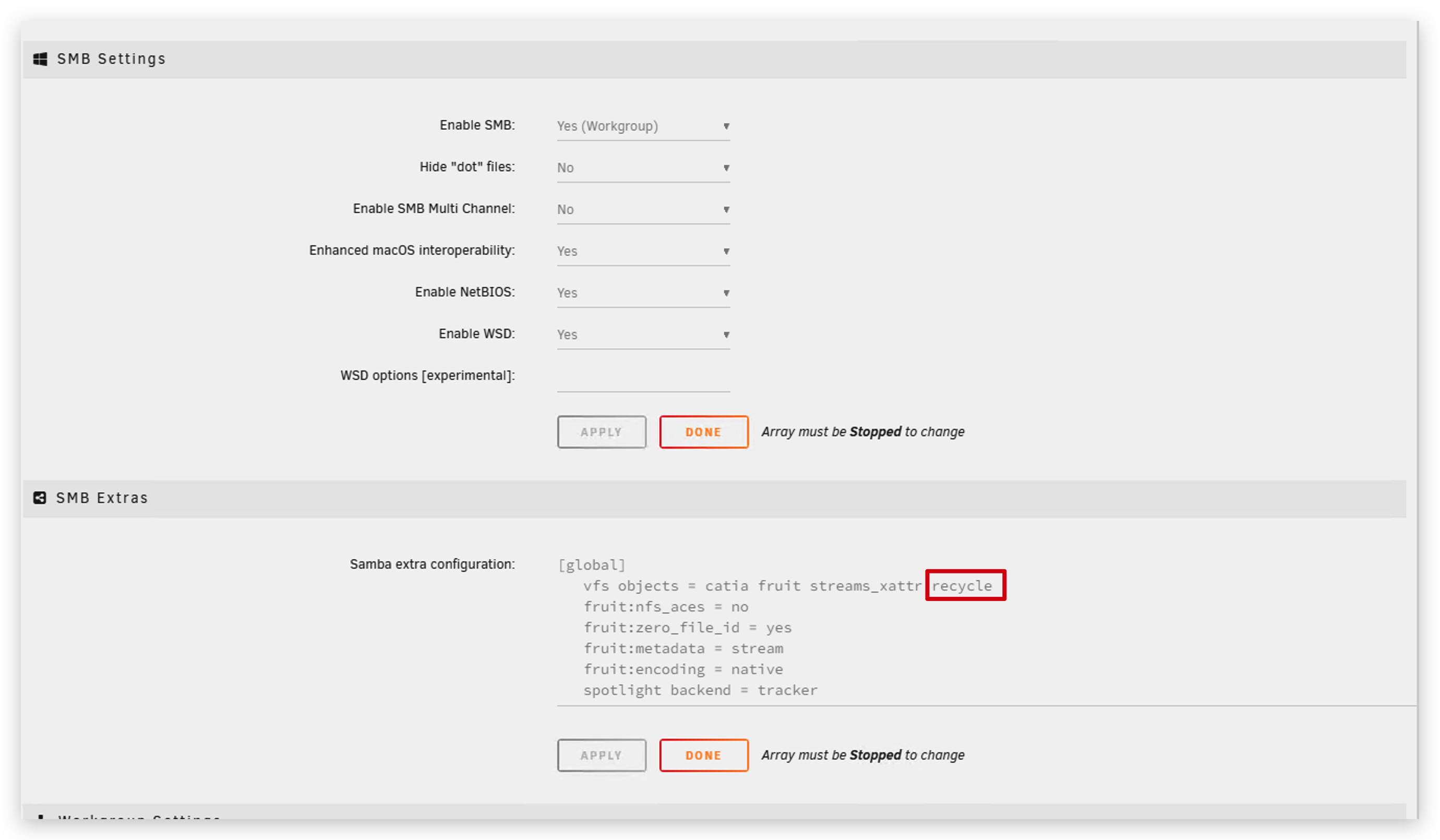

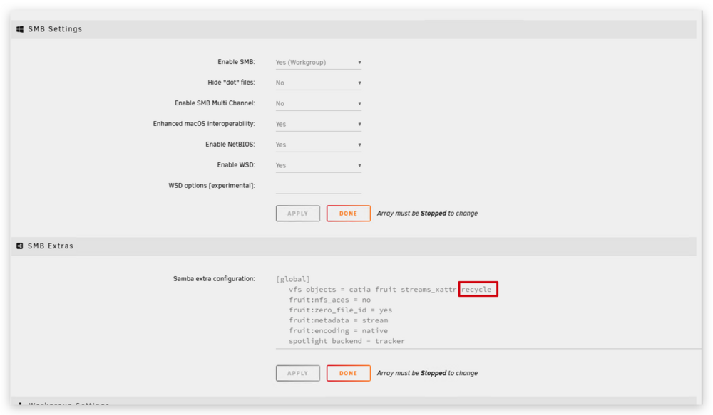

Just in case any doesn't know, after I installed the plugin, the ".Recycle.Bin" folder didn't appear automatically. After digging a lot, I found steps below:
1. Go to Settings -> SMB Settings
2. In the middle, SMB Extras append "recycle" to "vfs objects"
3. Restart the Recycle Bin plugin
4. Done
