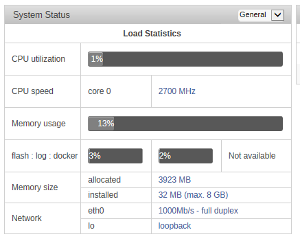

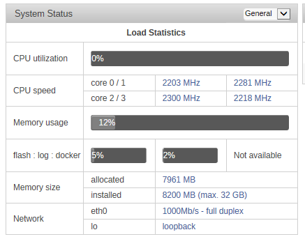

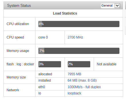

September 8, 201511 yr Author OK, I didn't check the BIOS for RAM, but I did pull out a stick of RAM (it has 2 of 4GB sticks installed) and I got a result showing 32MB installed. Attached are 3 screen shots, Tower2 with a single 4GB stick, Tower2 with 2 of 4GB sticks in (8GB RAM) and Tower1 with 8GB RAM. Can anyone tell me why Tower2 is only showing 32MB/64MB whilst Tower1 shows 8200MB when in the 8GB case, both servers have 8GB RAM installed? Is unRAID only seeing 64MB? this might explain why cachedirs doesn't seem to work on Tower2?
September 8, 201511 yr I think that is just a bug with your MB, and you'd probably want to talk to limetech and provide logs/sensor info/etc to help narrow it down. See if anyone else using that board is seeing a similar issue? I'm pretty sure that if you only were truly using 64MB of ram, you'd really notice. Is tower2 on 6.1 yet?
September 8, 201511 yr I think that is just a bug with your MB, and you'd probably want to talk to limetech and provide logs/sensor info/etc to help narrow it down. See if anyone else using that board is seeing a similar issue? I'm pretty sure that if you only were truly using 64MB of ram, you'd really notice. Is tower2 on 6.1 yet? Probably just a display bug as right above it "Allocated: 7955MB" indicates 8GB of RAM.
September 8, 201511 yr Author Both systems are on 6.1.1 Is there any way I can prove it is seeing/using all 8GB?
September 8, 201511 yr Both systems are on 6.1.1 Is there any way I can prove it is seeing/using all 8GB? Remote in with putty/etc. log in, and type top, it'll show you how much you have, how much is allocated/etc.
