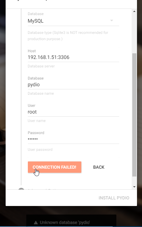

Can someone help me out with how to create a database in MariaDB for pydio? I am struggling.
Jeffrey, try adding :3306 onto the end of your IP address.  Make sure you've created a database called pydio (or whatever) and don't use mysqli
Edited by ice pube
12 minutes ago, CHBMB said:
Try following the instructions for Nextcloud on our website, should work.
I tried that, but when I enter in the MariaDB info into the Pydio wizard, it says "unknown database 'pydio;"
I just set up a test nextcloud container and it worked fine. Which database option do I use in the pydio wizard?
1 minute ago, CHBMB said:
Dunno.  Post me a screenshot of the setup screen or something.
Attached.
