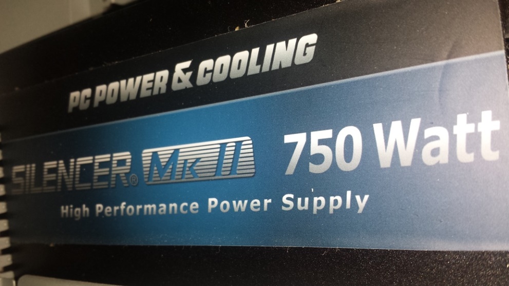

September 12, 201511 yr Since you may still have some unresolved hardware issues, your PSU might be something to consider. What is the exact model of your current power supply?
