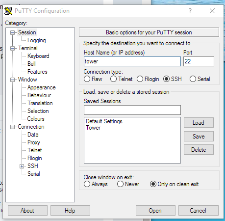

I used to be able to SSH into Unraid using putty as well as use WinSCP to access my Unraid drives. Unfortunately, this is no longer possible. Telnet still works, but no SHH (and no WinSCP).
Error message when SSH via Putty reads "Network error: connection refused" and in WinSCP reads "The server rejected SFTP connection, but it listens for FTP connections. Did you want to use FTP protocol instead of SFTP? Prefer using encryption.".

works for me. based on error message it sounds like you have wrong port or protocol selected.
Thanks for sharing. I don't think it is related to ports or protocols. It actually does work with Telnet (23), but not with SSH (22). It used to work in the past, but things went bad, when they were some issues around the update. I don't think it is the update per se as otherwise more people would face similar issues. But something must have corrupted along the way...

Never had this problem - Putty is working well with v6.1.2
Using SSH2 with Port 22 - all ok  ;)
Putty-Version: 0.63
