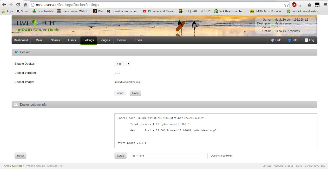

Also, you should post a screen shot of the setting's for docker (in particular the section in the middle that shows the free space)

By "settings for docker" do you mean this attached?
It's not full, but is at 11GB with only 4 apps installed in Docker.  Should 4 apps (plex, Sab, Couchpotatoe and Sickbeard) take up 11GB?
